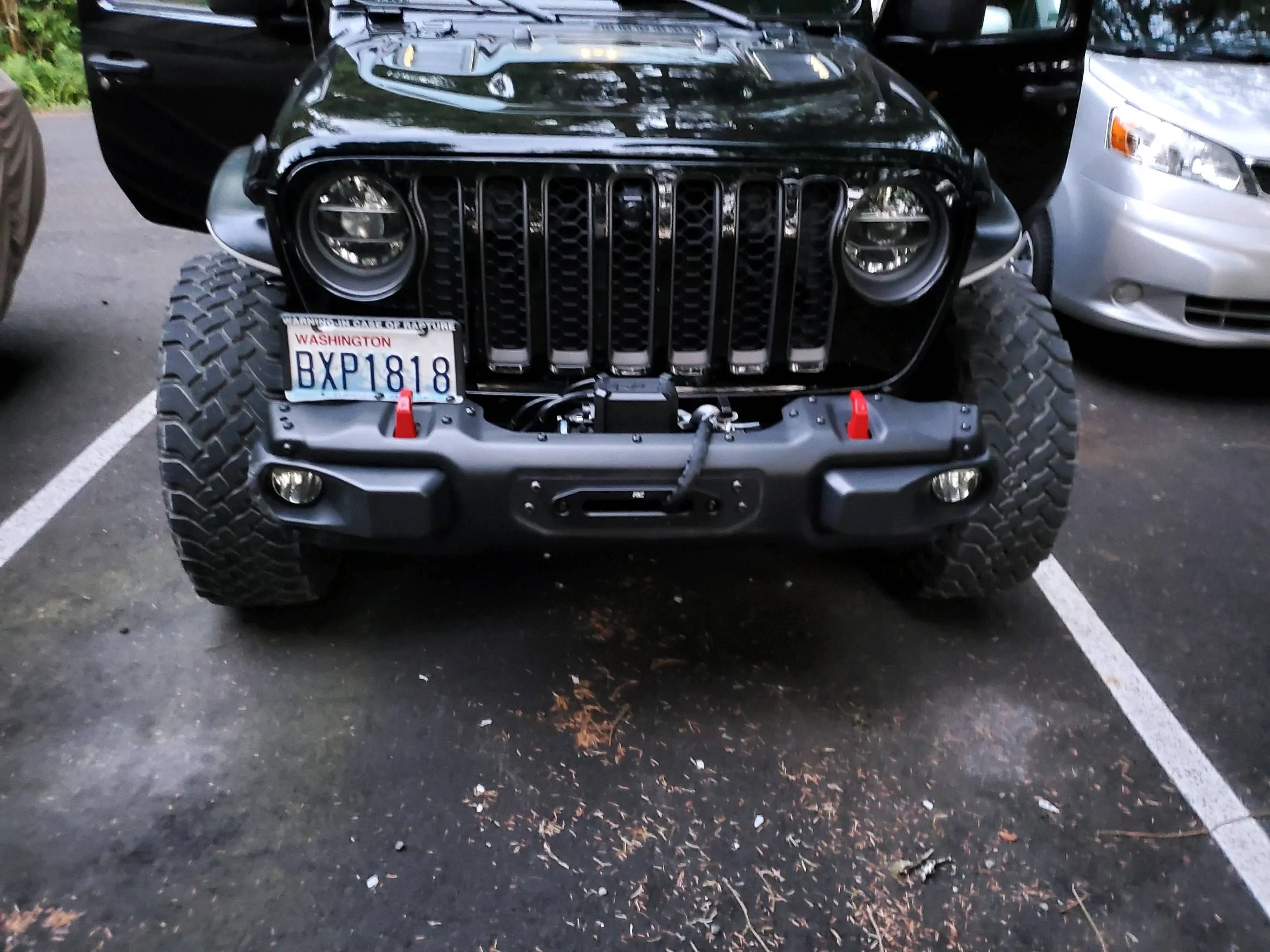

Well 9/27/23 Got the 21 Rebicon back. Long story short. A little miscommunication at the dealership led to the new transmission being ordered a week late.
Now my dealership Karmart Dodge/Jeep Sedro Woolley, WA did me a real solid.
Carlos is the new service manager and His boss Caleb I've been working with for almost 12 years and multiple vehicles purchased/serviced.
I had purchased a BodyArmor bumper/tire carrier combo and had planned on installing it myself after we returned from Moab. We'll you already know the story of the missed/delayed till next year Moab trip.
They installed it for me. So now I'm deciding how I'm going to hook up all my lights and stuff. It was real nice to have the heavy work already done. I had to cut some of the 21 rear camera bracket to modify the one that came with the tire carrier. It was designed to accept the previous generation of back up cameras.
