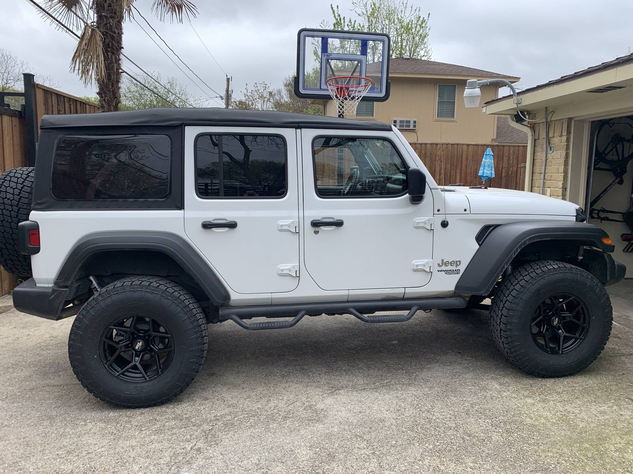

Hey all - I have an 18 JLU Sport S with 35” tires and the 2” Mopar lift. I have 30k miles and started experiencing issues where I experience the JLU trying to downshift after I’m done accelerating from stop, but it’s a strong jerk when it does. I’m not sure if it’s a sign I need a re-gear and my 35s have been taxing the jeep, or something else. Also, when I start rolling to a stop I can hear something click underneath. You can tell I’m not a whiz with this stuff, so any help appreciated! Anyone have any ideas?
