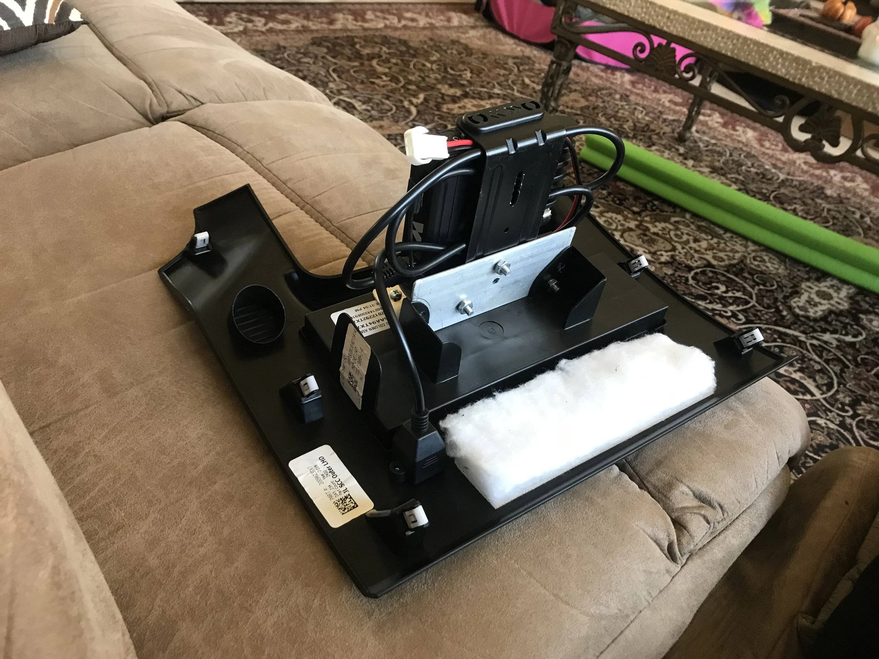

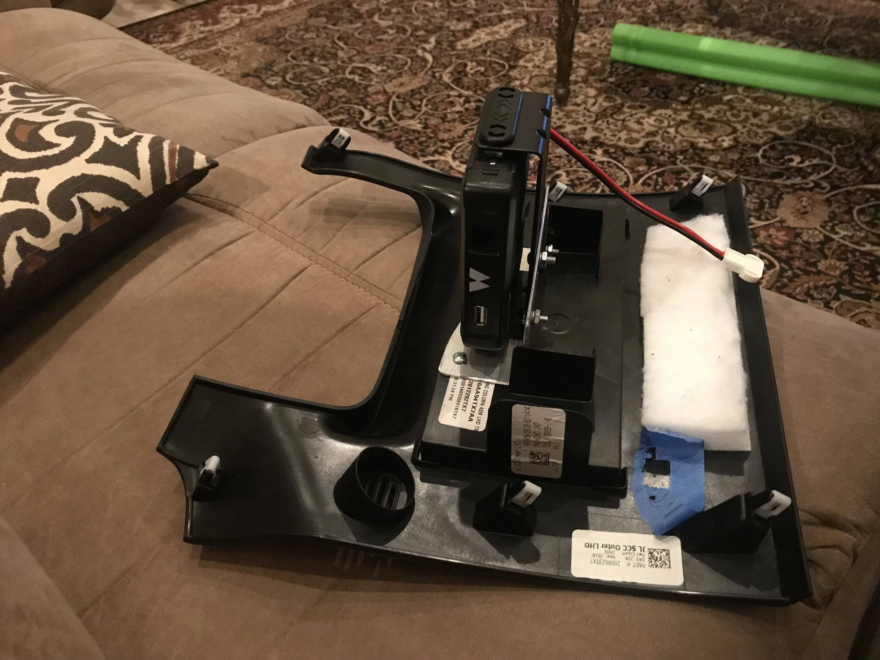

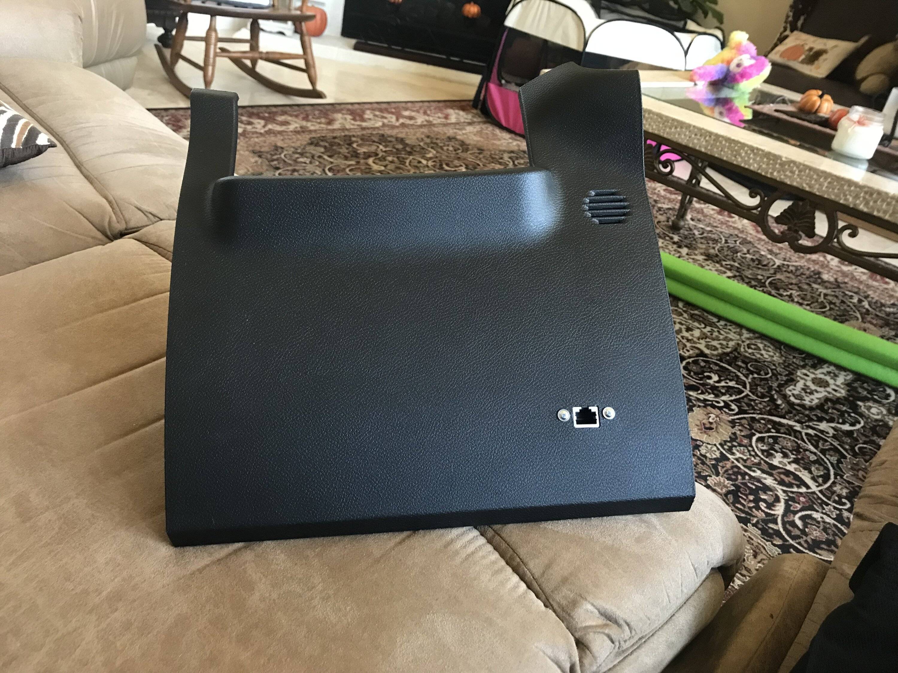

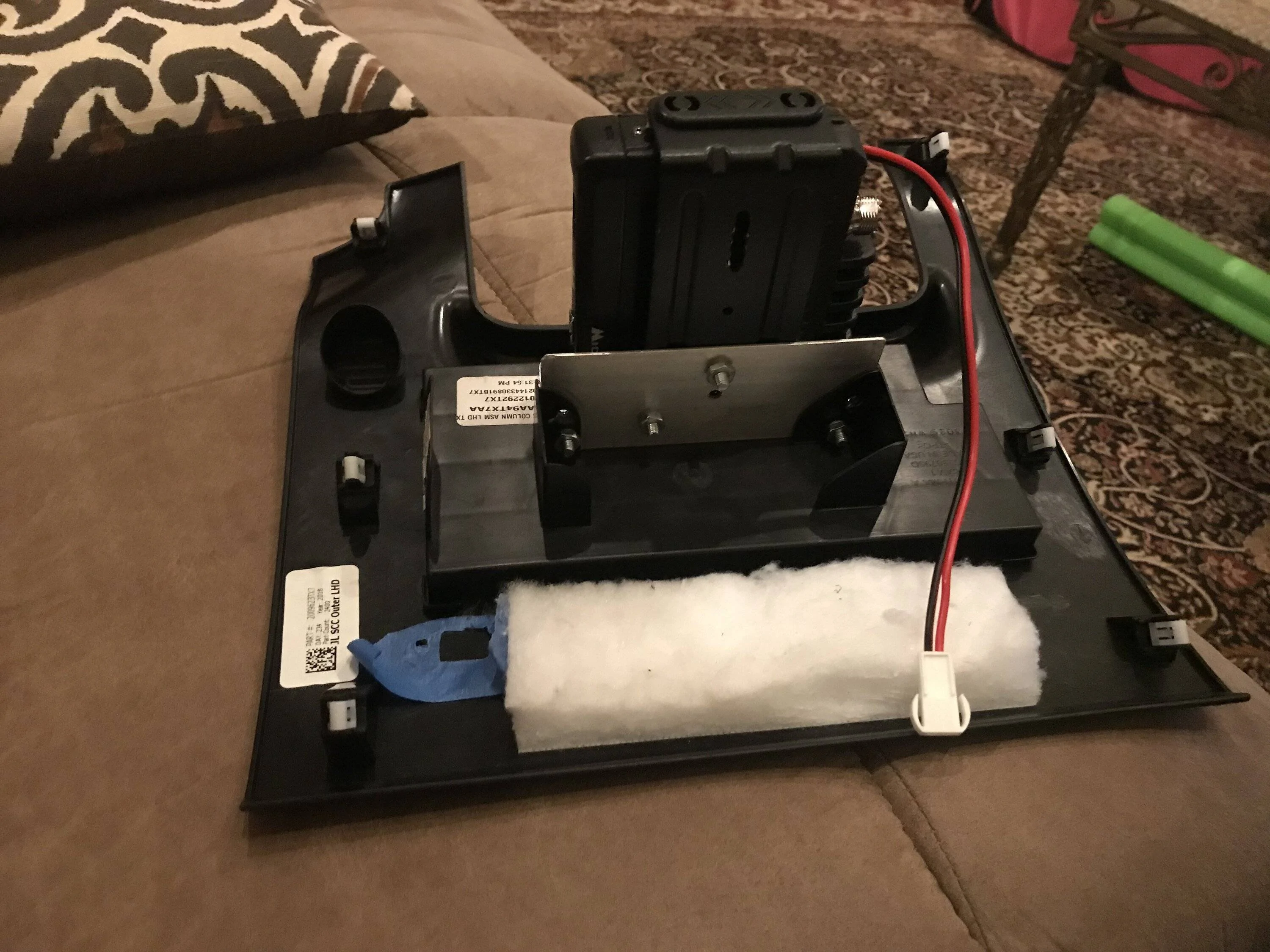

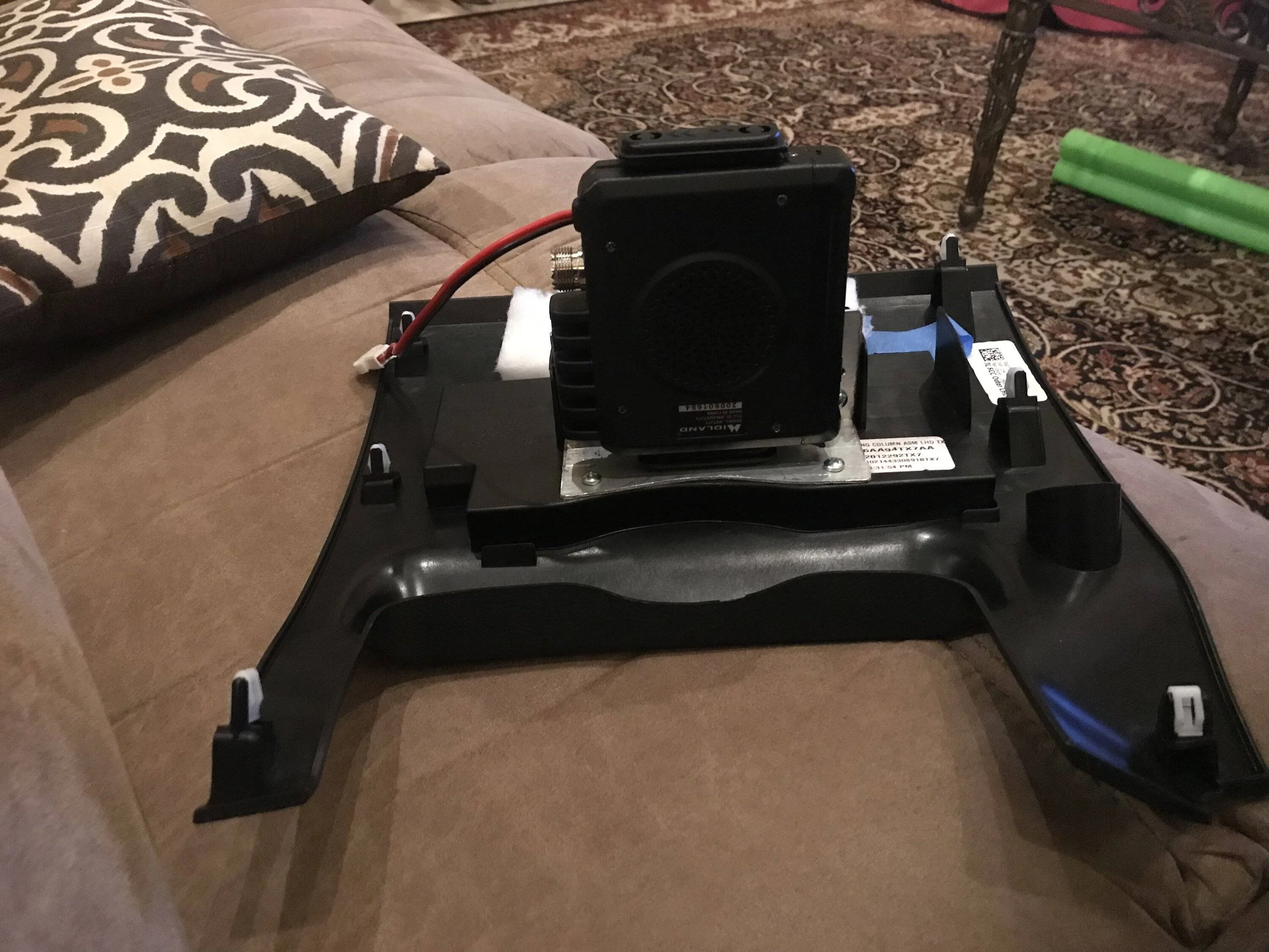

I know some models have an ideal mounting location under the steering wheel for a radio. If you pull off the lower cover around the wheel, you will see it.

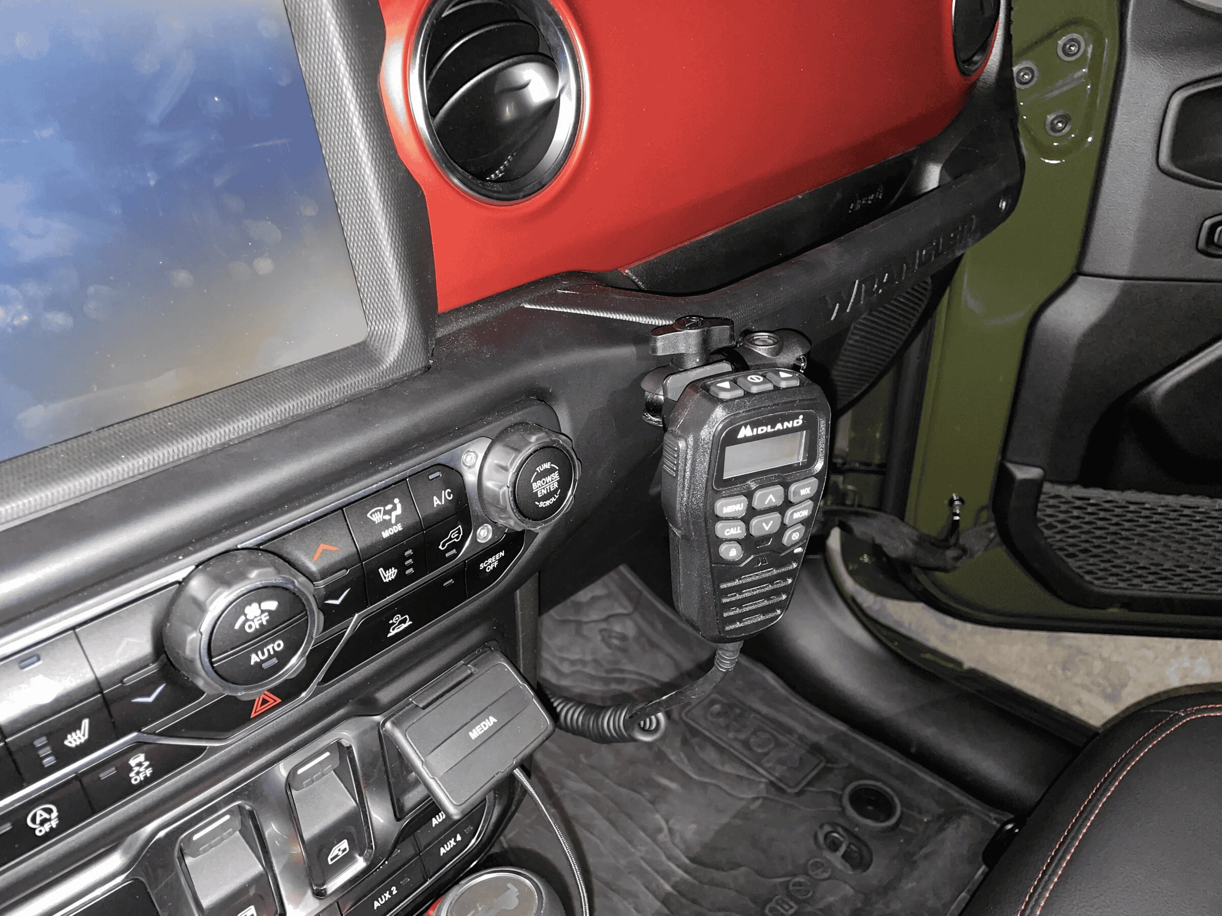

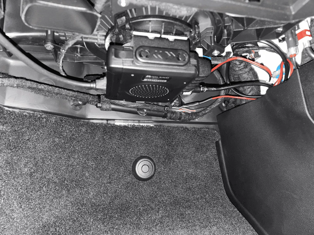

I used velcro and mounted mine in the passenger footwell to keep it out of the way and easily access the factory AUX switch wiring. I did velcro so I could remove it quickly, but have not once had the need to because when I remove my mic, nobody even knows it's there. Also, there's enough slack for me to bring the mic all the way to my mouth, but not too much that the cable hangs down and bothers passengers.
Sorry the pic is a bit blurry. It was hard to get the camera to focus in the dark.
Jeep Wrangler JL GMRS antenna mounting 1659573253111
Jeep Wrangler JL GMRS antenna mounting 1659573389897

Looks good. I ended up installing mine behind the panel under the steering wheel. This Velcro works great for attaching it: https://a.co/d/aBiKs8M

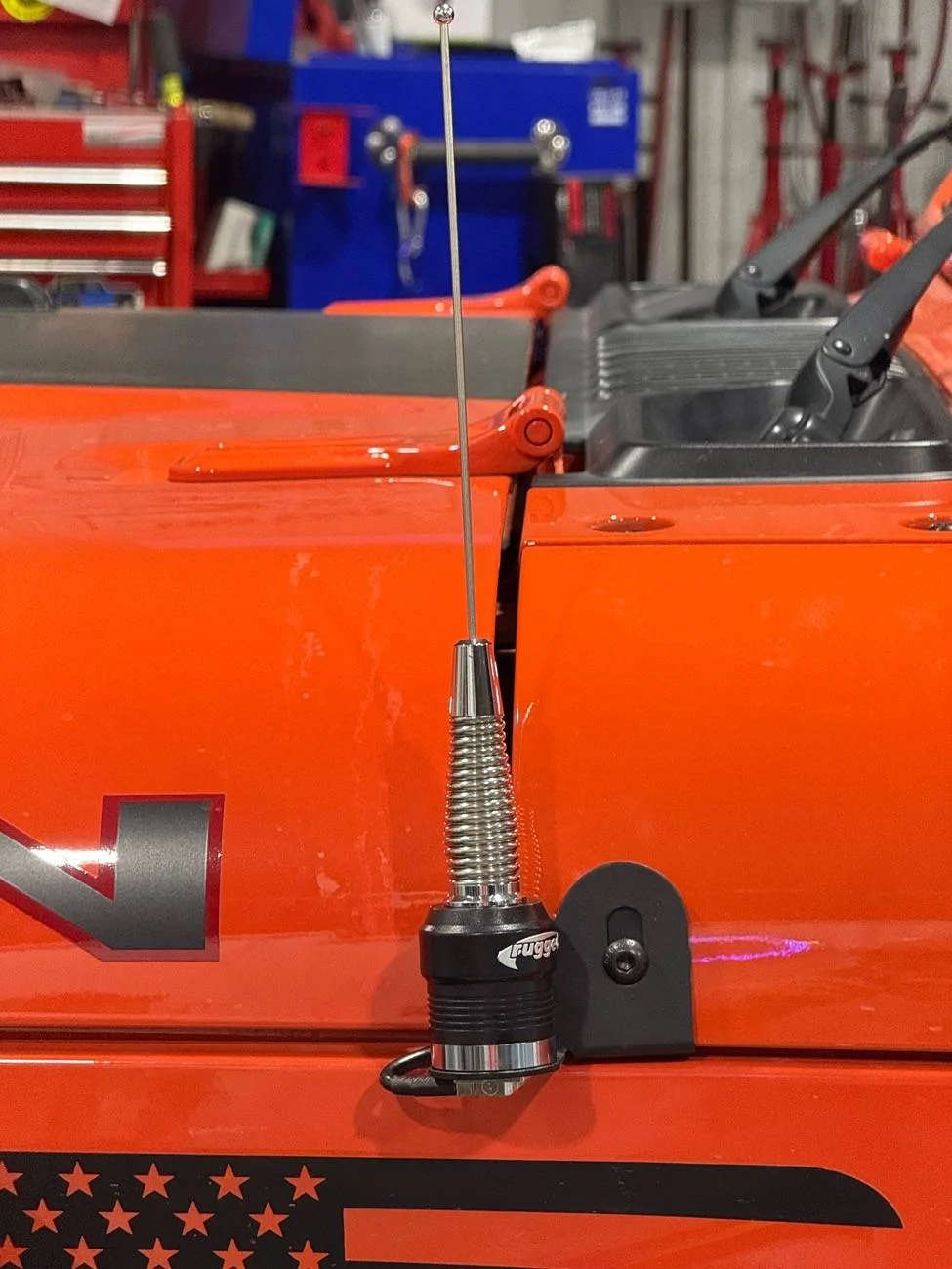

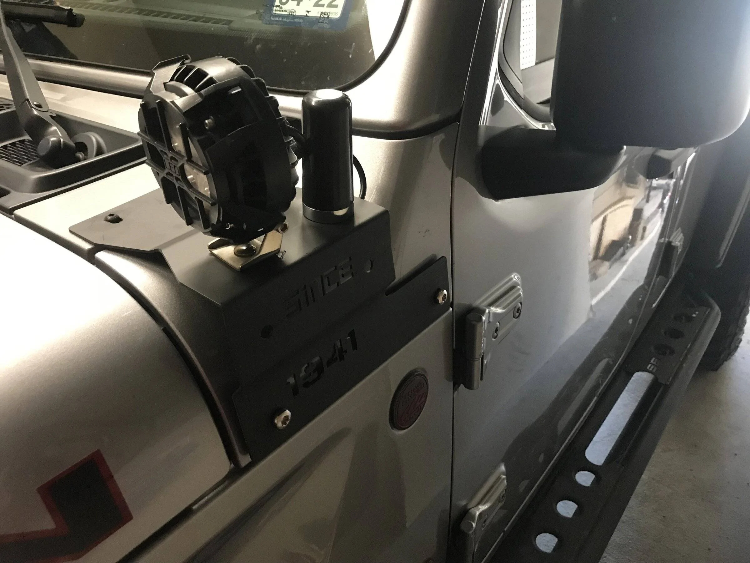

I put mine on the cowl mount. Blends in well. I got a short antenna wire just for this.
That is one of the worst places to put that 3db gain Ghost antenna. 1st of all there is little line of sight so your transmit range will be lower than normal. Jeep and lights block signl an lights will interfere with the antenn signal. This type of antenna is best mounted high on vehicle as in roof rack mount.

MicroMobile MXTA25 3dB Gain Ghost Antenna

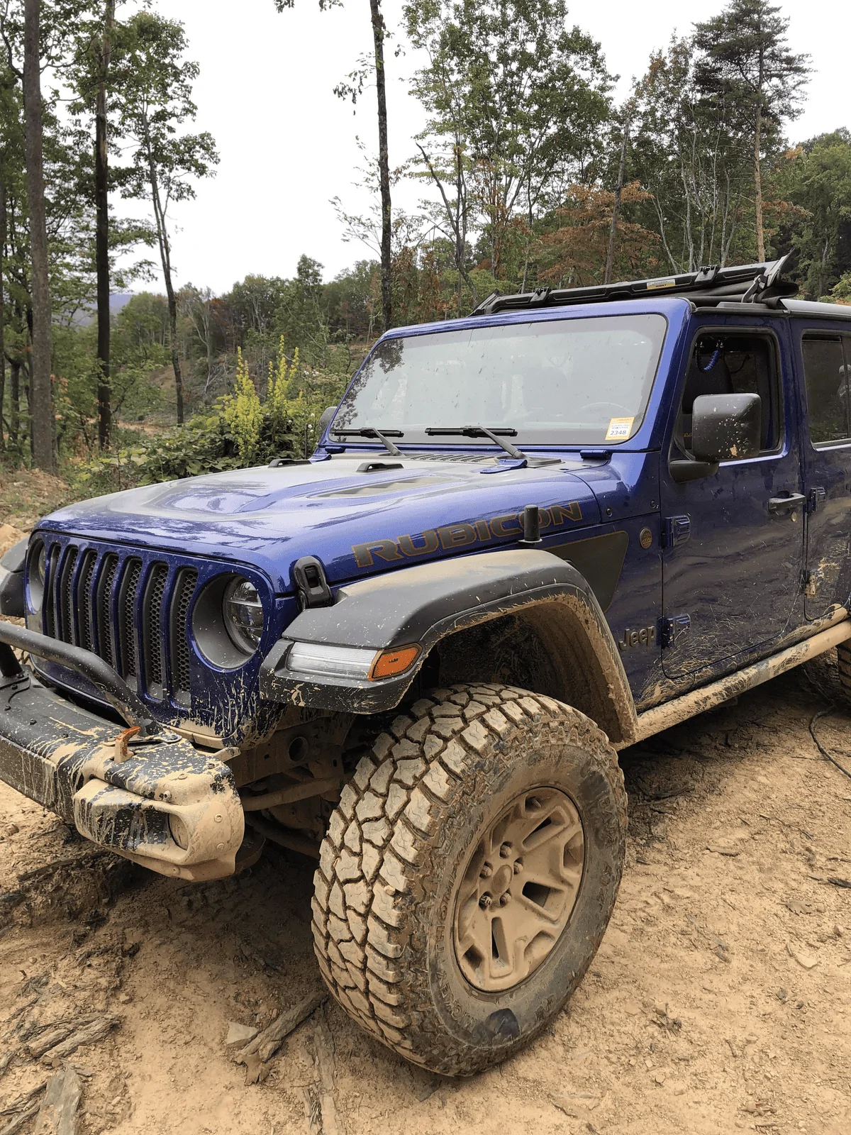

You can catch a glimpse of it here above the fender.
This is a bad location for this type of antenna. Your signal is being blocked by the Jeep to the right side, best on the left side. Might work OK in a small group but your 15 or 50 wall radio is being wasted by the wrong antenna in the wrong locagtion. Where as you might have reached out 15 miles or more, you are probably limited to 2 miles max
I’m not looking for max range, but it works way better than the hand heads. Almost too good, I’m hearing a lot of chatter that the handhelds don’t pick up.
Hey Mike
What's your opinion on mounting it to the rear part of the rollbar? Would that work OK for the Ghost antenna?

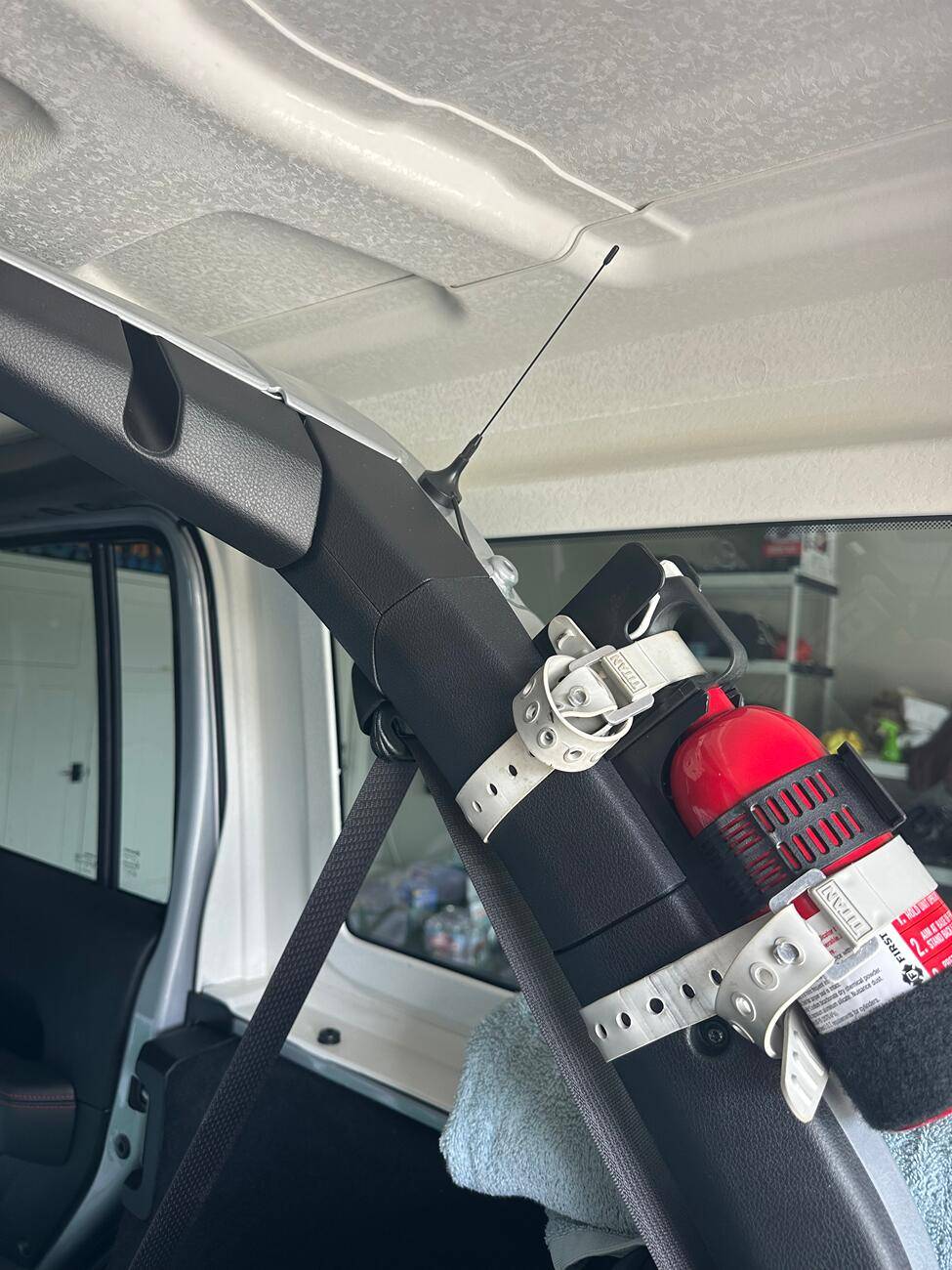

Hey Mike
can't see why not. this is how we all do it with little 105mxt 5 watt radios and they work great.
Jeep Wrangler JL GMRS antenna mounting tempImageCy4C63

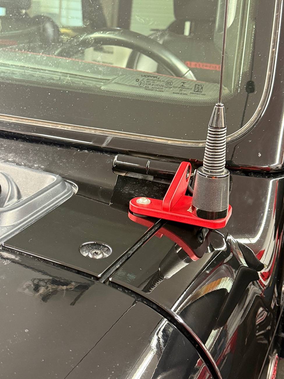

Jeep Wrangler JL GMRS antenna mounting IMG_2989
this is where Rugged Radio wanted mine mounted, so i followed their instructions
