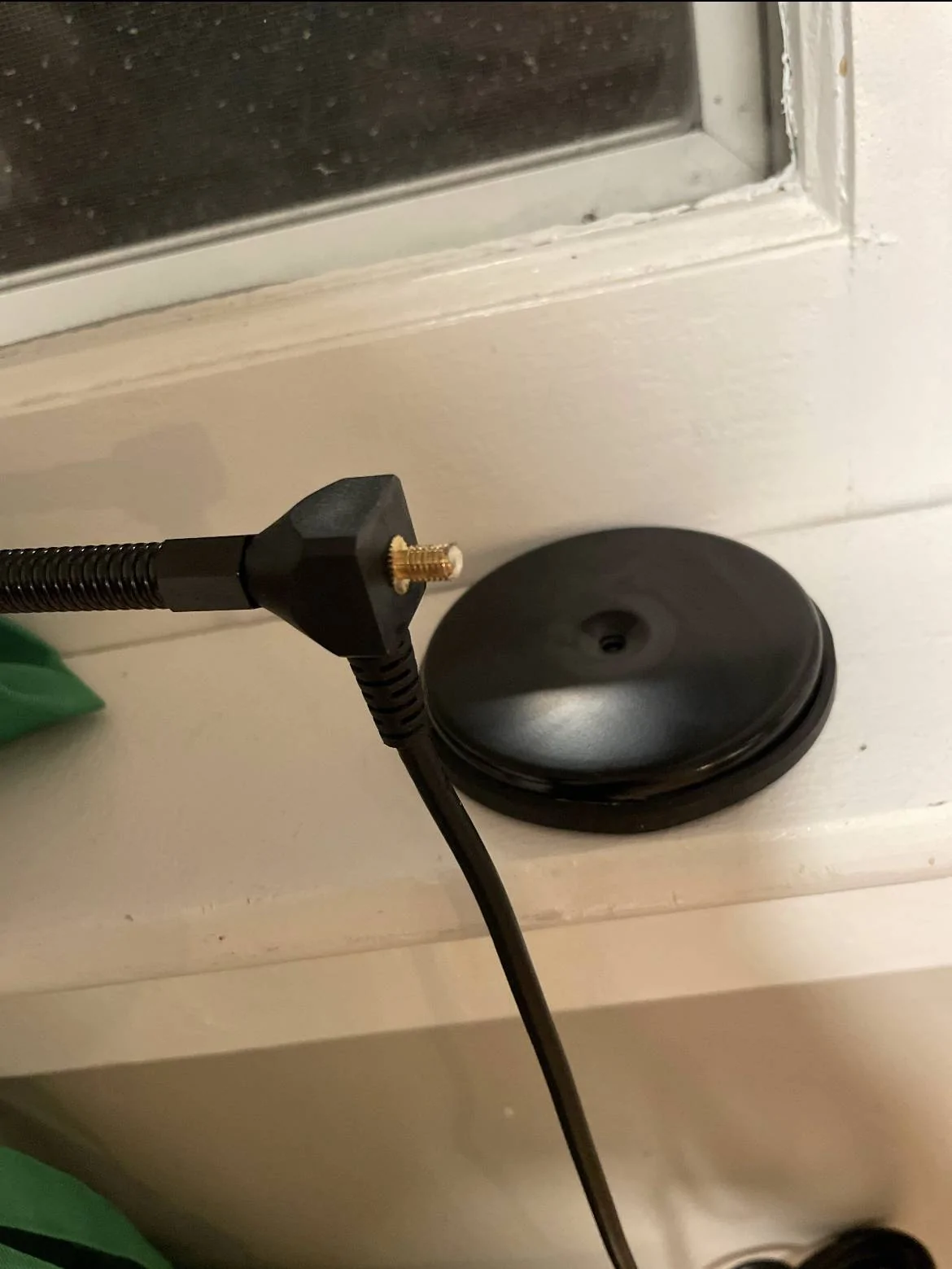

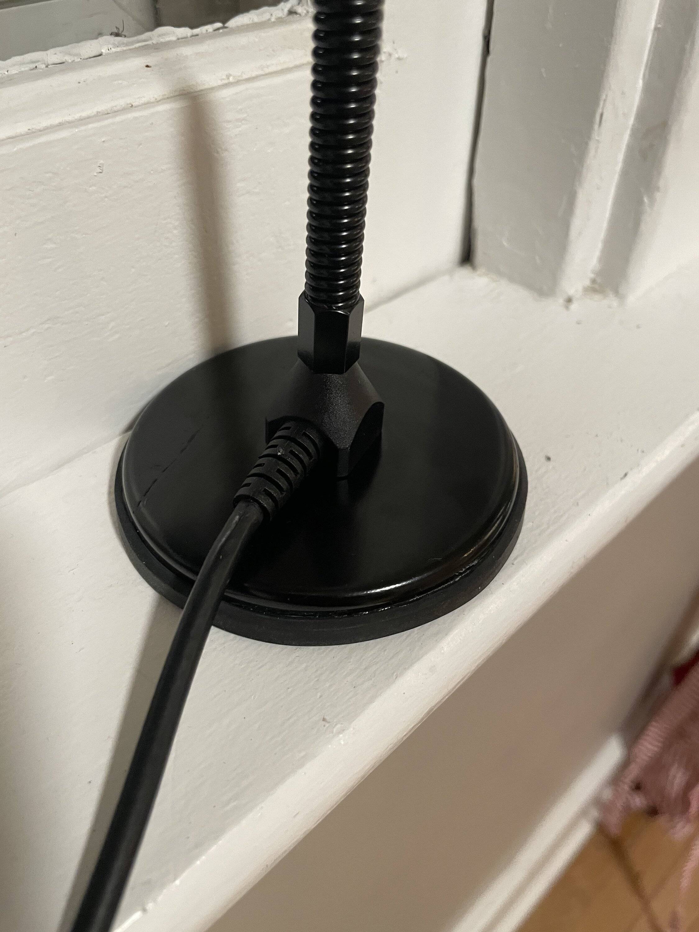

The radio came with the Nagoya UT-72G with a mag mount (mostly useless ) its does unscrew and was thinking about fashioning some sort of bracket for the rear tailgate for it to attach to.
Any thoughts or suggestions

Do you know the thread size and length? I might have an idea.

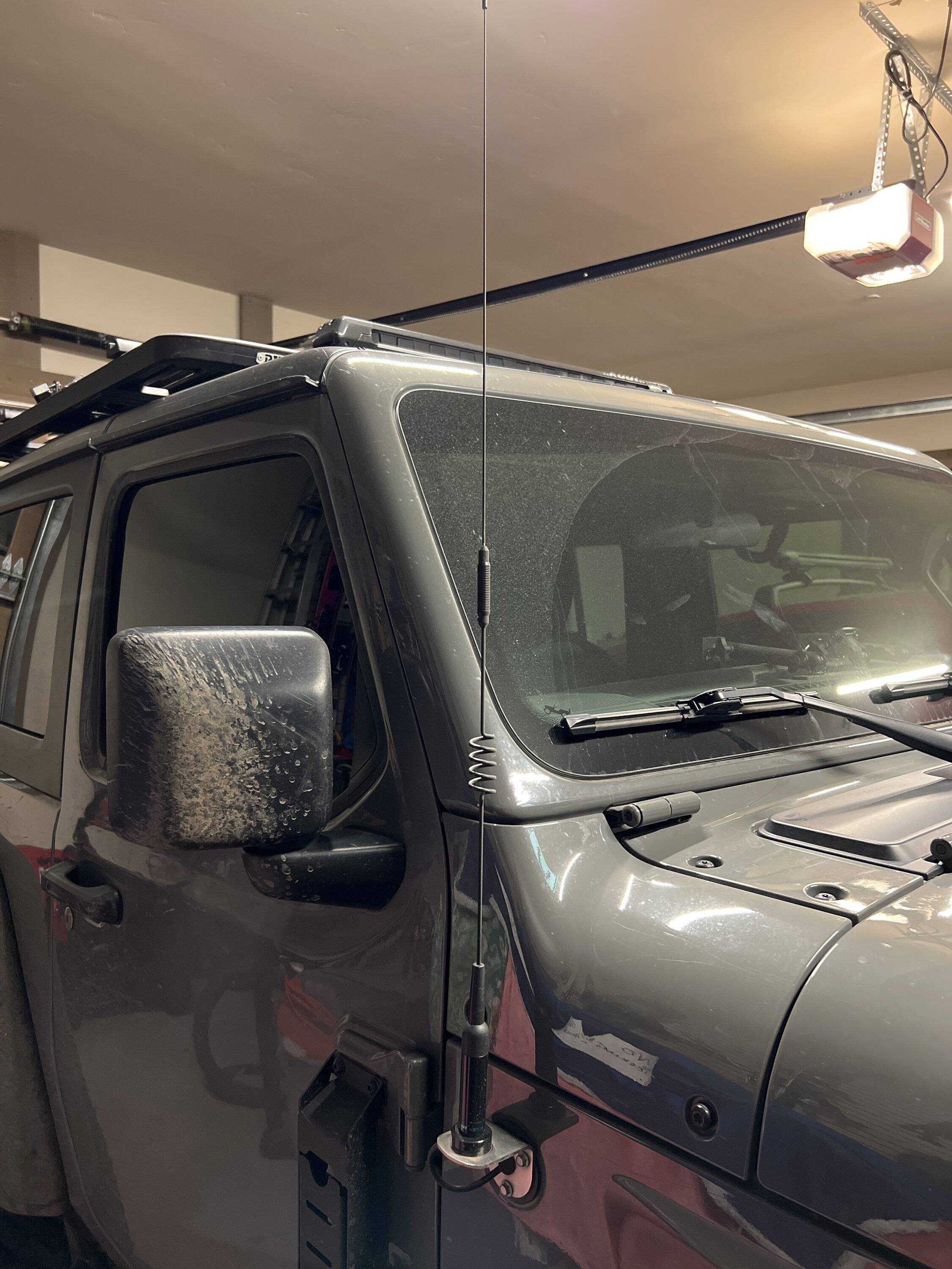

Here is my CoolTech mount near the factory FM antenna if it suits your liking. IMO it blends in pretty well even with a high gain 2M/70CM antenna.

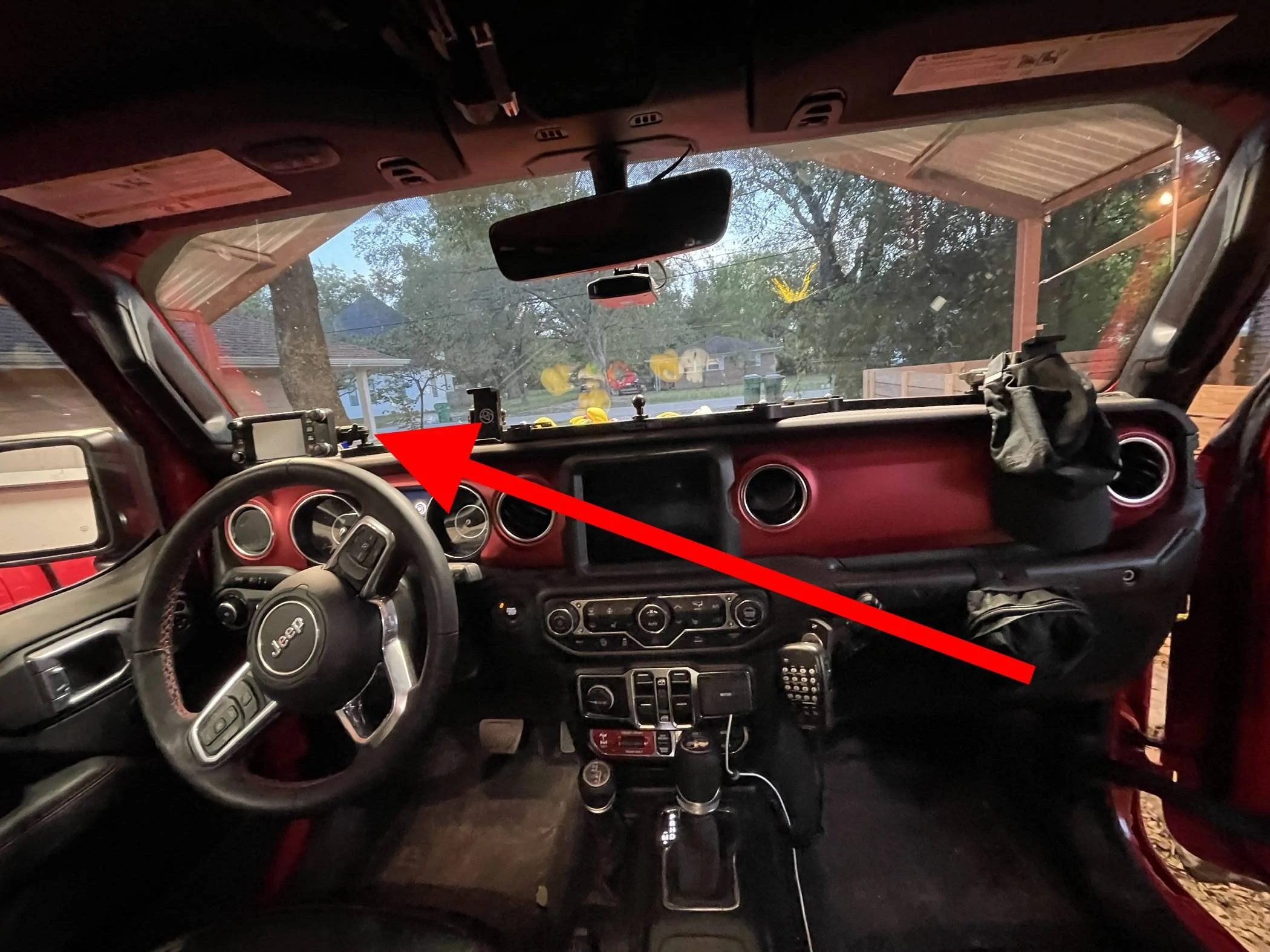

Different radio obviously, but here is my faceplate mounted on a 67 designs mount attached to the vector off road e-dock.
Also in this picture is the CMM grab bar ball, attached to a 67 designs arm and mag mount for the mic
