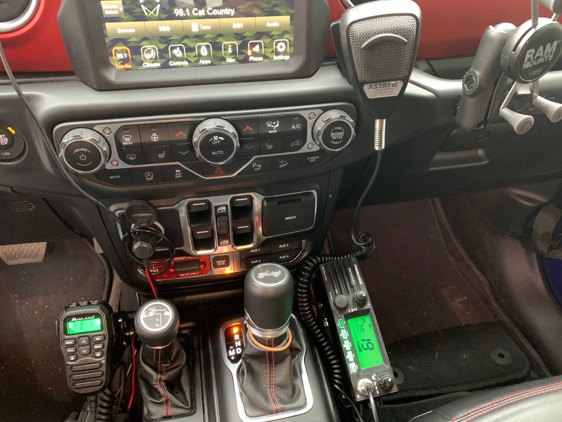

CoolTech GMRS mount up front and CoolTech 4’ Firestick mount out back. Magnetic Mic mounts for both mics, CMMG mount for MXT275, Quadratec quick release mount for the CB/SSB.

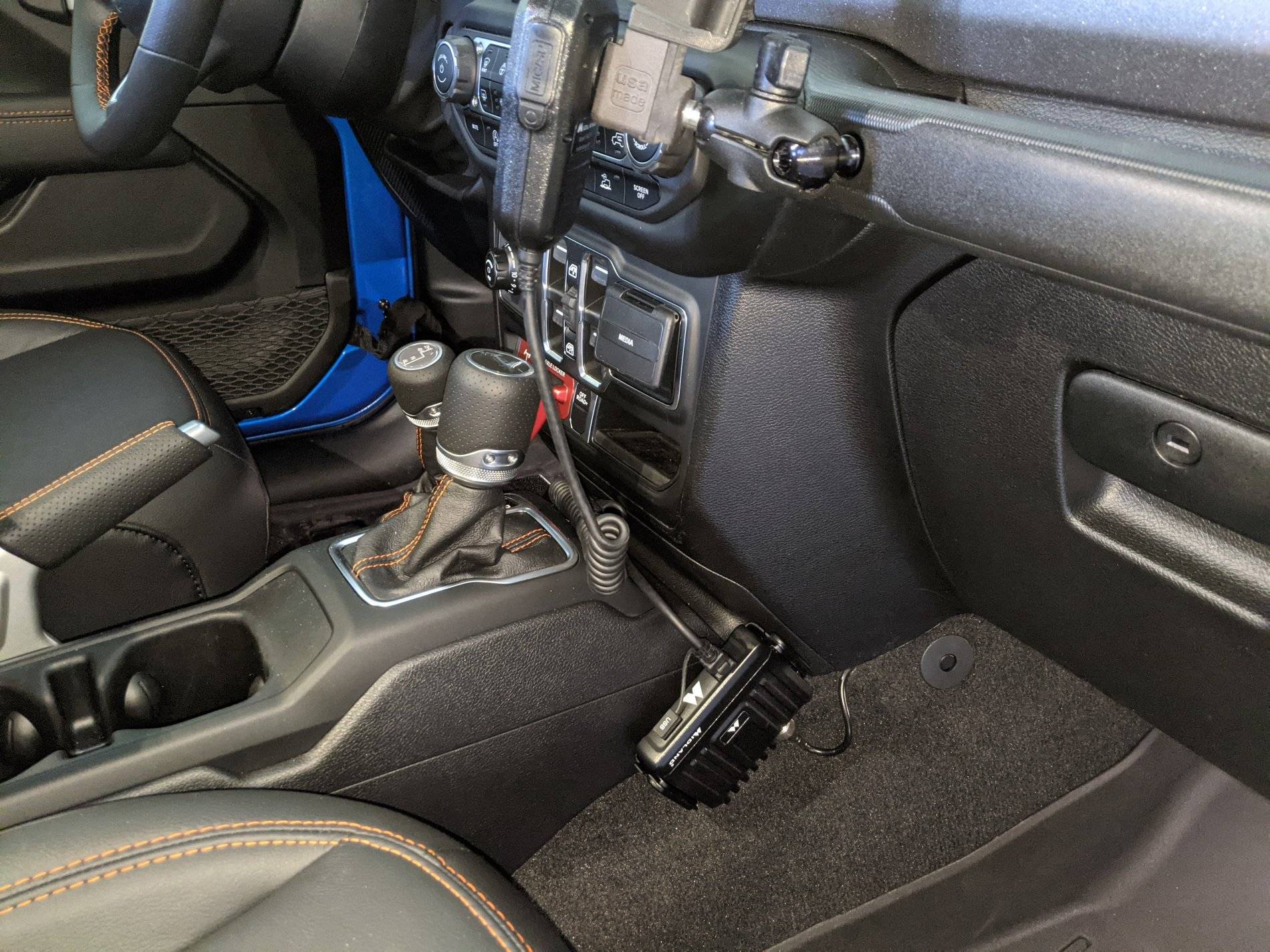

Routed cable through the wiper motor cowl inside of some drip sprinkler pipe., through the clutch plug and behind the center stack.

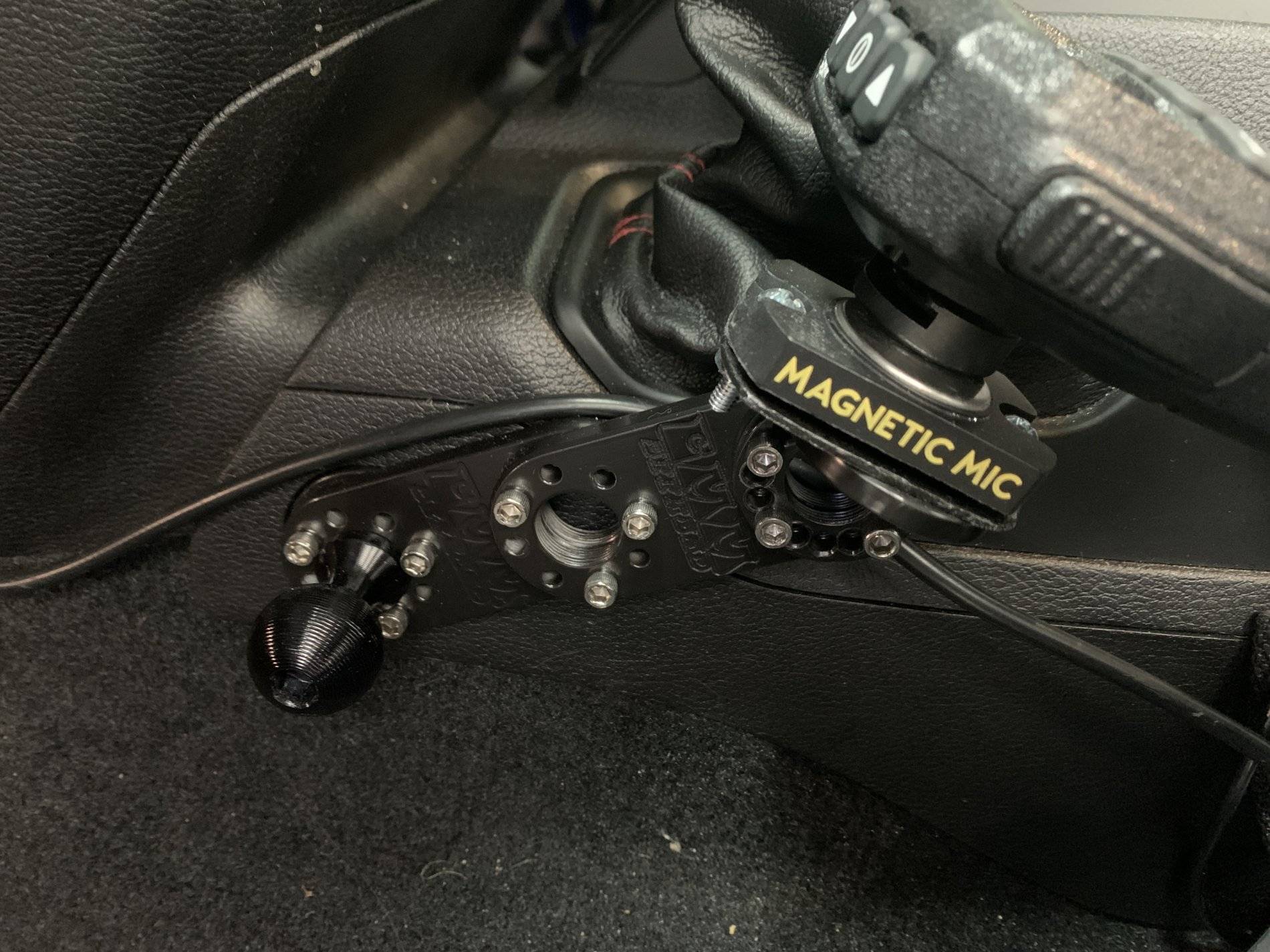

Super cool. Could you possibly post a pic that shows the CMMG mount in more detail?

I actually used two CMMG mounts stacked together to get the mic where I wanted it. I had the radio body mounted off the Ram ball for a while but recently put it under the seat. I’m still playing around where I want everything. I may upgrade the radio when Midland releases the upgraded 50 watt and 25 watt versions this year. I want my CB/SSB and GMRS to be quick release so I can stow them when parked with no doors or top. I’ve also talked to CMMG and hopefully they’ll release a 6” or 8” straight bar so there’ll be no need to stack two kits in the future.

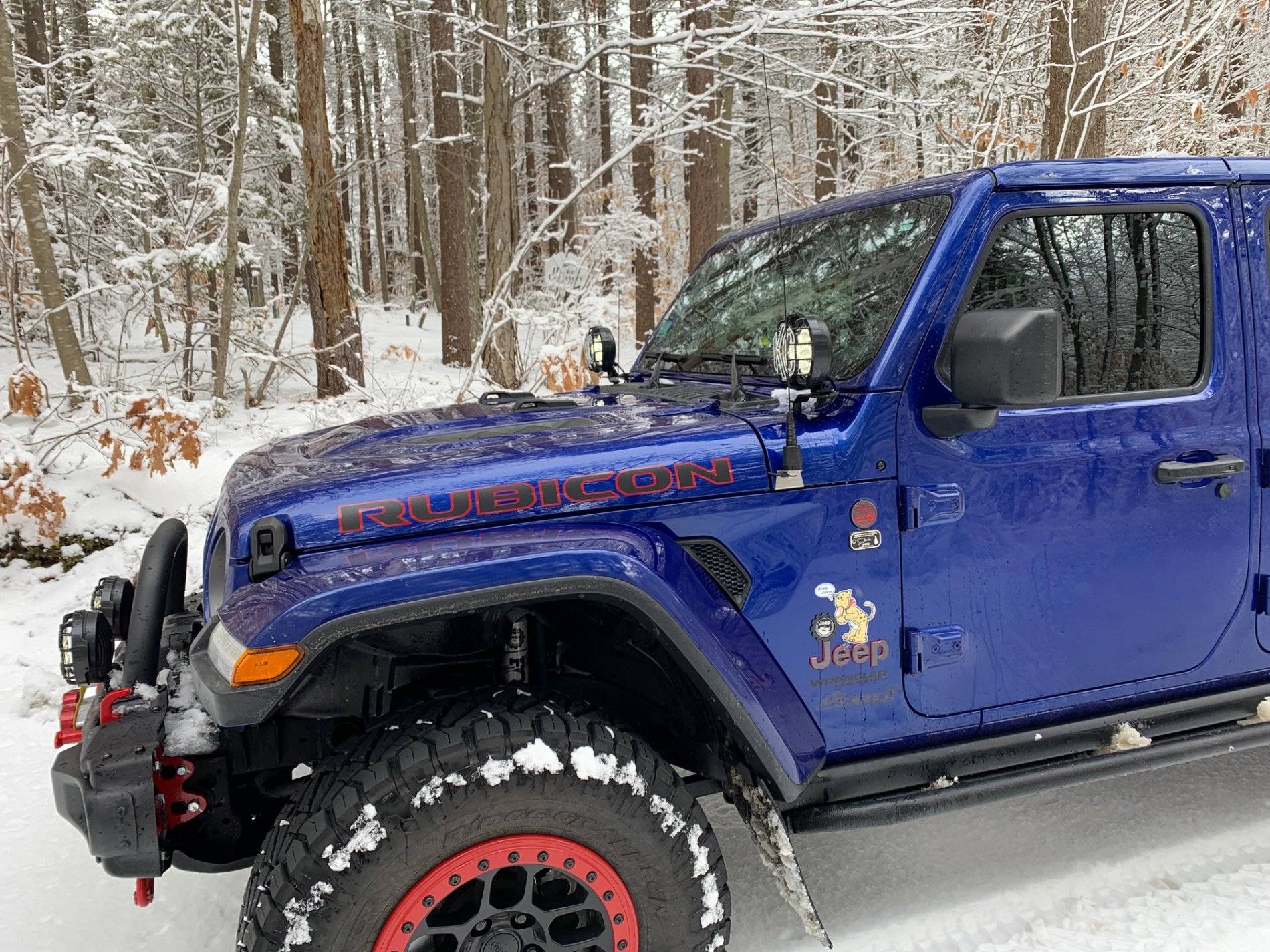

I think the consensus is that the more you can keep a front mount out of your line of sight, the better (aesthetically). Smack in the middle of the hood would be the best for performance (somewhat symmetrical ground plane.) Our front cowl mount lets you choose 1 of 4 places - 2 on each side and none of them will touch/harm the paint if you decide to remove or move it down the road.
Overlanding folks outside of US seems fond of mounting their antenna on the front bush guards/bumpers. I personally think an antenna at the front of the vehicle looks really cool. I guess I am in the minority as I am a ham and was always interested in radios since I was a kid.
I also feel that it is less of an compromise than mounting it near the A pillar. I'm hesitant to mount it there because : 1) too close to the pillar causing bad SWR and blocking the radio waves in that direction. 2) too close to the driver/passenger to transmit at higher power.
Lastly, I think a skinny steel wire (AKA. the antenna) mounted on a bracket attached to a passenger side hood latch would only be minimally distracting.

I really like the Topsy NMO mount. I use it for CB and GMRS and just switch the antenna plug for what radio I'm using. I have a browning BR-140-B for CB and Midland MXTA26 for GMRS antennas. I just use a Baofeng radio for Ham, but friend of mine has a UHF radio wired into his jeep and uses the NMO mount for Ham, GMRS and CB. This mount works pretty well for using the hood as a ground plane; not as good as if you drilled a hole in the middle of the hood to mount an antenna, but is clean and looks good. Plus with the antenna right there you can easily see any potential impacts that could hurt it. All my antennas are flexible enough that there isn't an issue with tree branches bending an antenna to a damage point.

You've mounted it further out to the front and I think that's better. Although I'd like to go further towards the front.
If you don't have a Rubicon or their high mount fenders you can mount it over the front fender
