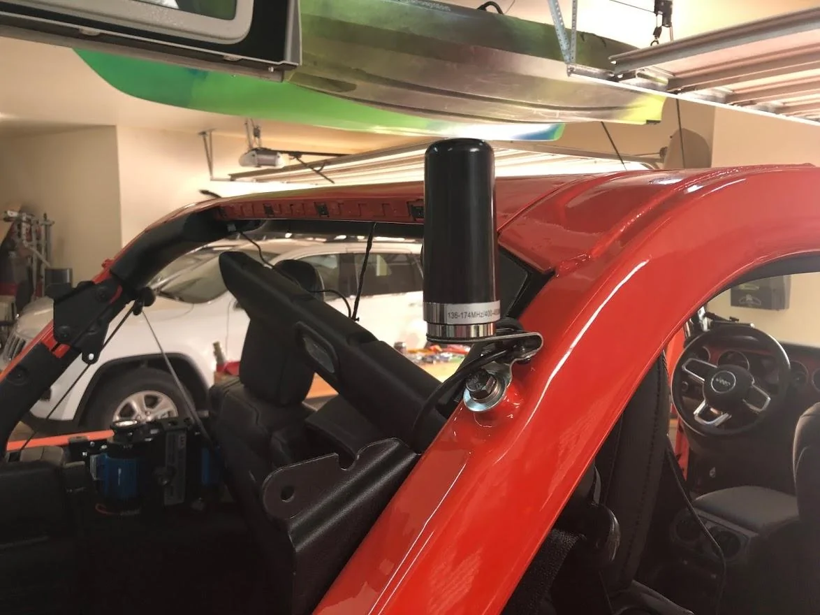

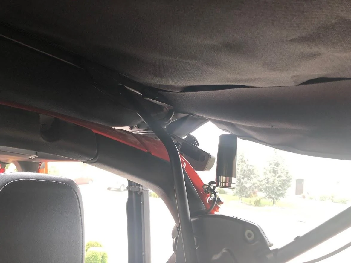

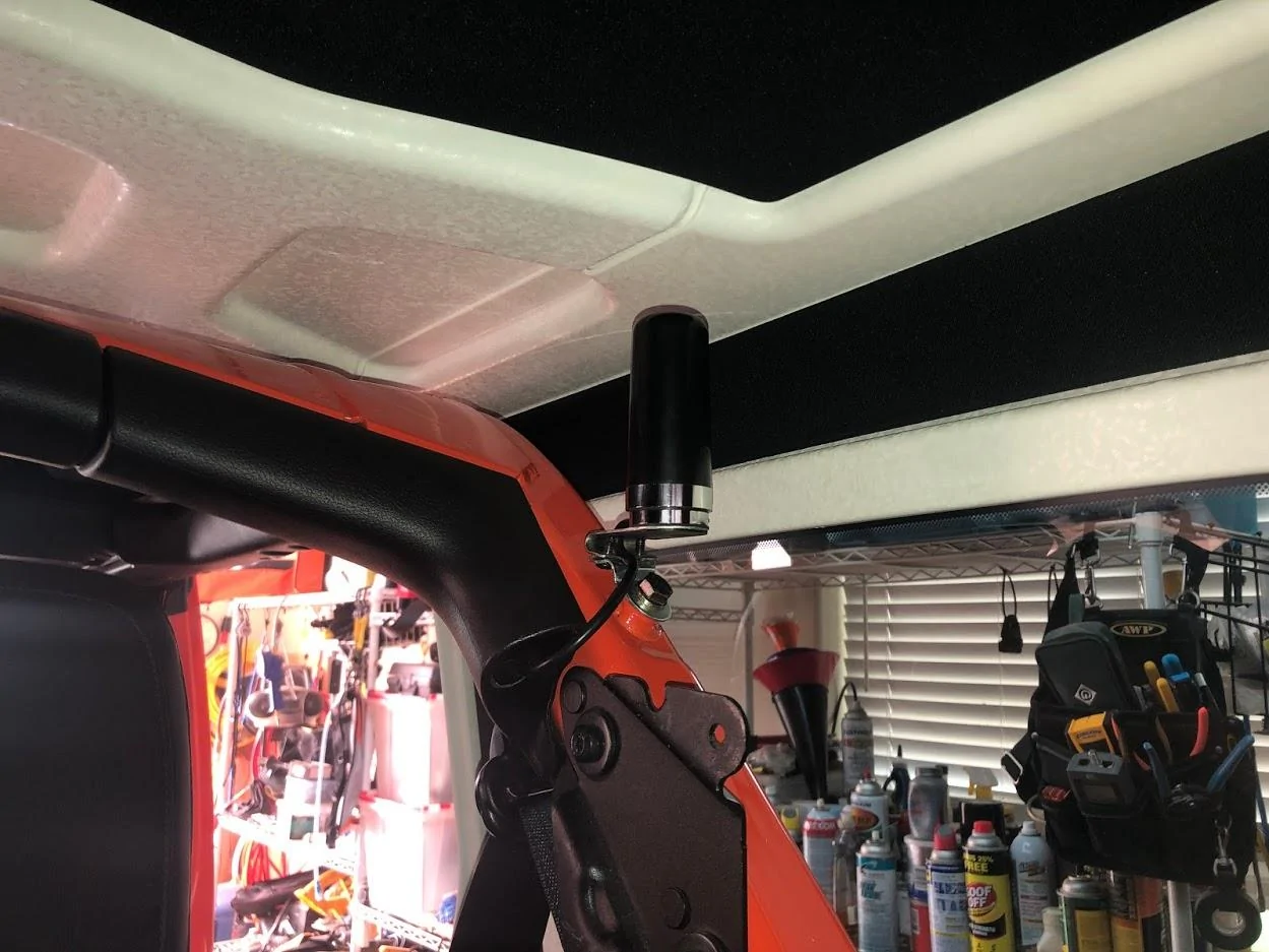

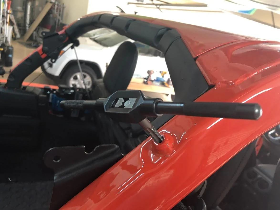

I mounted one inside the jeep on the rear sport bar. I tapped the back of the seatbelt and bolted it there. Works well for trail comms. It gives up some range for a ham radio if your looking for distance, but for GMRS and just trail comms in a group, it is great.
I used a NMO mount
Jeep Wrangler JL GMRS antenna mount IMG_0940
Jeep Wrangler JL GMRS antenna mount IMG_0943
With the Hard top
Jeep Wrangler JL GMRS antenna mount IMG_0949
With the soft top
