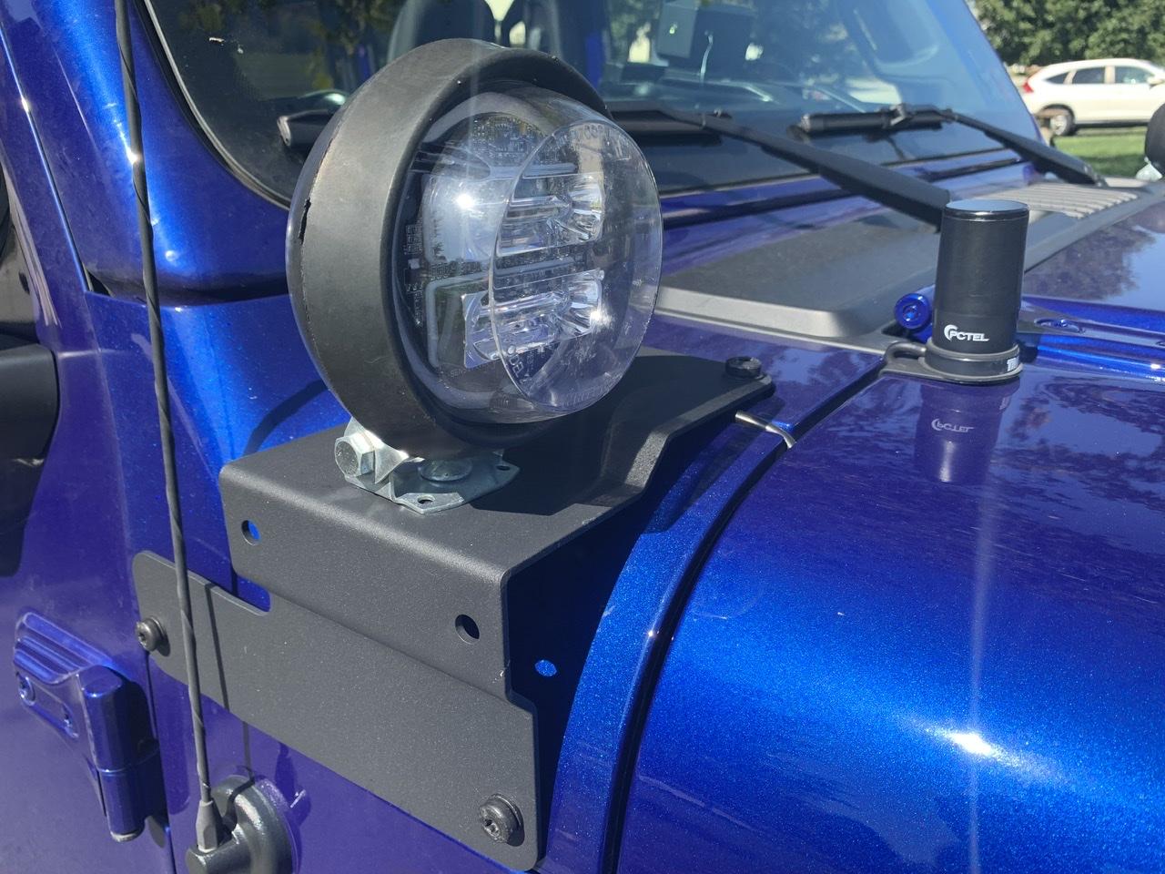

Here is a picture of the NMO mount on my hood. The antenna there was for a trunking scanner. I rerouted the coax in the cabin to my GMRS radio. I currently have the Midland antenna there.

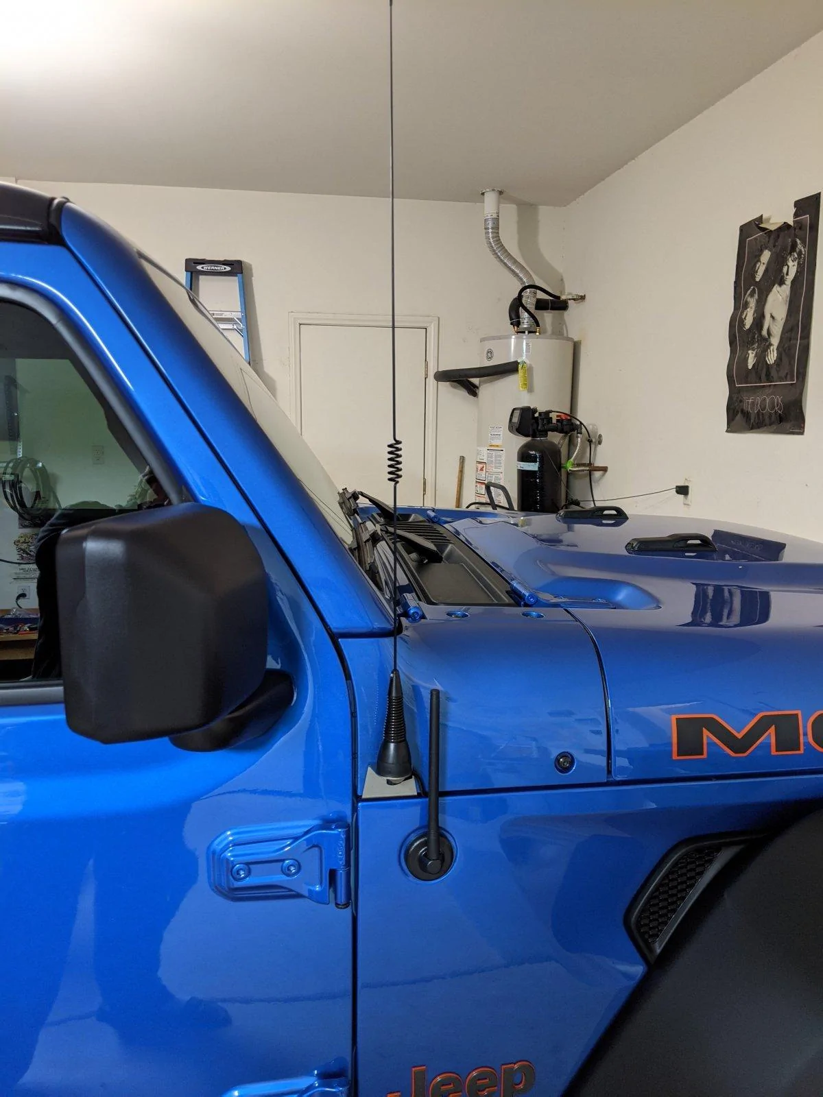

I ended up with this setup.
Just finished it a little while ago aamof.

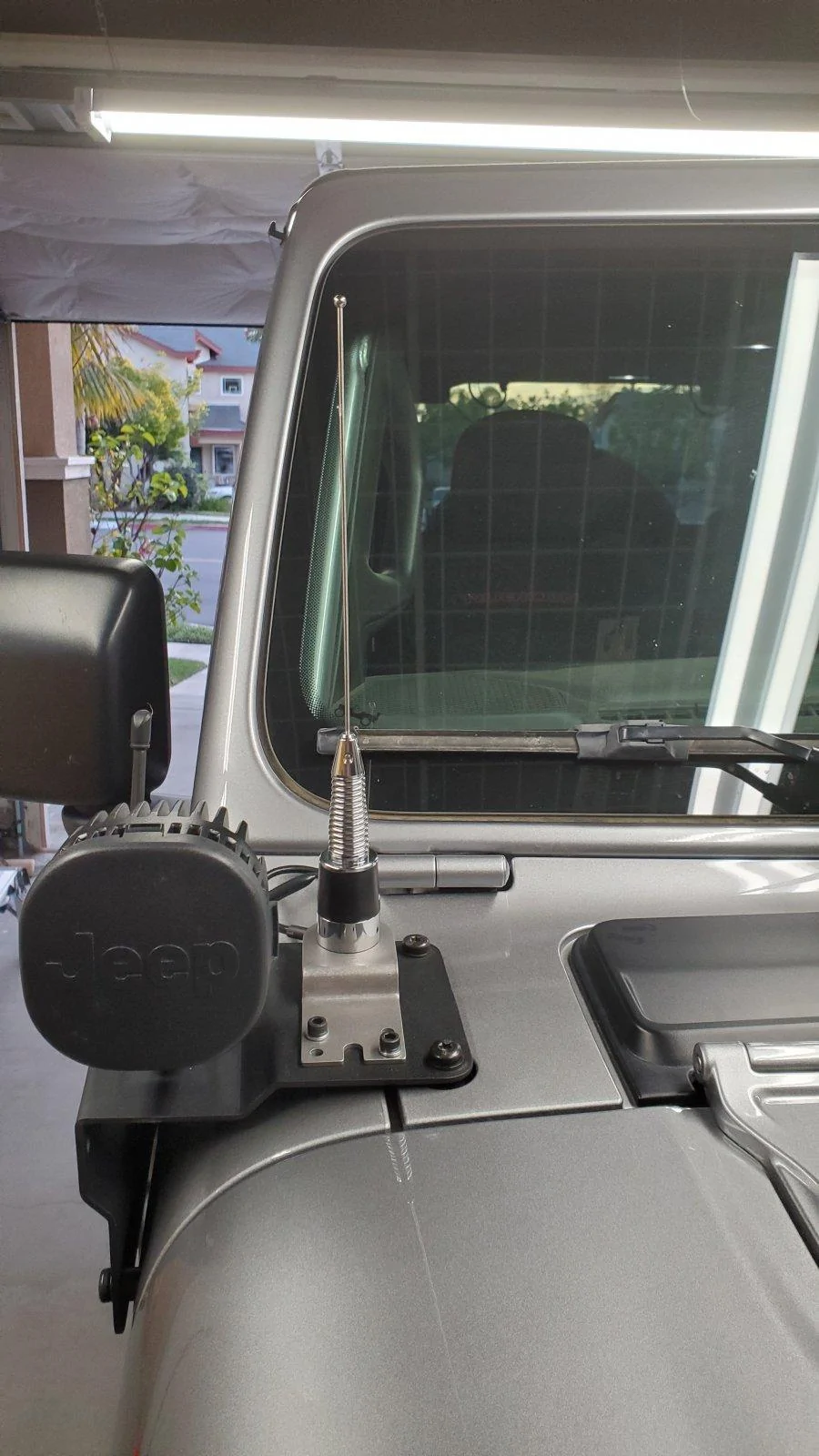

Yes, the all-in-one-kit with the Midland 275 has our rear bracket. Now that our front-mount bracket is available, I'll try to modify our web page to make the front mount an option in the kit. Until then, just email me.
The front-mount has a couple of advantages. First, it is super-easy to install. Those looking for a mount that is easy and where routing the coax can be done quickly, the front mount is a good choice. Perhaps also for those that want to continue to have their CB antenna at the back of the Jeep.
Because the front mount can use the aluminum hood as a ground-plane, I would expect that the performance of the front mount is also going to be better than the rear mount.
Suffolklou - I like what you did and it's great for a stealth mount. Trail performance with your group should be no problem at all.

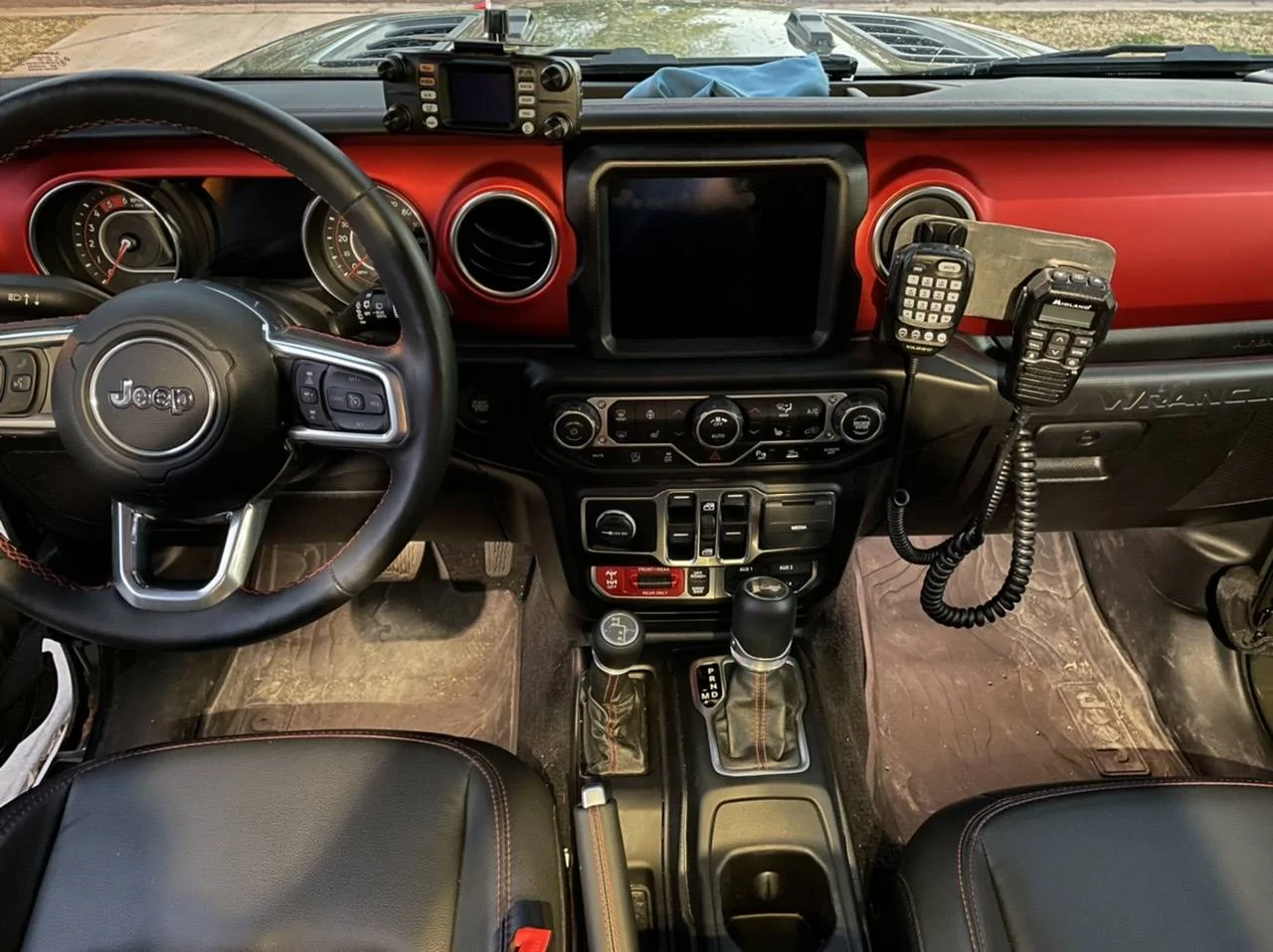

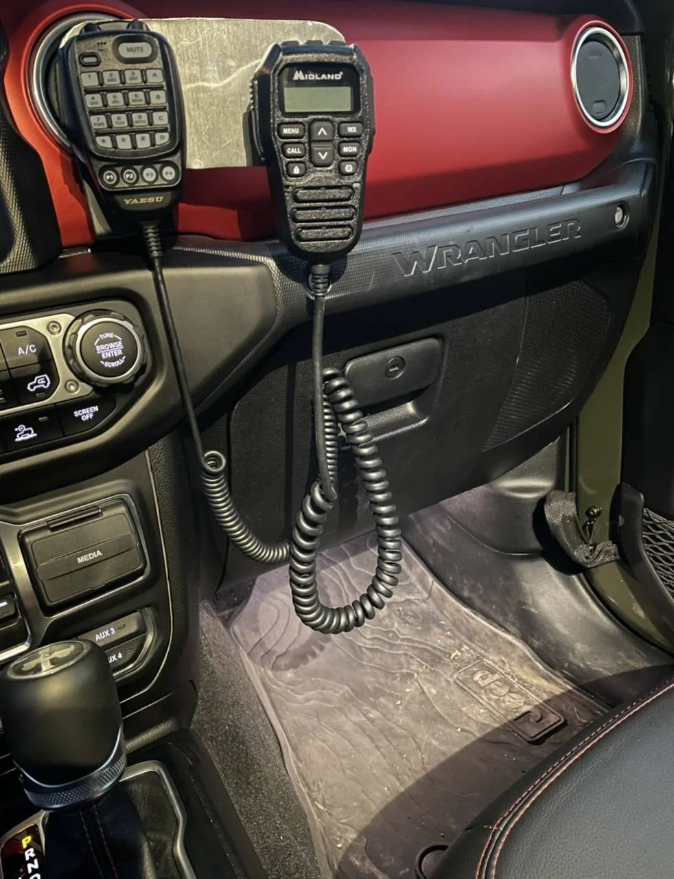

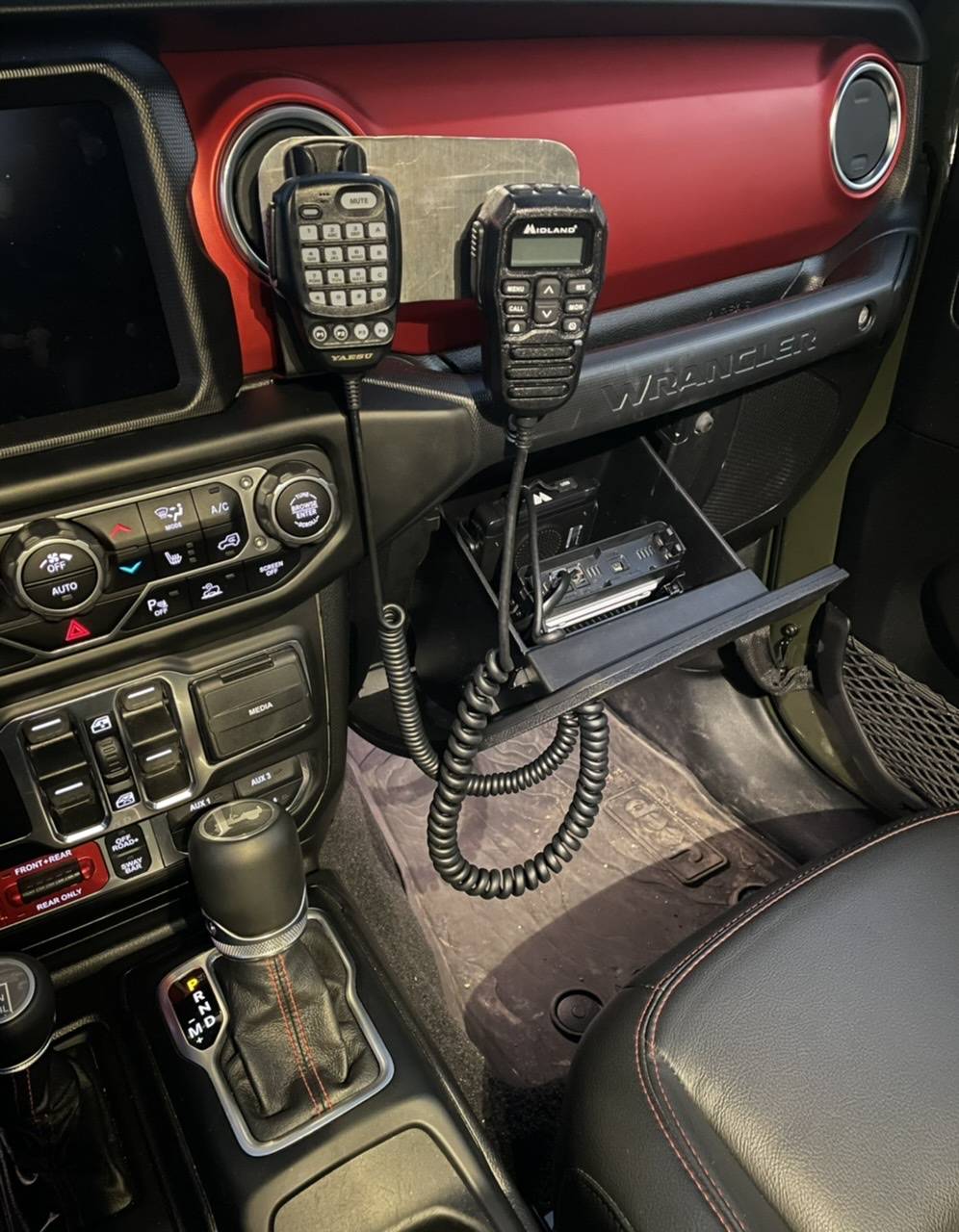

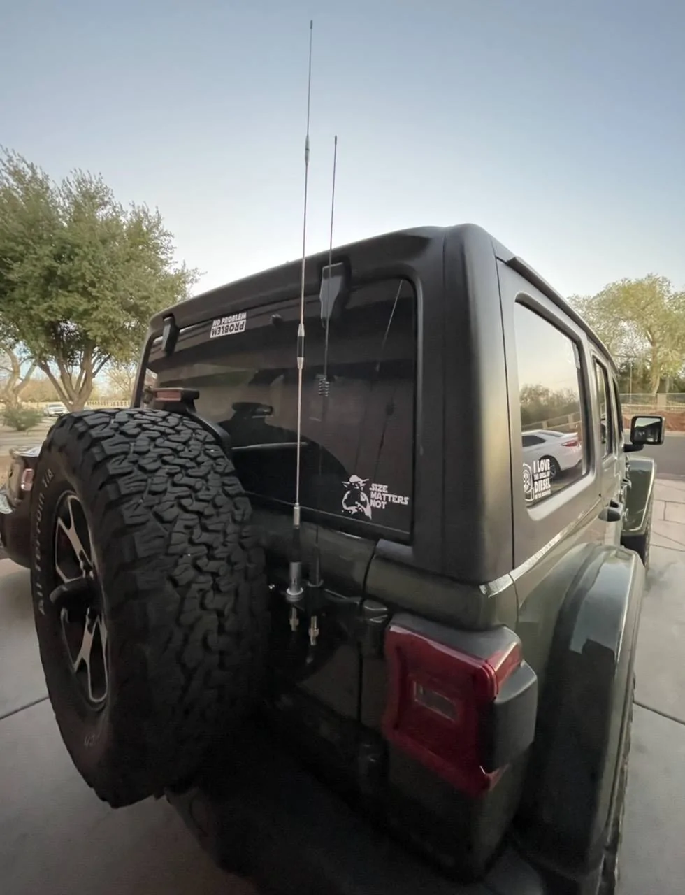

Here is my GMRS/HAM setup! Not very happy with it because the LMR400 ultra flex cable is going to probably brake, eventually every time i open and close the tailgate :/ but it works for now!
and thats how it looks inside:

Best install yet. did you use a grounding braid ?
I haven't yet. I have one for my CB antenna, but so far haven't really had any interference or issues with the GMRS radio that's made me eager to get one.
