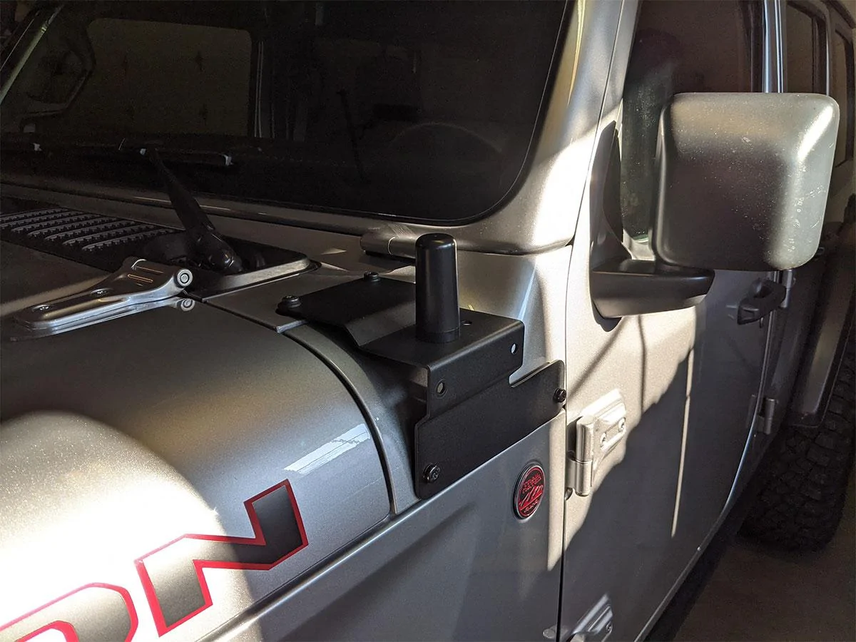

I've got mine mounted to the Mopar a-pillar bracket as well. I'm just running the ghost antenna, but I need to shorten my coax since I've got a good 3 feet of extra cable I don't need. For now, though, it works.

It's a nice clean look but much of your signal is being blocked by the Jeep. Ghost is more efficient and gets 360 full power range mounted high on roof with NO obstructions. Also LED lig
Jeep Wrangler JL GMRS antenna mounting 1000033881
Jeep Wrangler JL GMRS antenna mounting 1000033882
Jeep Wrangler JL GMRS antenna mounting 1000033883
hts close to Ghost can affect performance also. MIDLAND recommends mounting high no obstructions also. IMO with over 50 years of 2 wqy radio experience the best set up for an Wrangler is Midlands 7.5db gain Grand Vista antenna mounted to an Amazon spare tire antenna mount. They have for JK and JL
