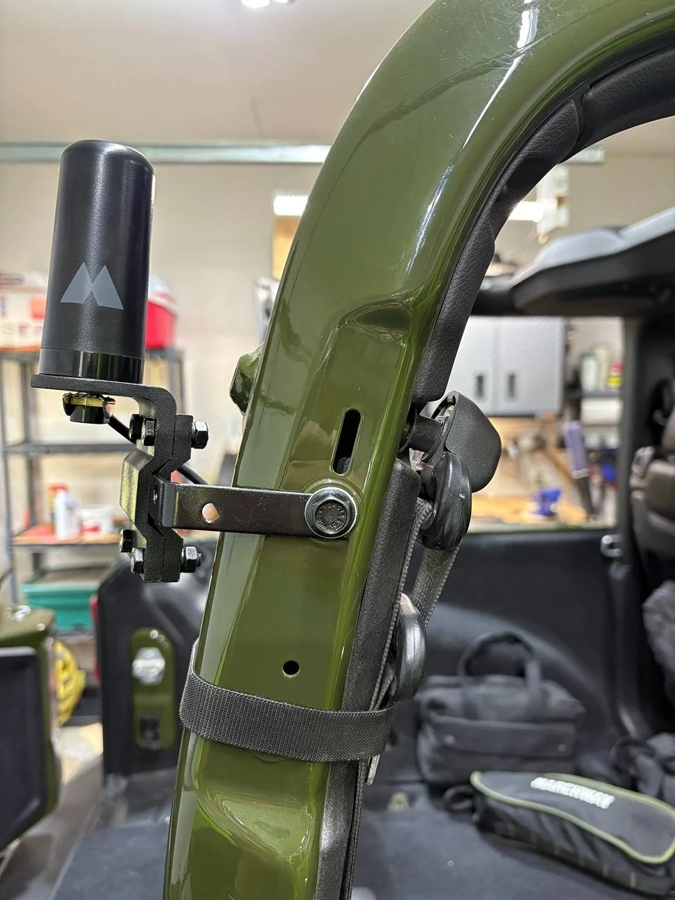

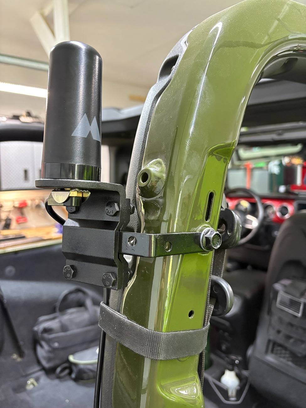

Here's an update on my semi-permanent solution. It's not ideal, but it works for what I need it to and goes along with my criteria.
* Midland MXT275 w/Ghost antenna
* GMRS will only be used on trail rides (or if I get bored)
* I have a manual, and didn't feel like working with the firewall
- I had no interest in having the antenna sticking out from , or on top of the hood/cowl
* Radio mounted in glove box and antenna routed to the back
So the original mount I fabbed up wasn't "thick" enough for the antenna/cable to properly and tightly mount. So I used a quick angle brace, drilled a larger hole and painted it black in order to fit the actual mount that came with the unit. This is why I'm calling it "semi-permanent", as I'll probably update it to a little more aesthetically pleasing in the future. Right now, I needed something functional for an upcoming trip.
The reason I'm posting this is to share my feedback to you on the reception as it's nowhere close to an optimal setup. I tested this with our base station at home (large antenna) and small handheld as well.
Antenna mounted to rear roll bar - no hardtop
* Ghost antenna for transmission/reception to base station is ~ 2 miles, with a large amount of foliage in the path
* Ghost antenna for transmission/reception to the hand held unit is ~ 1 mile
Again, absolutely not what it should be, but it's going to work for my needs for now.
BTW - clear transmissions. No humming, buzzing, or static
The reason I'm posting this is for feedback on the reception as it's nowhere close to an optimal setup. I tested this with out base station at home (large antenna) and small handheld as well.
My club experiences 8 to 20 miles with a properly set up Midland Grand Vista whip on spare tire carrier mount with MXT275. Antenna is always the critical part of the system. Your temp system looks good and I appreciate the pics and write up. But as you say, RX & TX are diminished due to where it's mounted as signal is blocked pretty much by metal in roll cage and Jeep. Good for temp and I'd like to see your final solution. The MXT275 can be mounted behind the panel under the steering wheel or just places under passenger seat freeing up space on glove box. Plenty of YouTube videos on this. Peace and good luck!
