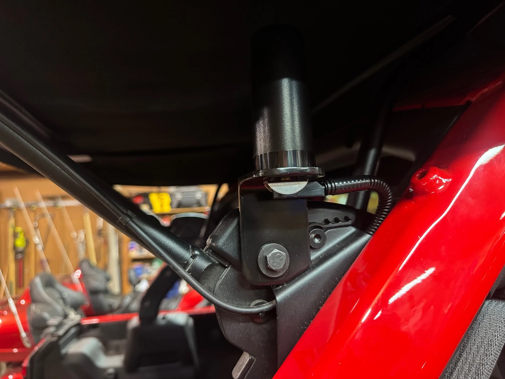

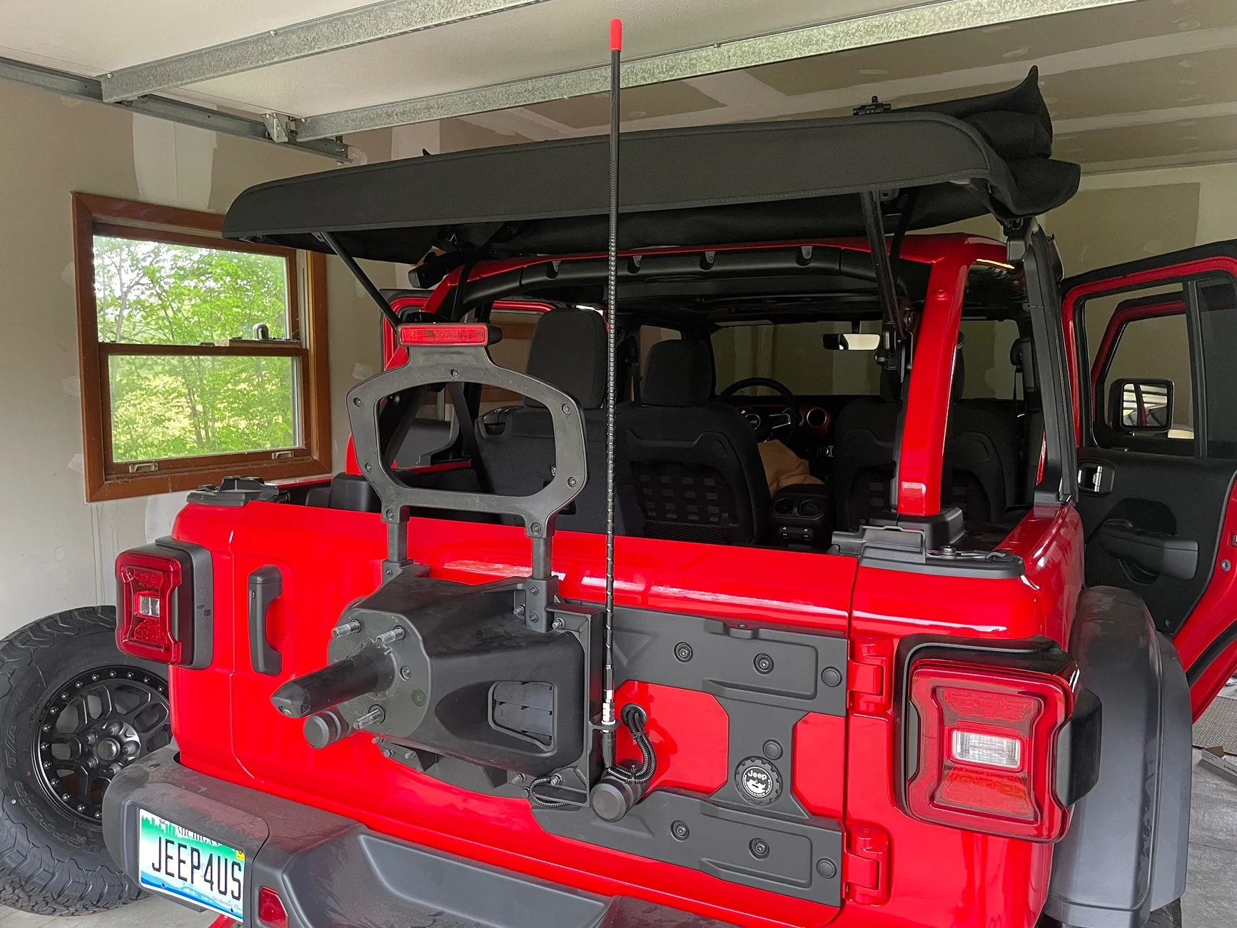

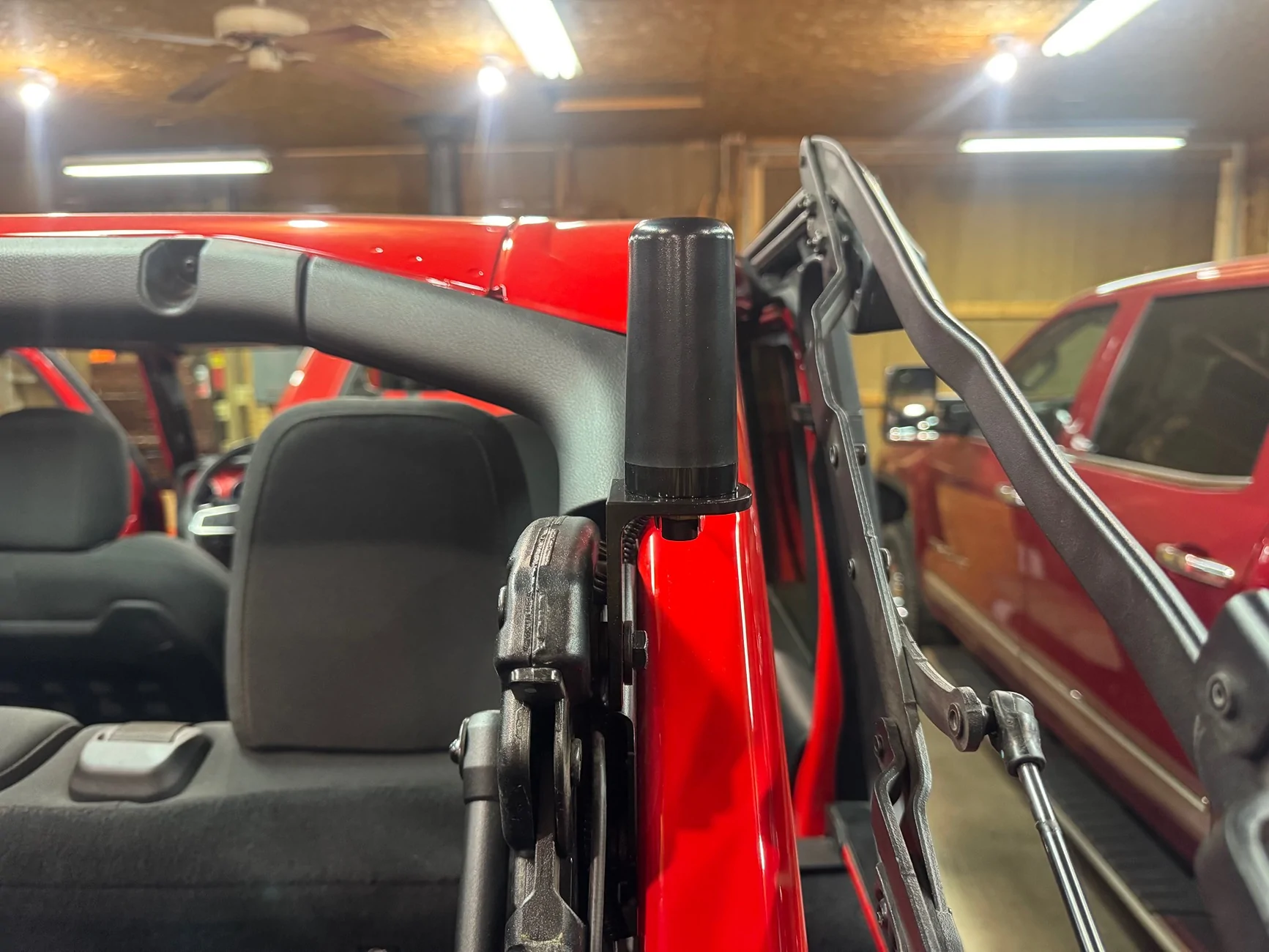

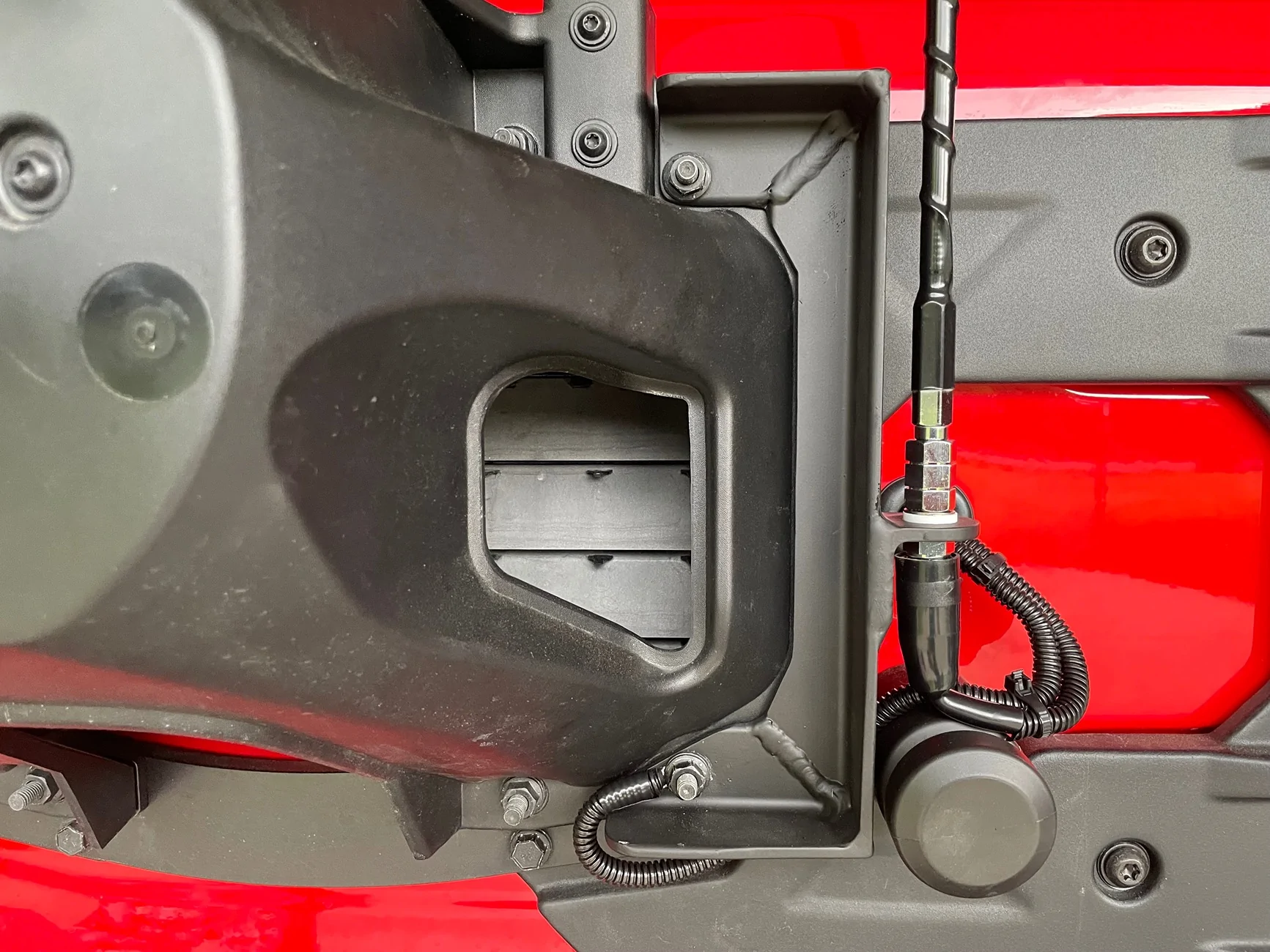

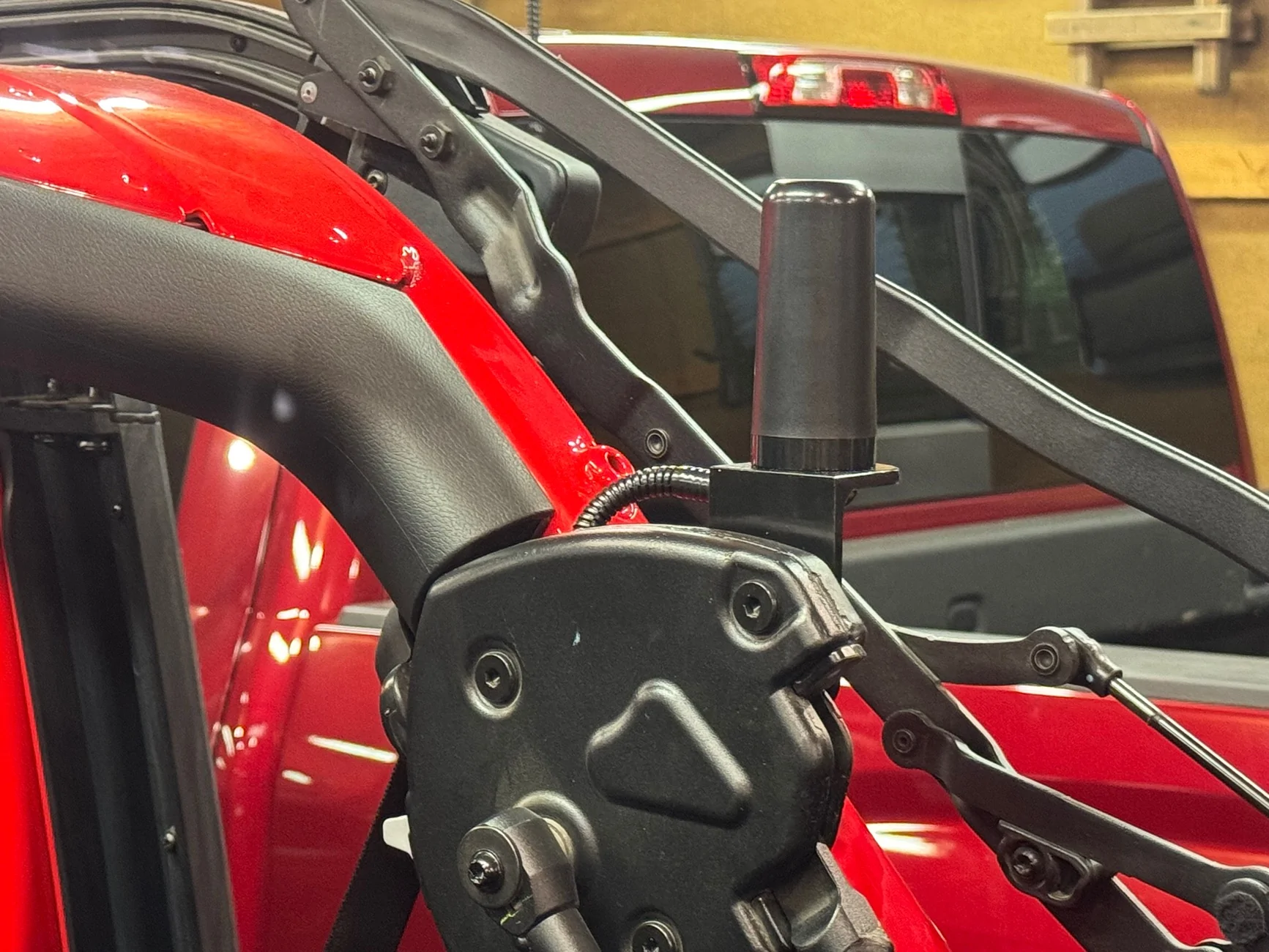

I had a hard time finding a suitable bracket to mount the CB antenna on my 2022 Rubicon XR so that it would clear the garage door. Ended up making some boxboard templates the cutting a bracket out of aluminum angle and getting it welded. There just didn’t seem to be any “pre made” solutions that worked with a 3 foot antenna to clear the garage door. When we migrated to GMRS earlier this year I chose a ghost antenna and made an aluminum angle bracket to mount it to the soft top hinge point inside the Jeep. One bolt needed to be changed. The ghost is for shorter range transmission but we did an initial distance test out of the campground at about 2.5 miles, better than the CB (which we retained in the Jeep) at about a quarter mile.

I was looking at doing the same type of mount but maybe putting it on the front crossbar. I'm just concerned having an antenna that close to my head might pose a hazard for health risks. I imagine though it would take many hours of constant exposure to cause any physical harm. Only thing about mounting the ghost internally is I can't mount the 3' whip antenna for highway use unless I'm top down.

The health risk is much less than most imagine. Being 2 feet from a 50 watt GMRS antenna carries the same risk as being 2 feet from an old fashioned 50 watt incandescent light bulb. 65cm rf is not ionizing radiation. Just don't hold onto the antenna while transmitting.
