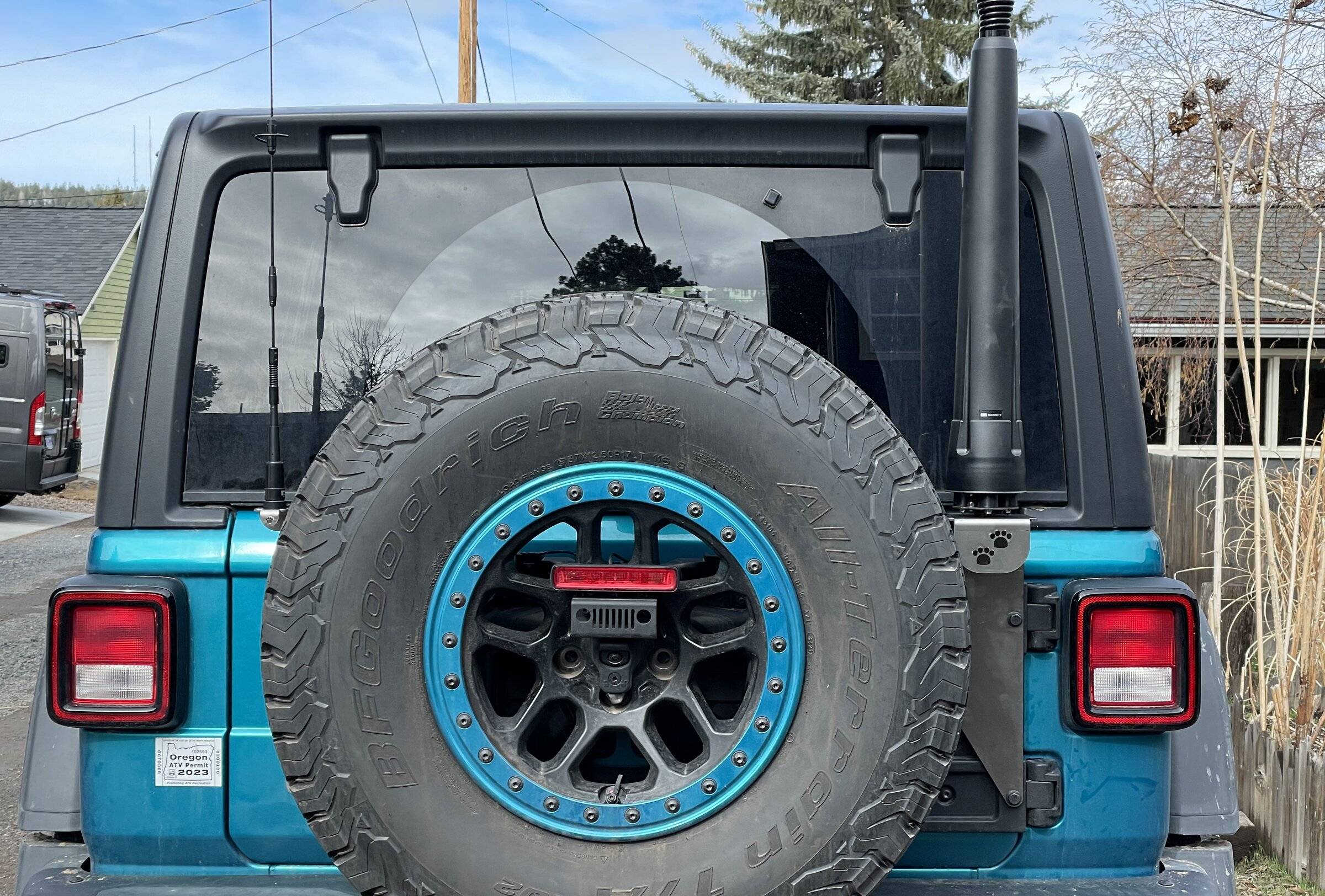

Designed and built some mounts:
Jeep Wrangler JL GMRS antenna mounting 116C8F3B-AC2C-4D49-9245-EEBBD8A9D1FA
2m/70cm/GMRS to the left, HF/CB to the right. They’re designed for use with the top off (a fastback top might also be OK), but they’re decent with the hardtop on.
Grounding was a bit of a pain. Ended up snaking one wire down through the tailgate hinge area to the body isolator frame bolt, and another along the top of the body and then down to the ground stud near the rear passenger door.
I have the other four prototypes out for powder coat, then I need to figure out if I want to leave the paw cut-outs as-is, or add a bikini pearl insert..
