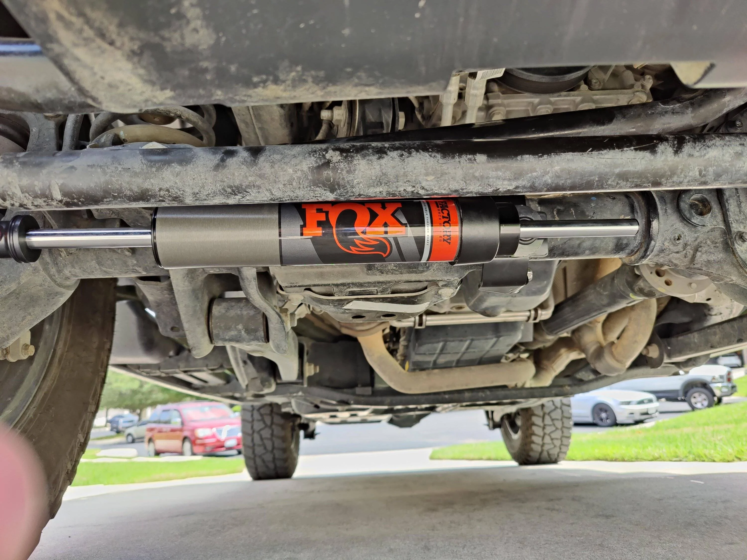

All great inputs here. I would add that, for me, the Fox Performance Series 2.0 ATS steering stabilizer (and a steering box replacement under Jeep technical bulletin guidance...) dramatically improved my play. It's not Corvette tight, and never will be, but because it has 24 clicks of adjustment on it I truly noticed a BIG difference, primarily when in high wind conditions. I'll have to look into the LCA replacements as well, as have wondered about that for some time, so appreciate all the feedback here. In the interim, though, the steering stabilizer replacement is a good start, and worth the cost, IMHO.
