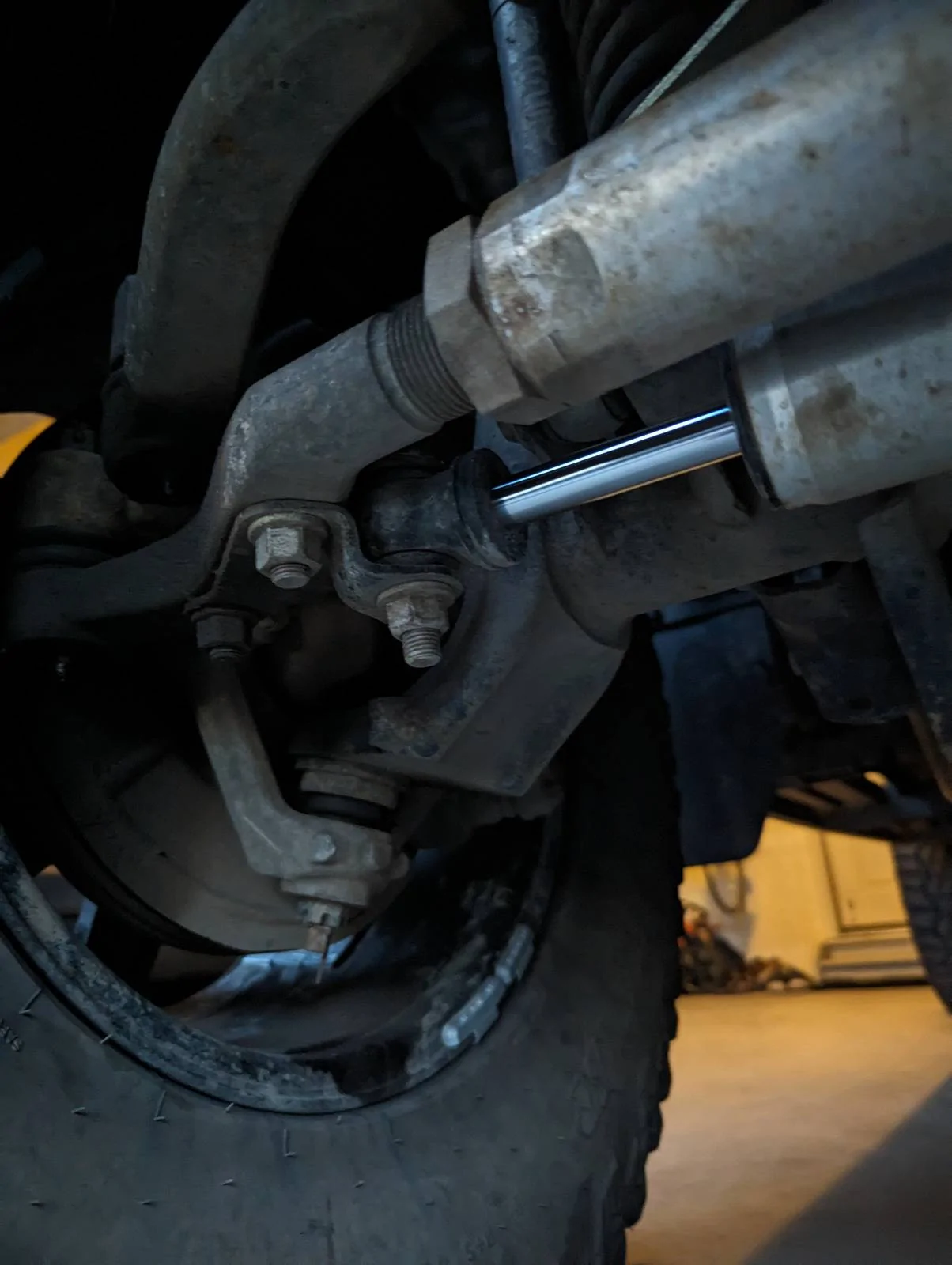

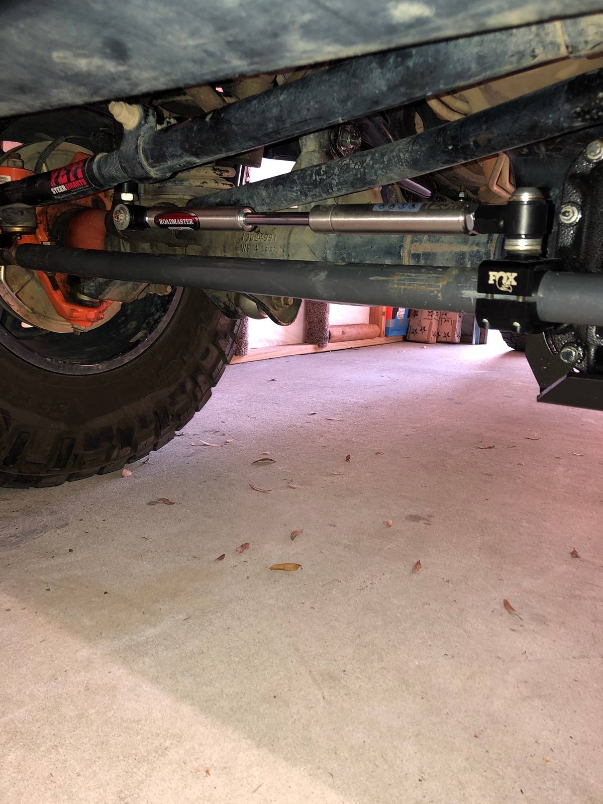

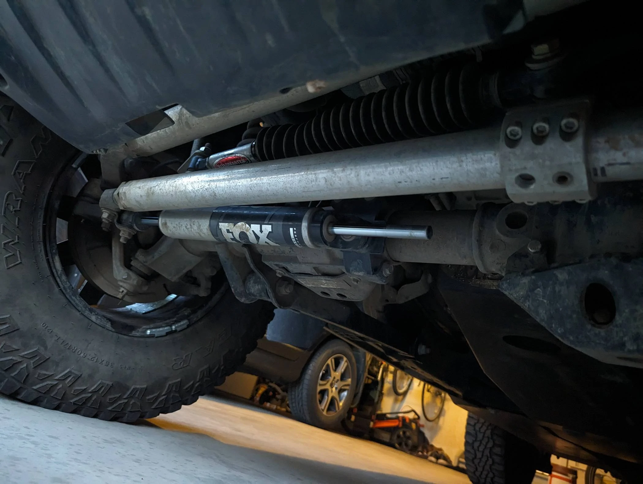

This is my setup, RPM tie rod with bracket connecting to steering stabilizer relo at track bar side for Exact Center, and Fox in standard position. The Exact Center took awhile to dial in, I found trying to adjust it by shifting the tie rod bracket didn't work and I had to loosen the jam nuts and rotate it a little at a time. Also had to get a bushing at Ace for gap between Exact Center end and bolt that connected it to bracket.
