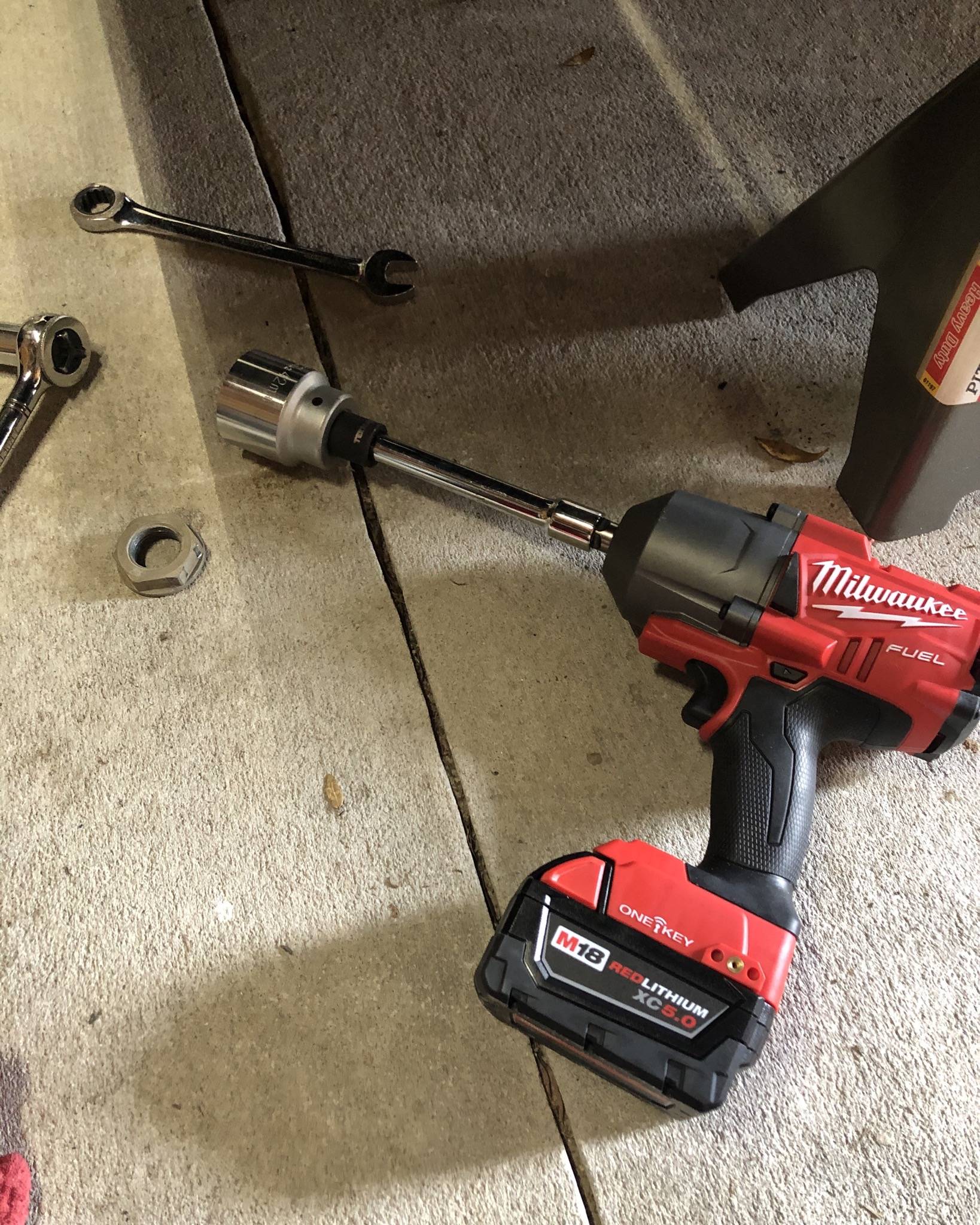

LCAs came in today. However, I am not able to break the old ones loose. Guess these old torn up shoulders arent what they used to be lol. Looks like Ill have to return the torque wrench and pay someone else to do it. Kinda sucks, I wanted to get it done today on my own lol.

If you had a breaker , that would help get them out. If you have bad shoulders, I’d suspect you’d have a really hard time getting the new arms torqued on to 190.

Have a breaker and still failed. After trying this, I am inclined to agree with you on not being able to torque them.
Make the investment……..
Jeep Wrangler JL Exact Center 55549250-958A-413A-AA54-B7C93645265E
You’ll be wrenching on your rig a lot over the course of ownership, this will make it a lot more fun…… three rat-a-tats and pitman bolt was laying on the floor, takes lca bolts off in a couple of seconds, you will use it more than you think you will right now….. just be careful not to use it on setting 4 when loosening and tightening bolts or the heads of the bolts will be on the floor, ask me how I know…..:facepalm:

A good impact is really nice to have for sure! A must have for me.

Yeah Ill agree with you there 100%. I have an impact its just not good enough to remove these bolts. Mine is a Porta Cable.

Time for an upgrade. ?
Mine is a kinda basic craftsman and it zipped out my control Arm bolts No problem.
