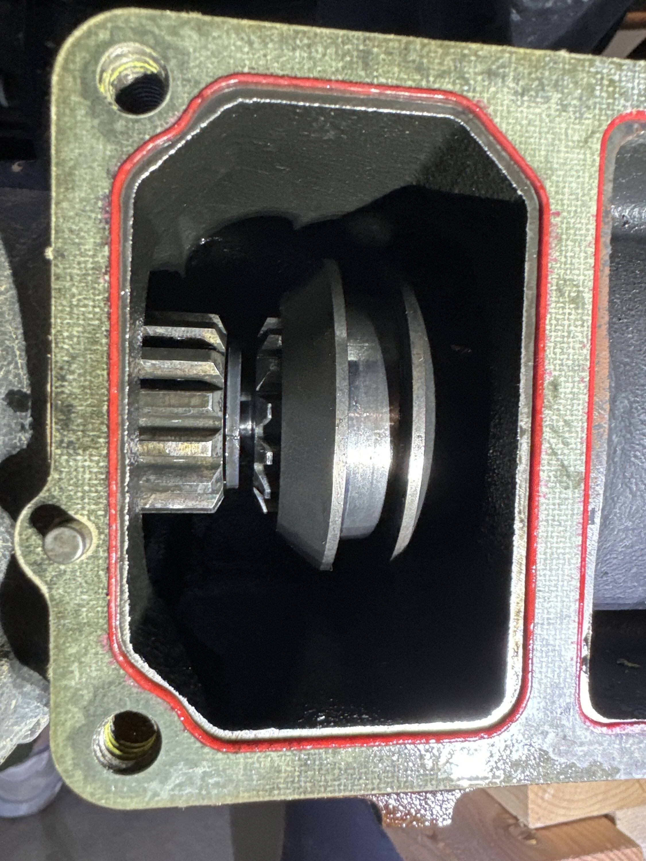

Yeah, that’s all correct. But for some reason, I was struggling getting the collar to slide onto the inner but I finally got it. Does the inner and outer shaft need to be touching or is this gap ok? Seems like the axle shaft can’t go in any further but I see a slight gap still.
So I can't say I looked at the width of the gap -- but it makes sense that the two can't touch because you need them to not rub when disconnected -- it's the sliding of the collar across both axles that locks them to have 4WD.
Plus, once you fully tighten the hub to knuckle bolts (the 12pt ones), there is no way that the outer axle won't be exactly where it should be. It's all fixed.

Well guys. I thought I was on the final stages of finishing. Got the other two ball joints installed and knuckle put back on. Threw the axle in which seemed to seat just fine and got the 12 point bolts in the back torqued down. But now when I spin the axle with my hand, I hear a clicking noise inside the axle tube near the diff. Is it possible the axle didn’t seat properly? The other side doesn’t make that noise.
I’ll get finished at some point. But some insight on the axle noise would be fantastic. I’ve read some folks say it’s normal, but I don’t remember spinning the axle and hearing that noise before.

What diff do you have? Open? Locker? Is the FAD still open? Can you spin the wheel and look inside the FAD to see if there's any slippage with the collar?
I can't say I've spun just one JL front wheel like that, so not sure. But if it's an open diff it should be quiet.
I’ve got a front locker. FAD is closed back up already. This is on the driver’s side too. Which I thought was a simple pull out, put back in and no collar to worry about.
I'm not sure about the front lockers in a JL making that noise. Probably it was there before and you didn't notice. Perhaps someone else with a front locker can chime in.
Edit: I started to say engage the locker and try it but I don't think you'll be able to do that without locking the two axles in 4wd, so nothing will spin.

I’m going to pull the axle shaft back out tomorrow morning and try reseating it. I don’t know what else could be the issue right now. Don’t have the energy to keep troubleshooting tonight. I’ll check back in tomorrow. Thanks again for the help.
