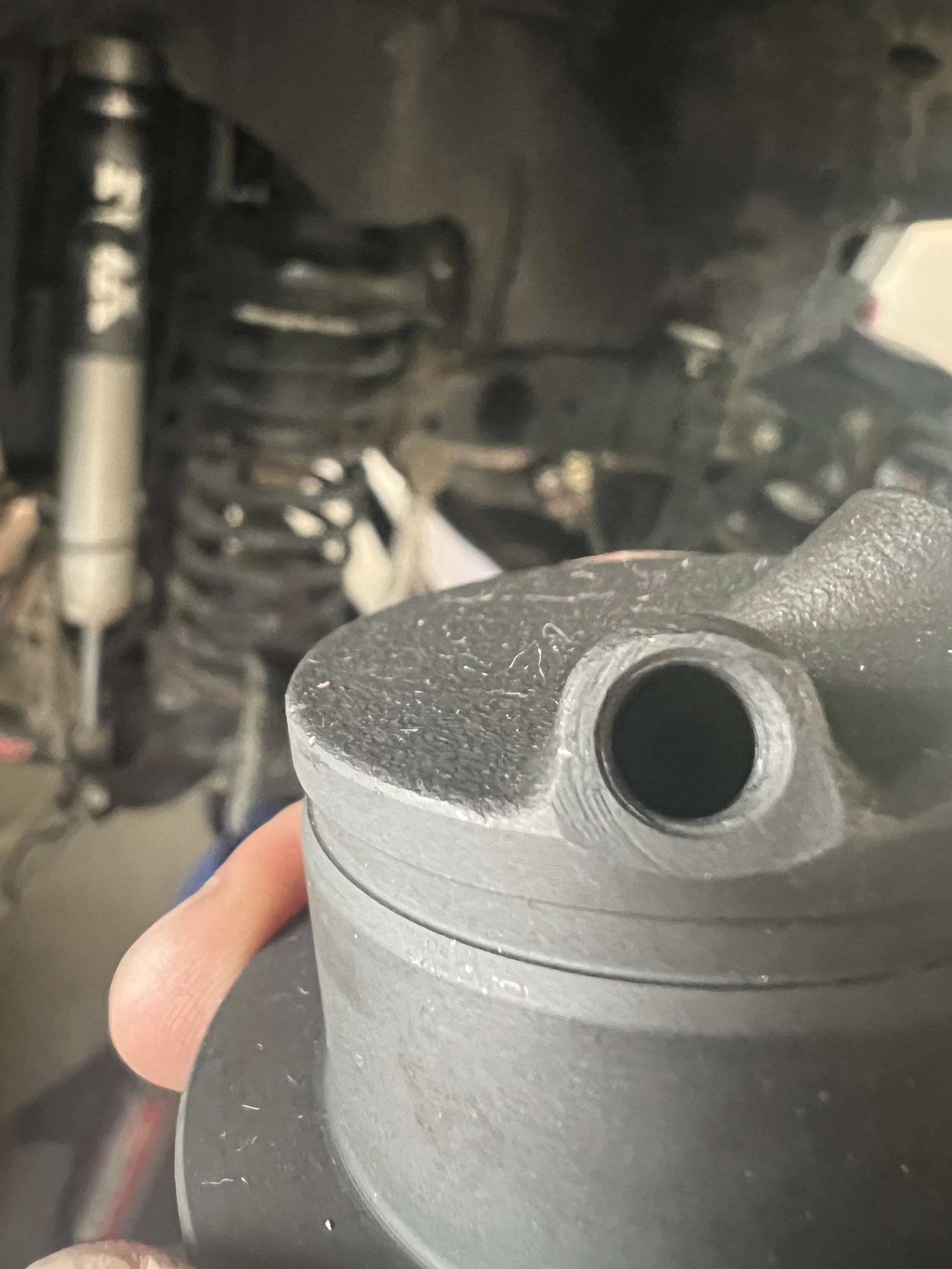

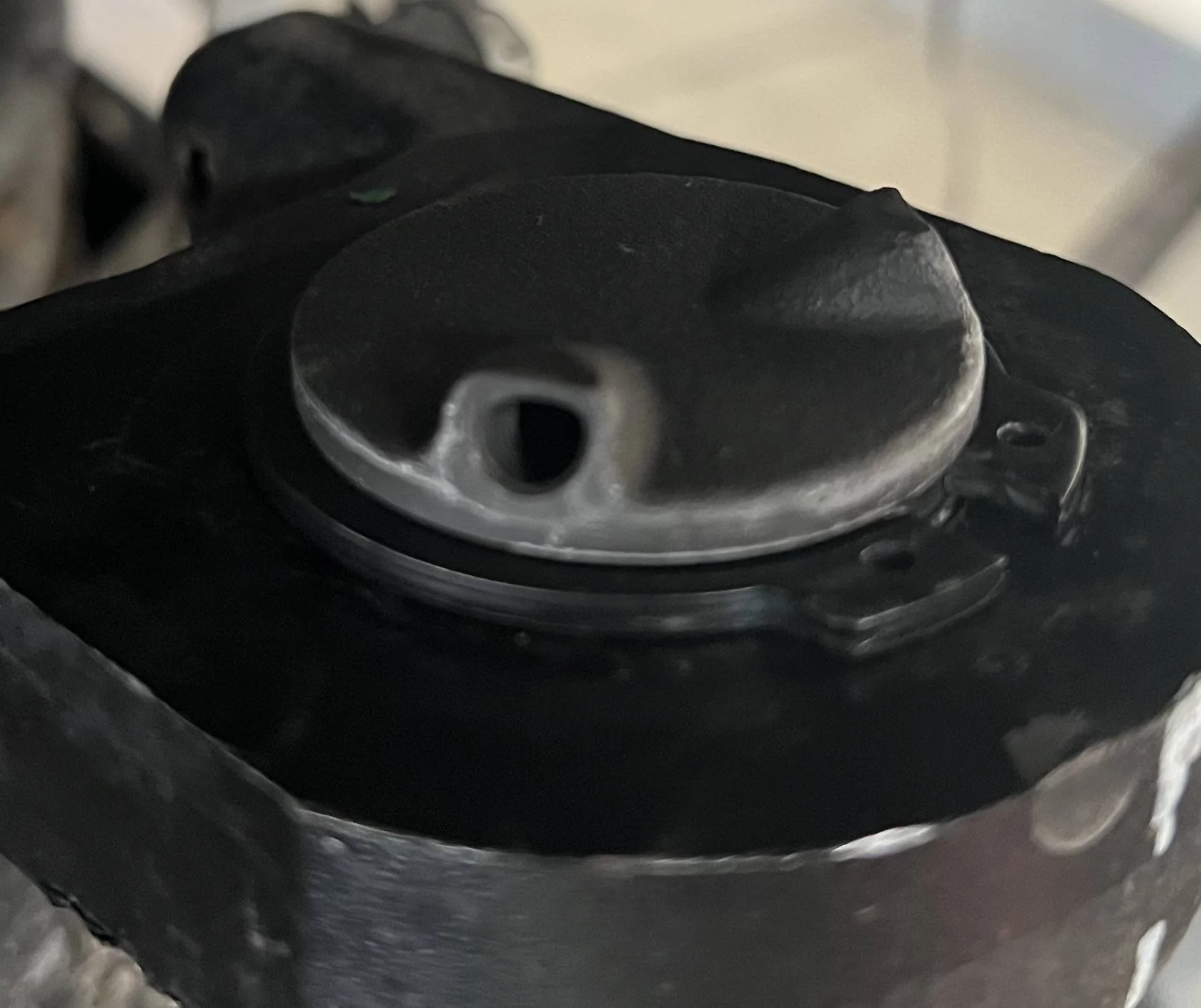

Hello all... so during my install of the Teraflex HD Ball Joints, I managed to partially crush the zirk fitting screw hole and now cannot get the zirks installed since they are out of round. One photo shows how it is partially crushed in and the second shows as it should be. I am hoping I don't have to remove them and there is some solution.... Tagging a couple of guys I know who have loads of experience in wrenching.

That's not bad at all. While not ideal, the opening doesn't appear to be broken/cracked, so you should be good to fix that. I'd take a screw driver (something round) just smaller than that opening and then lightly pry up on it push it back into shape.
What he said ^.
I would use a tapered punch and tap it with a small hammer until it’s round again. Then tap the threads.

What he said ^.
Having been a machinist in a former life and shop owner, I've seen a lot of damaged stuff. The tapered punch idea should work to round out the hole, but at the price of the threads. Tapping the threads again should fix that right up.
The tap size of zerks can vary, but my recollection is that they are very commonly 1/4-28. But probably should call Teraflex. 1/4-28 is a common size for fine thread bolts.

If you can’t fix it, plug it or cap it, I think you can get it greased with the one zerk…
Hopefully the tap/rethread will work when I get there. I didn't mention that both zirks on both uppers are crushed. So fingers crossed that will work.

Yes, it was. I am guessing I just had the wrong part for the top press and it caused slight damage to the zirk fitting.
