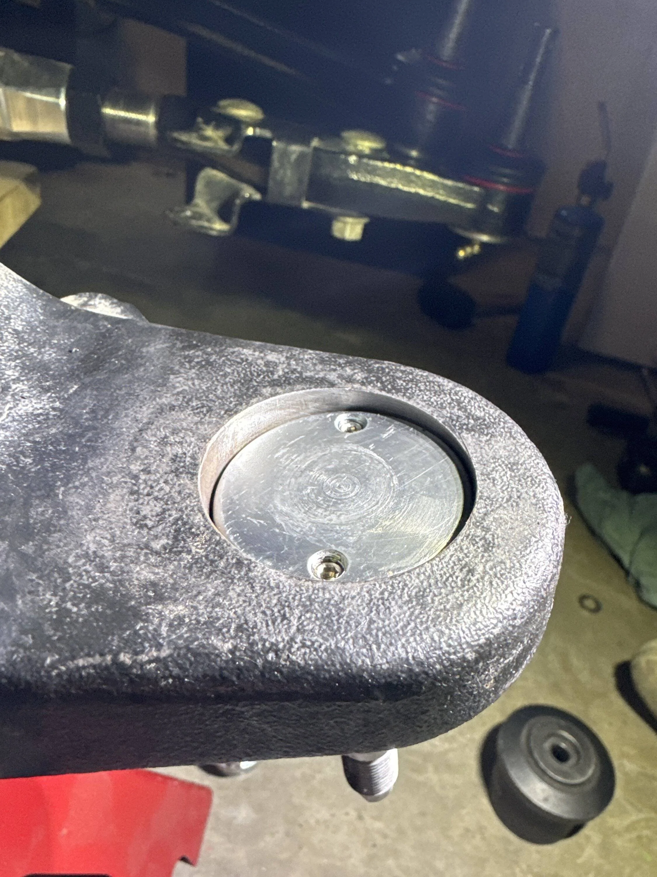

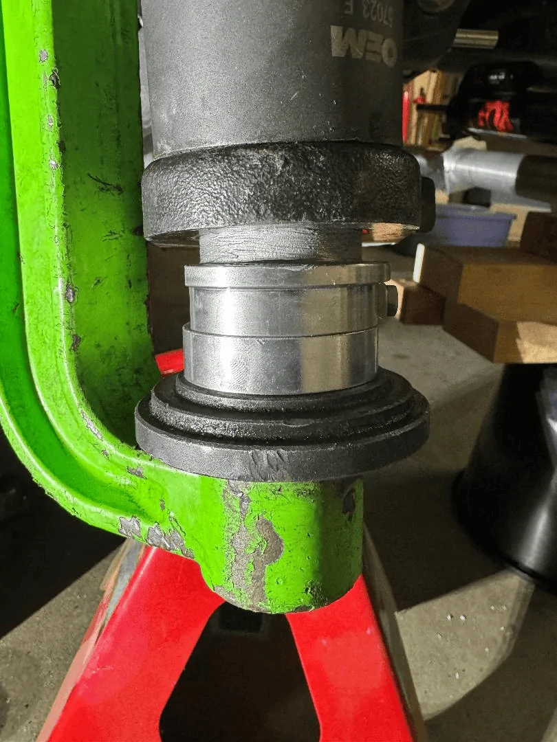

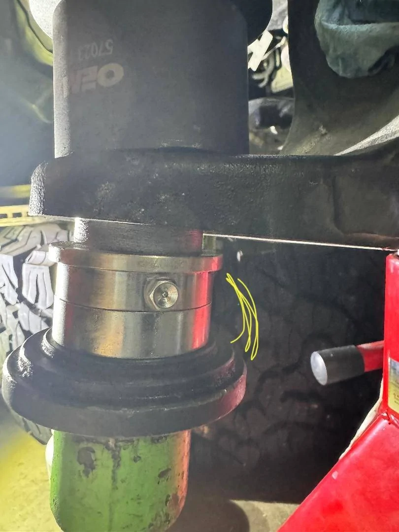

Howdy y’all,
I thought I was prepared enough to tackle this job, but I'm running into a problem with my first attempt at seating the lower ball joint on the passenger side. I rented a c-clamp ball joint press from AutoZone and removed the original ball joints without any problems. But, when using the correct adapters to install the new ball joints (bought the install kit from Dynatrac too) the new Dynatrac ball joint only goes in a few cm and I can't crank on it anymore. Another issue I'm seeing is the threads from the c-clamp bolt are digging into the inside portion of the upper ball joint hole. (Instructions said to do the lower one first. I'm assuming its because you need to put the c-clamp bolt through the opening of the upper ball joint to tighten the lower down.) I thought my c-clamp might be bent or something, so I went back to autozone to swap out for another one, but running into the same issue. Pictures of my current issue below:
Jeep Wrangler JL Dynatrac Ball Joint Issue - Need advice. 1707694746298
(This is as far as I can get the ball joint to press in, with a 2ft breaker bar. Impact won't move it any further)

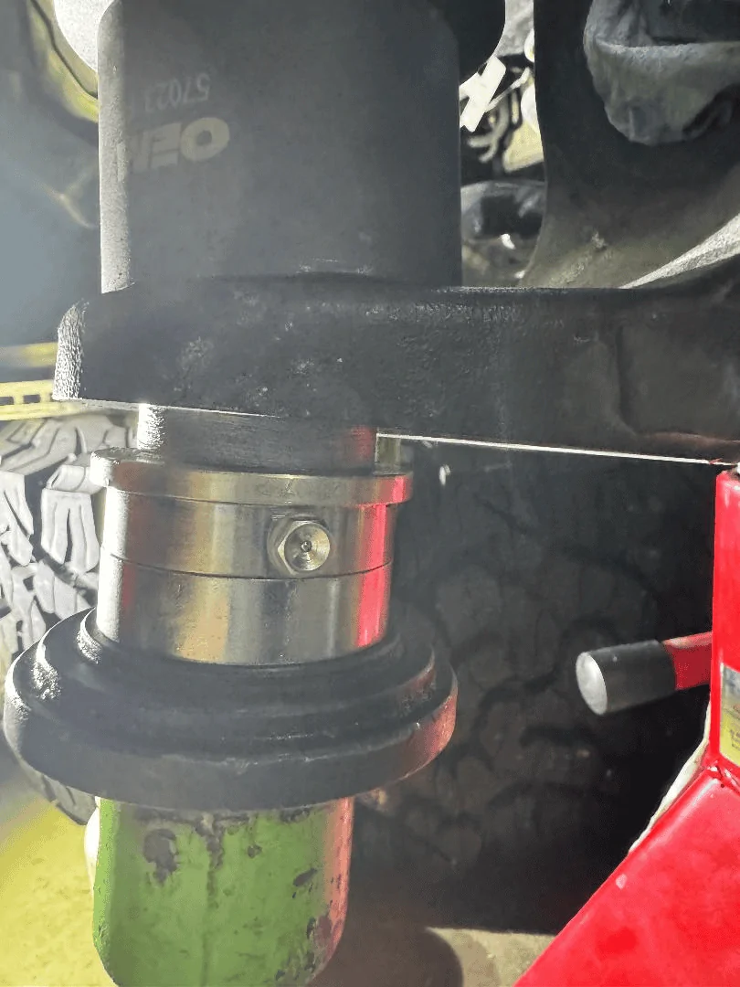

Jeep Wrangler JL Dynatrac Ball Joint Issue - Need advice. 1707694752682
(View from another side, won't go any further pass this point)

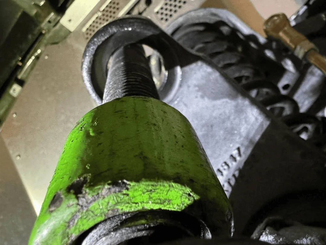

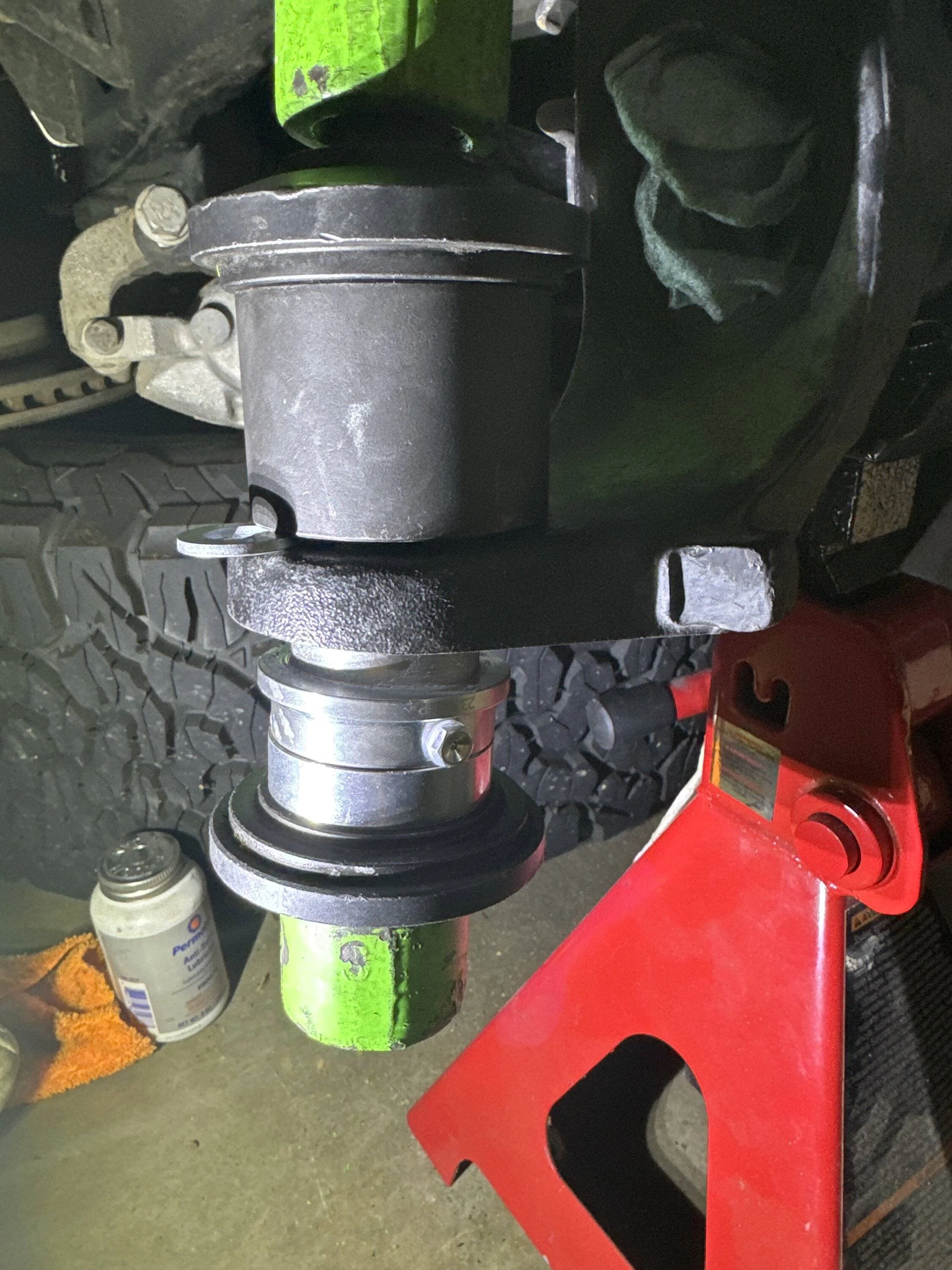

Jeep Wrangler JL Dynatrac Ball Joint Issue - Need advice. 1707694827787
(Threads making contact with upper ball joint hole above when everything is tightened down)

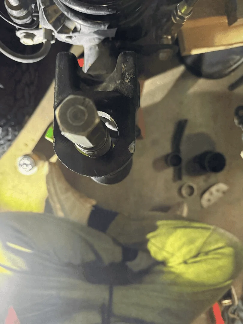

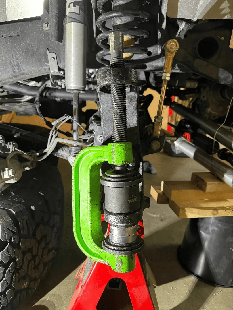

Jeep Wrangler JL Dynatrac Ball Joint Issue - Need advice. 1707694870376
(Head to toe view of how I have it setup to press the joint back into the lower hole. No luck. )
Jeep Wrangler JL Dynatrac Ball Joint Issue - Need advice. 1707694919224
(Another image from above showing contact being made inside upper ball joint hole. Rotating it when tight causes damage to the inside of the upper ball joint hole)

In the first picture, it looks to me like the ball joint is cocked a little. That will definitely stop progress. Is it possible to press it out and start over?

I've pressed it out already (which didn't take much force since it didn't go in very far the first time) and tried a 2nd time (which is pictured) while being sure to go slow and ensure everything is straight. But, as I get to the point where I need to put some force on it, it seems to want to get crooked and this is where I get stuck.

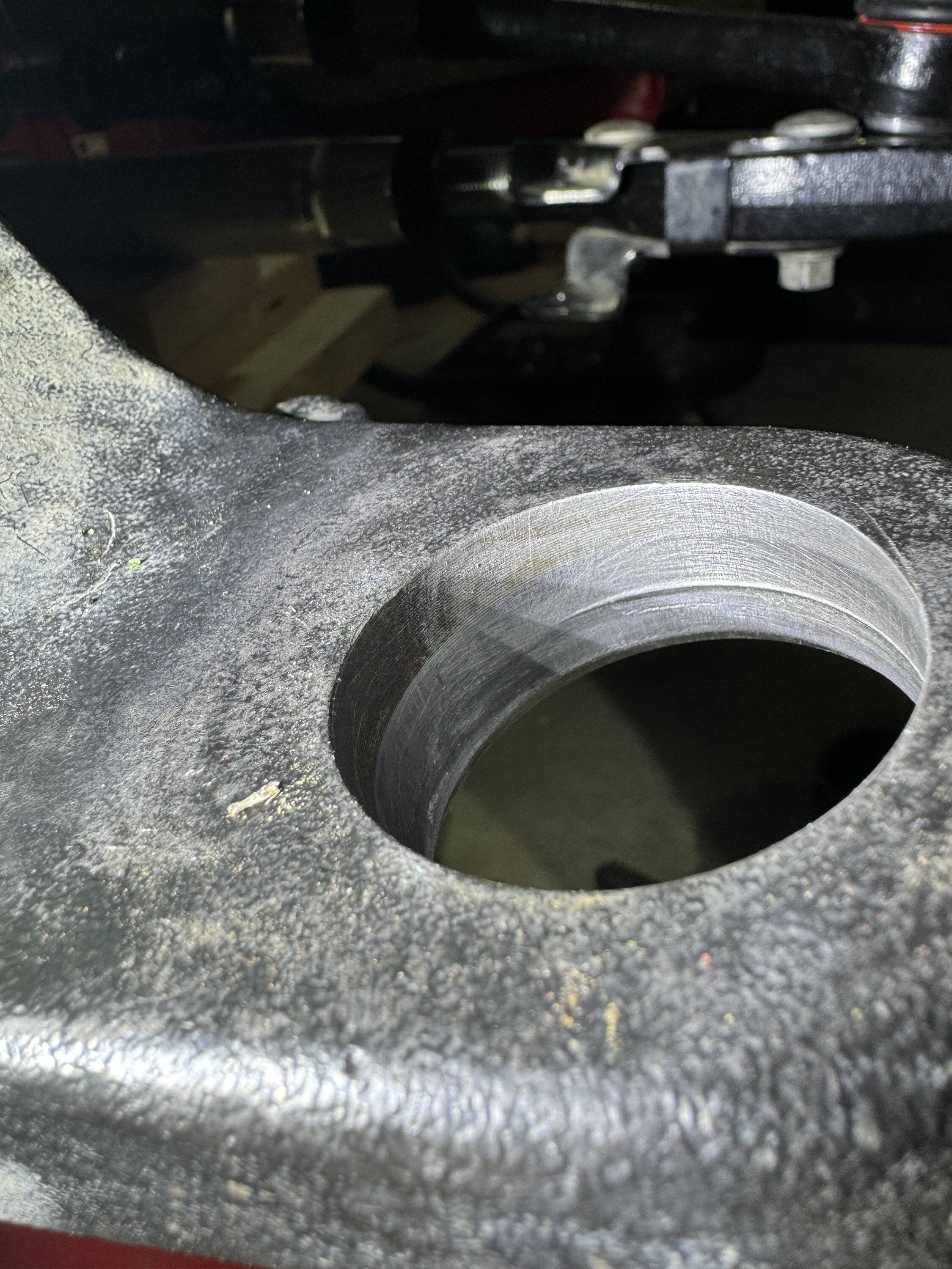

Looks like I’ve got a lip that formed. Not sure if it was a previous install, or me the first time trying to force it in. Do I sand that lip down to flatten out the surface?
It is, the upper surface of the lower C is tapered towards the end. You need to get a wedge to put under the end so the tool will press it in straight.
See the blue highlighted area.
I would clean that little lip up, but be careful you definitely don’t wanna make the hole too big. Use a Dremel tool if you have one and just get that lip down. Try adding anit seize and freezing the ball joint for your next attempt.
Gregj
Definitely makes sense. Just confused why I need to add a wedge there but the 10 videos I watched, no one added a wedge and they went straight in with the same tool I’m using. Any suggestions what to put in place as a wedge? How high to I need to raise that edge?
A piece of 1/8 inch metal strap under that side should be enough to line it up better. As to why others have done it with no problems, who knows.

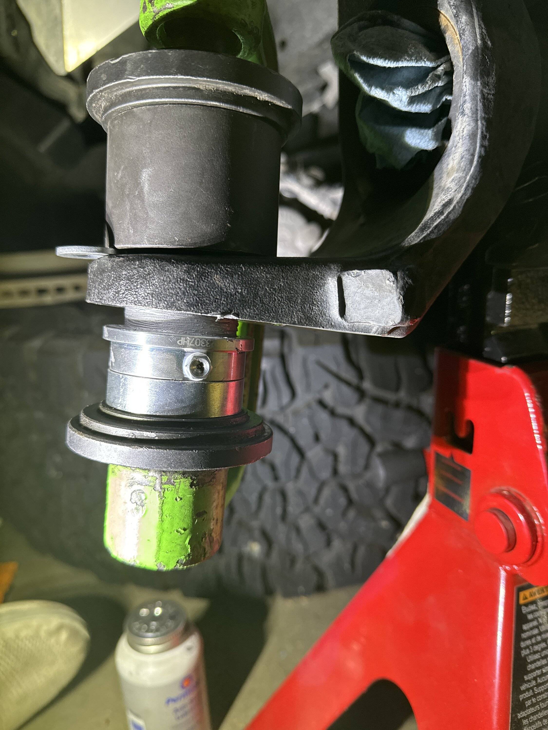

And there won’t be any issues with that wedge blocking the ball joint from coming up is there? I don’t have any metal straps laying around. I was thinking about putting a washer or two under the top adapter. Kind of like so:

That should help, once it gets going in it’ll go a lot easier. When it is almost seated take the washer out and finish seating it.

Feels like I’m getting stuck at the same point as before. Starts to go in, but after about 5 turns of the wrench, it becomes exponentially harder to turn the wrench, even with the breaker bar. Here is the angle with the washer:
