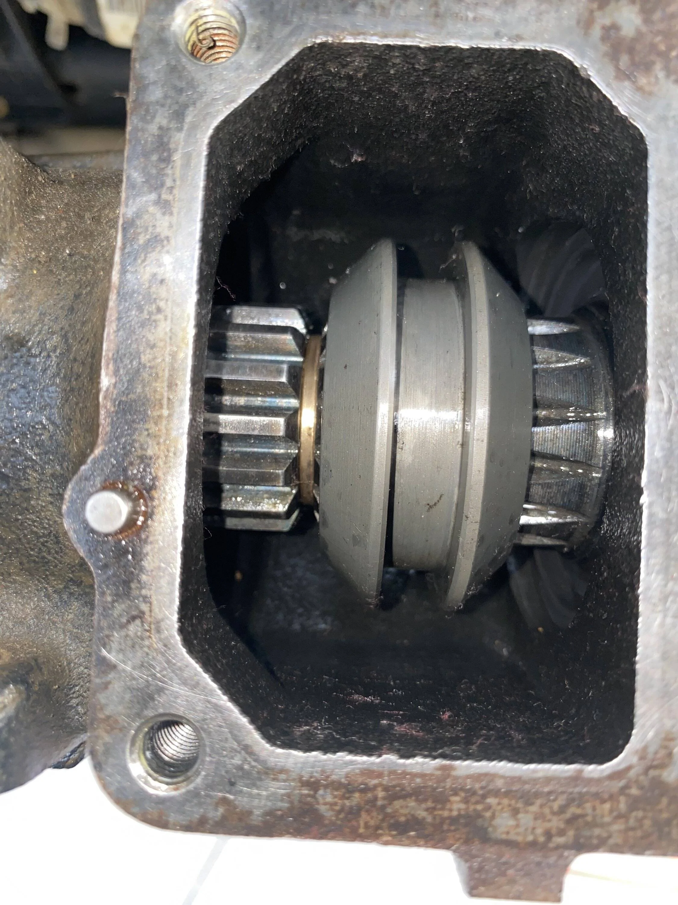

@melendez69, I would encourage you to open up the FAD so you can inspect the components in there, especially the plastic bushing. I’ve read reports of those disintegrating. You’re getting into a fairly advanced job. It would suck to find out after the fact that there is something wrong in there.

I put mine in4H prior to tackling this job, and the collar didn’t fully seat onto the inner shaft, so it fell off inside. So, I had to remove the FAD cover and slide the collar back onto the inner shaft. This allows you to put the passenger side outer shaft back in without issues.

To take the FAD cover off, there is a skid plate cover to remove. I believe they are 10mm bolts and three of them. Then the FAD cover itself is 4 bolts that are 13mm. Make sure to have a ton of rags below. A bunch of oil came out (more than I was expecting). But after watching the above video and help from the folks here, it was pretty easy to get the passenger side all back together.

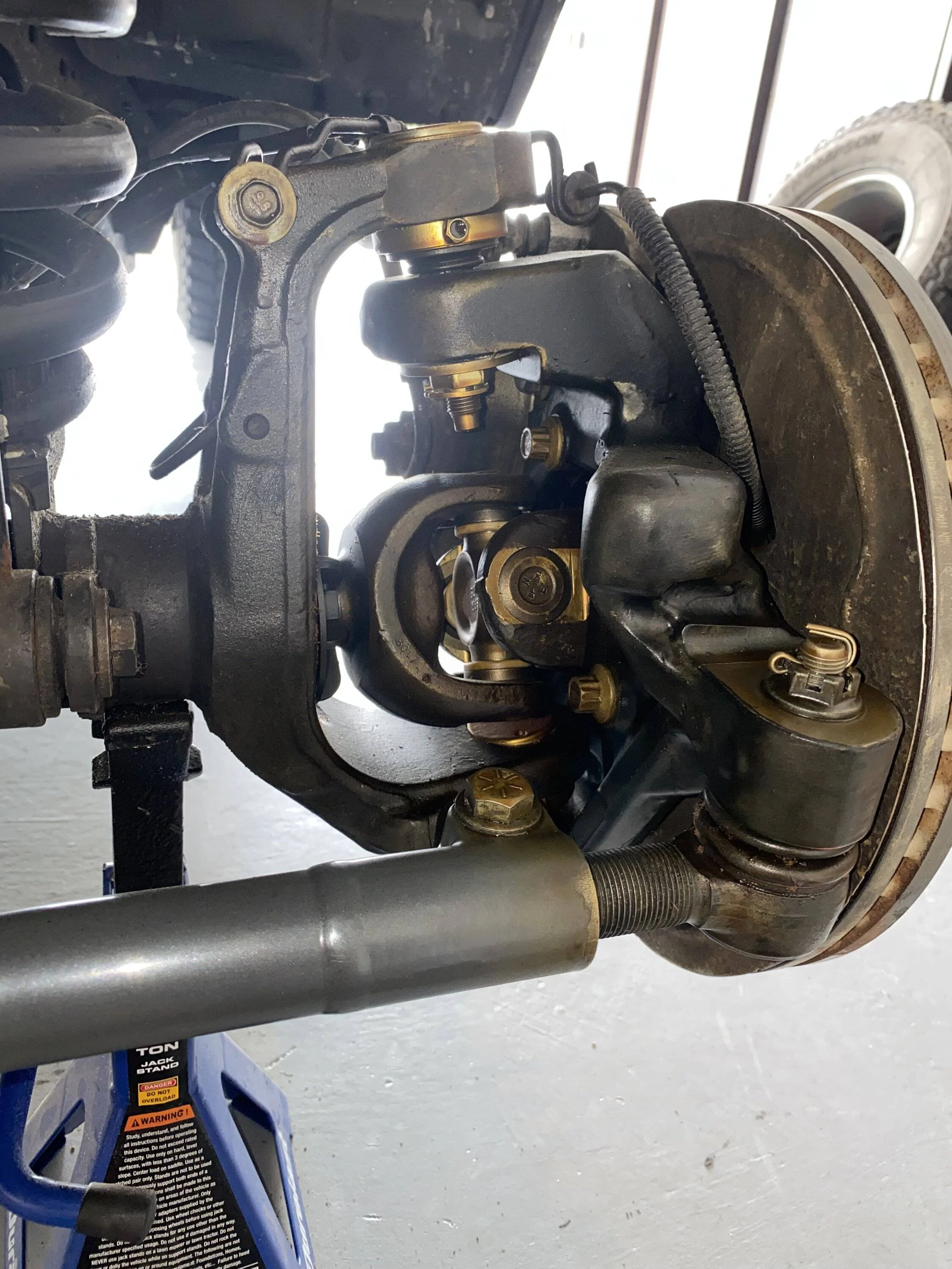

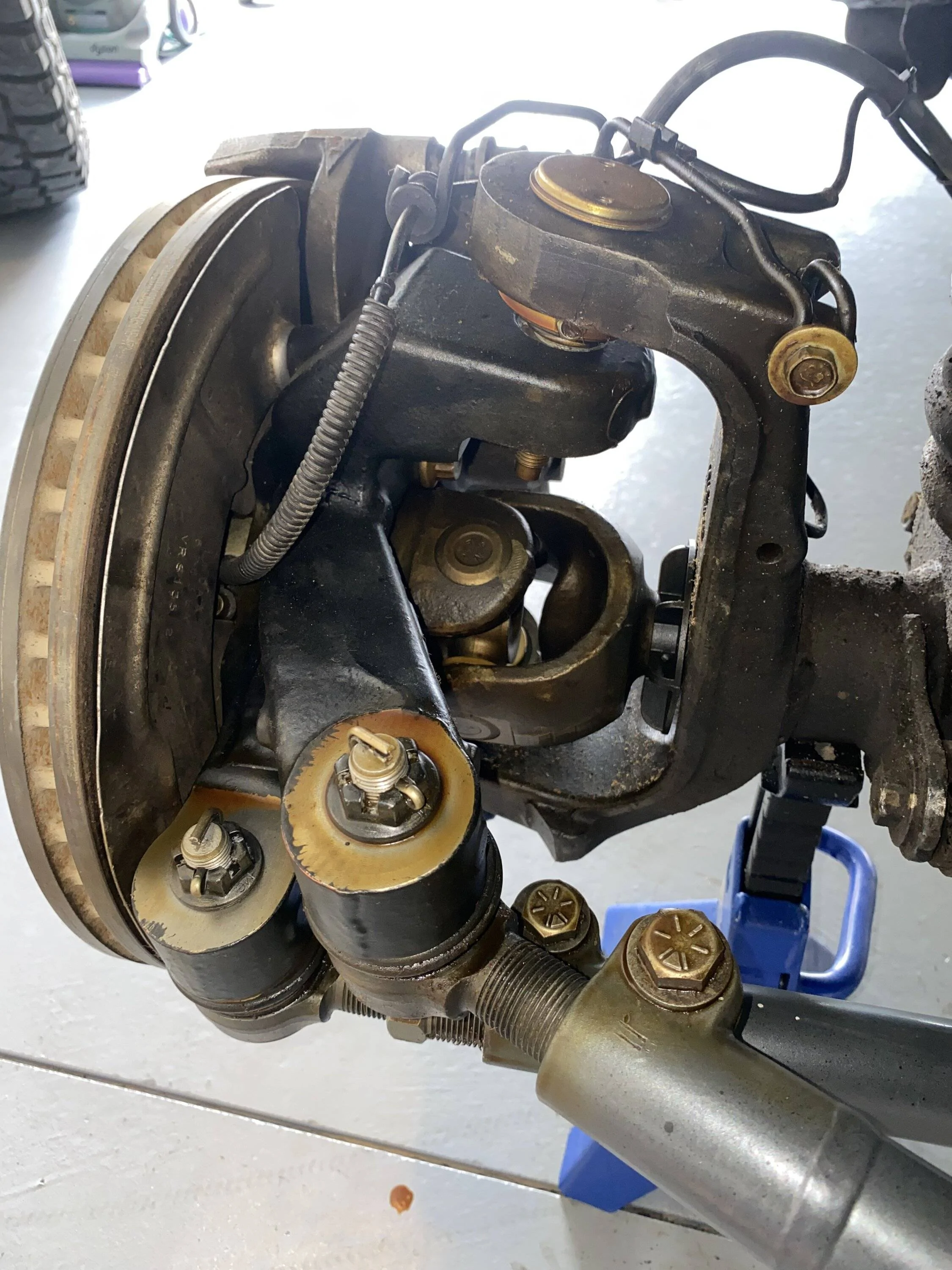

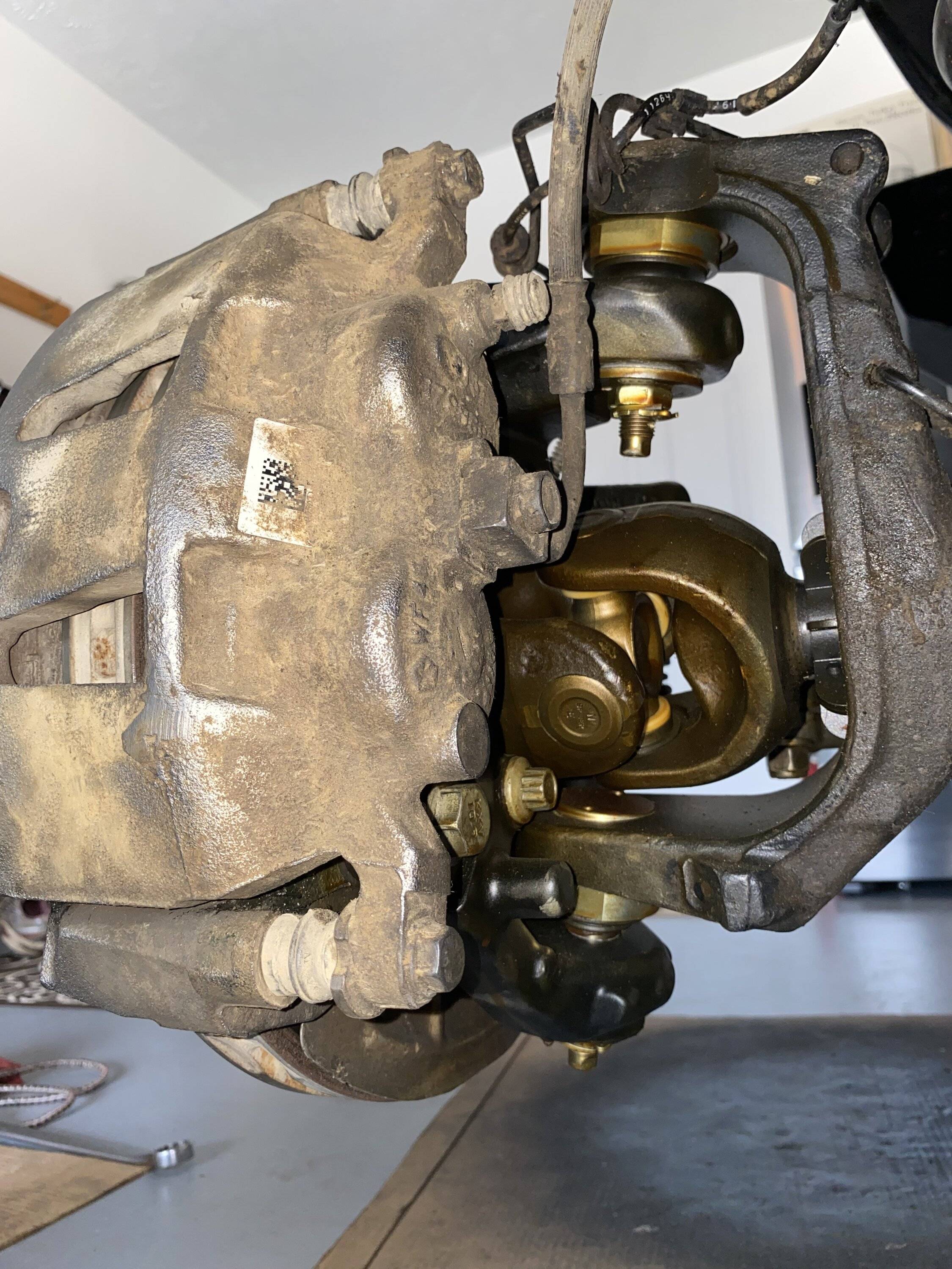

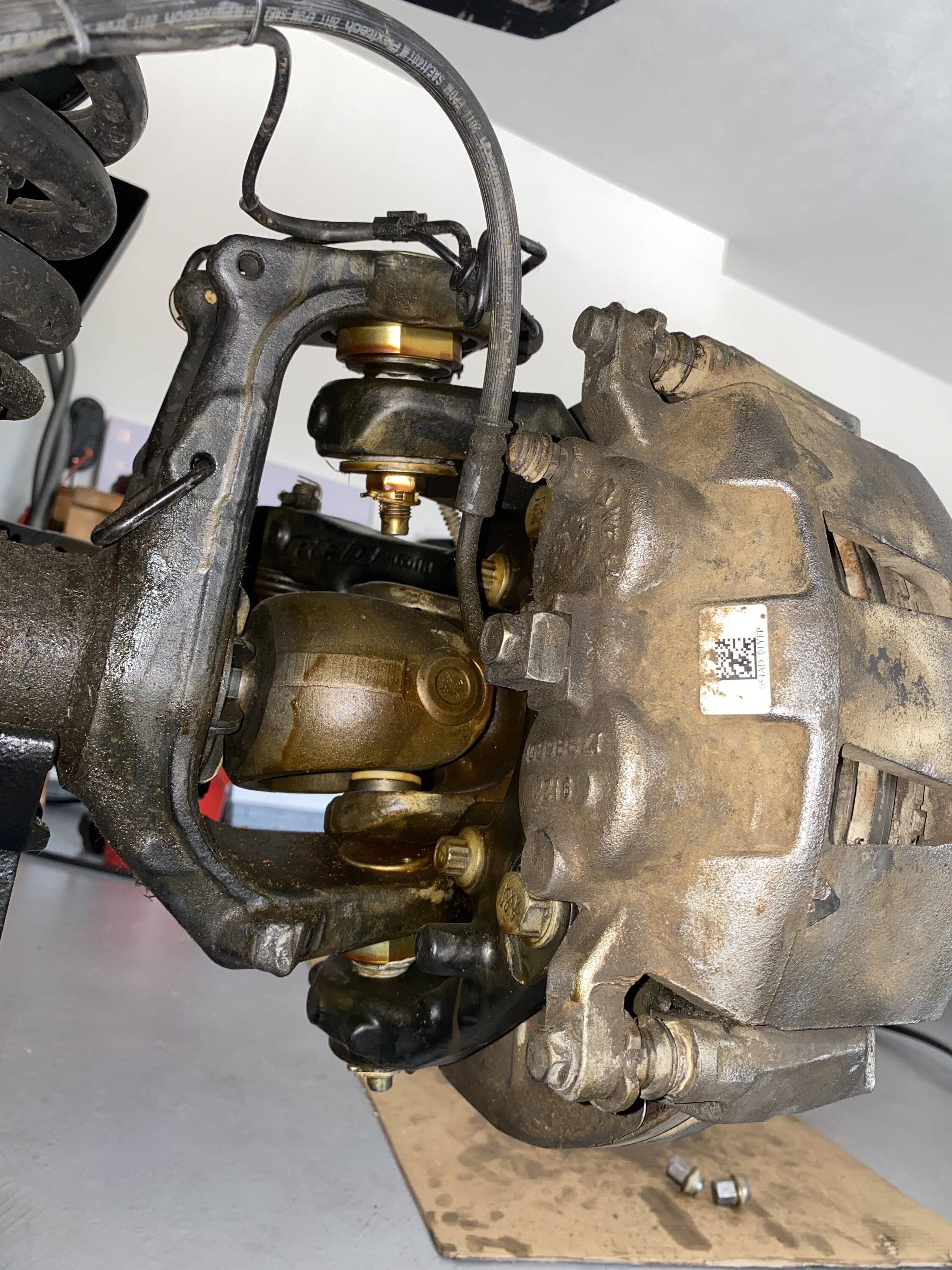

No video, but here are some pics of the finished product. As mentioned before, check the condition of your plastic bushing in between the shafts of the FAD. I upgraded the knuckles, ball joints, axle shafts, hub bearings and bushing for this mod.

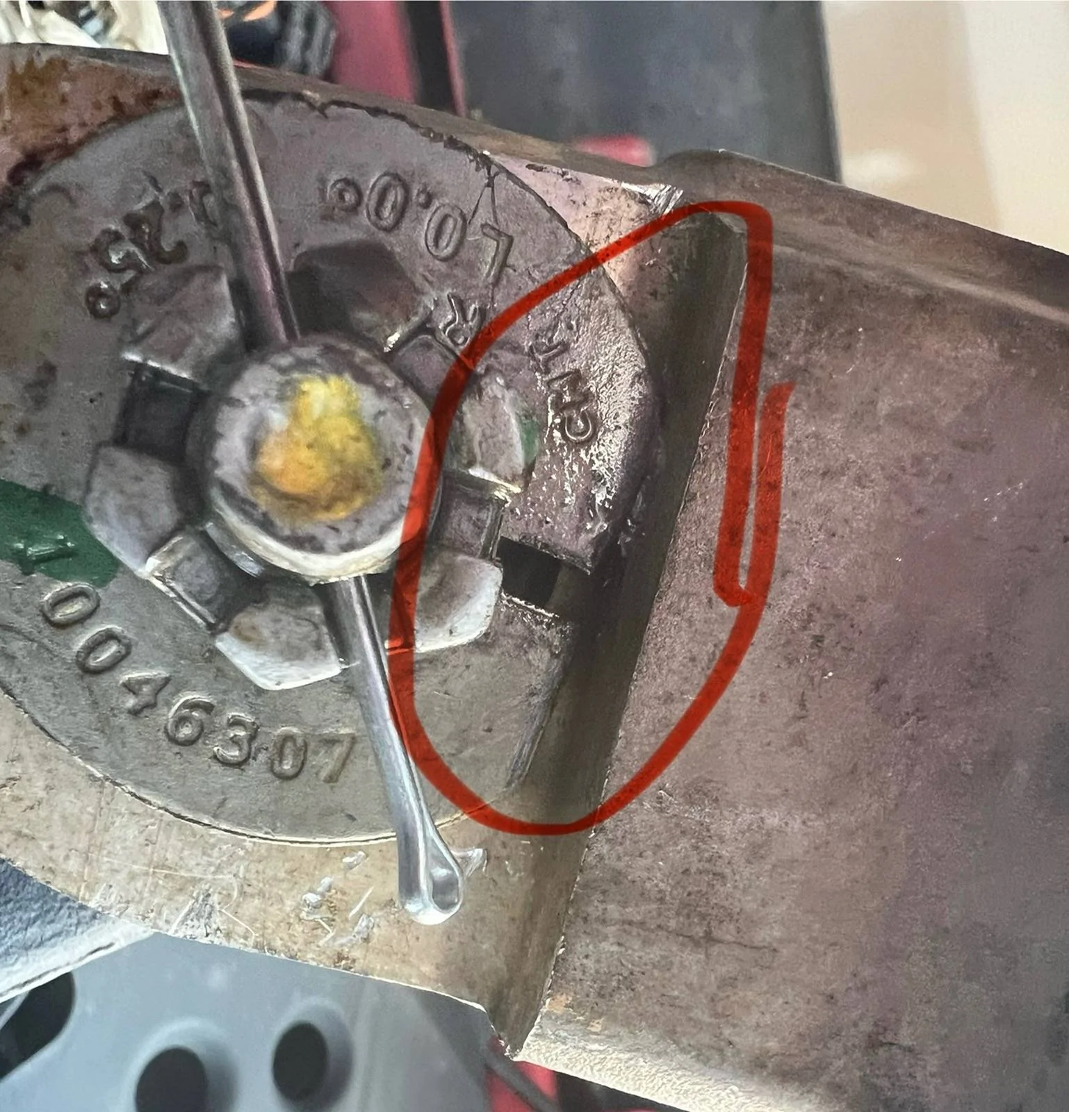

This slip joint looks a little gouged into the knuckle…. I’ve been trying to bang this f*cker out for an hour & the damn knuckle won’t drop. I’m on factory ball joints…. Have they been in too long or is the slip joint not being flush preventing it from falling?
