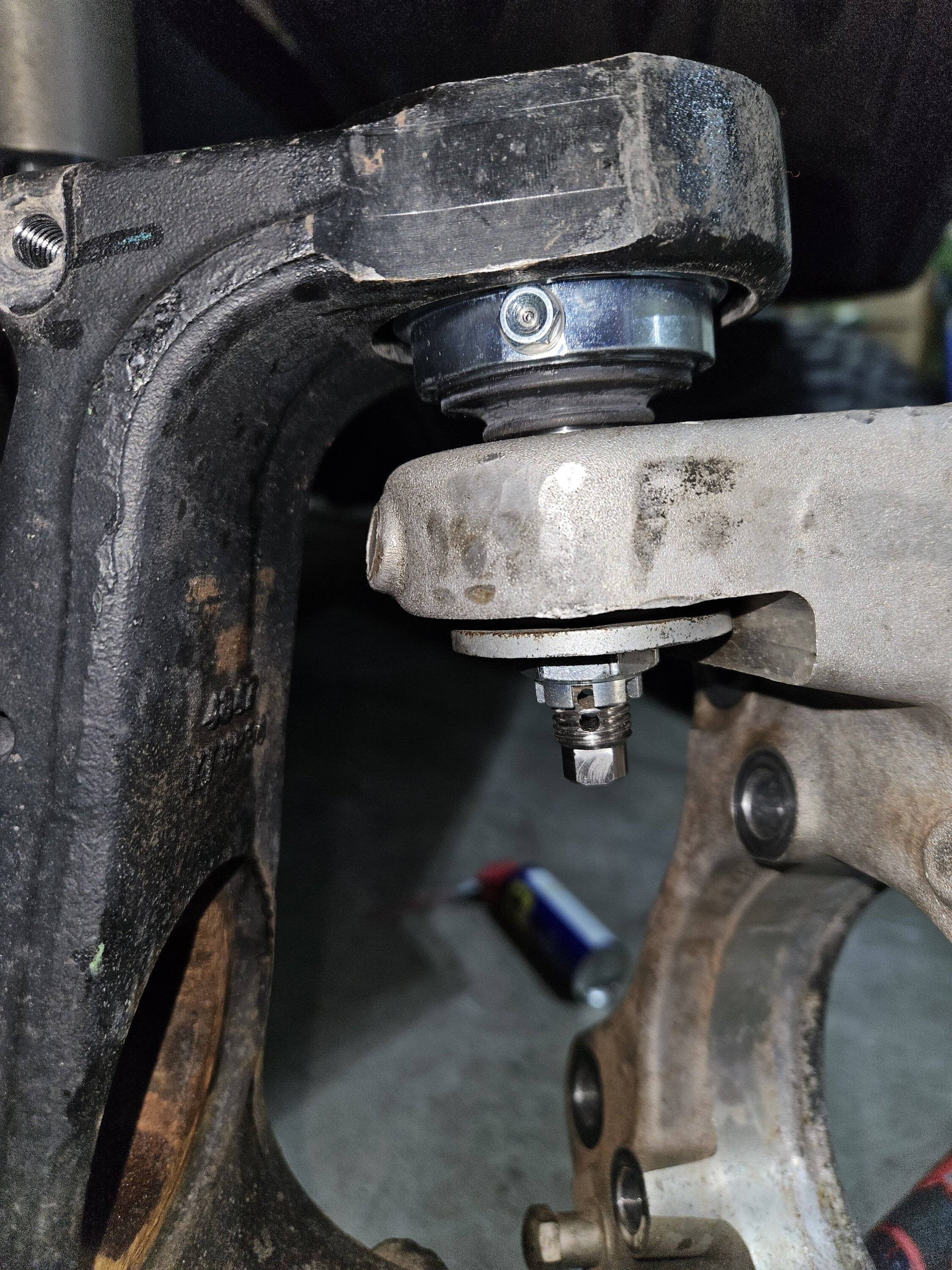

Install DT ball joints today. Got the ball joints and knuckle installed. Both upper and lower castle nuts are torqued to DT spec. The cotter pin holes line up. But I wasn't expecting such gaps between the knuckle and axle C. Take a look at Pic. Are those gaps normal? Also the snap ring is installed on the upper.

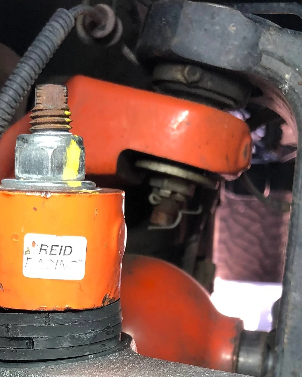

It’s right, mine are in Reid’s but still see a gap…

Thank you for confirming and for the quick response!!!
