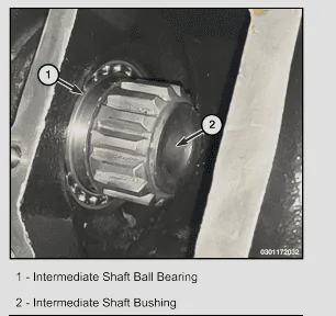

Thought there was still one seal on each side of the diff? I know there are intermediate shaft bearings out at the end of the FAD inner shaft.
No, to get oil into the FAD the seal is moved outboard of the FAD. That said, there's minimal oil in the FAD when opened, because it's just what has splashed side to side while the vehicle was in motion. The fill level isn't that high.
