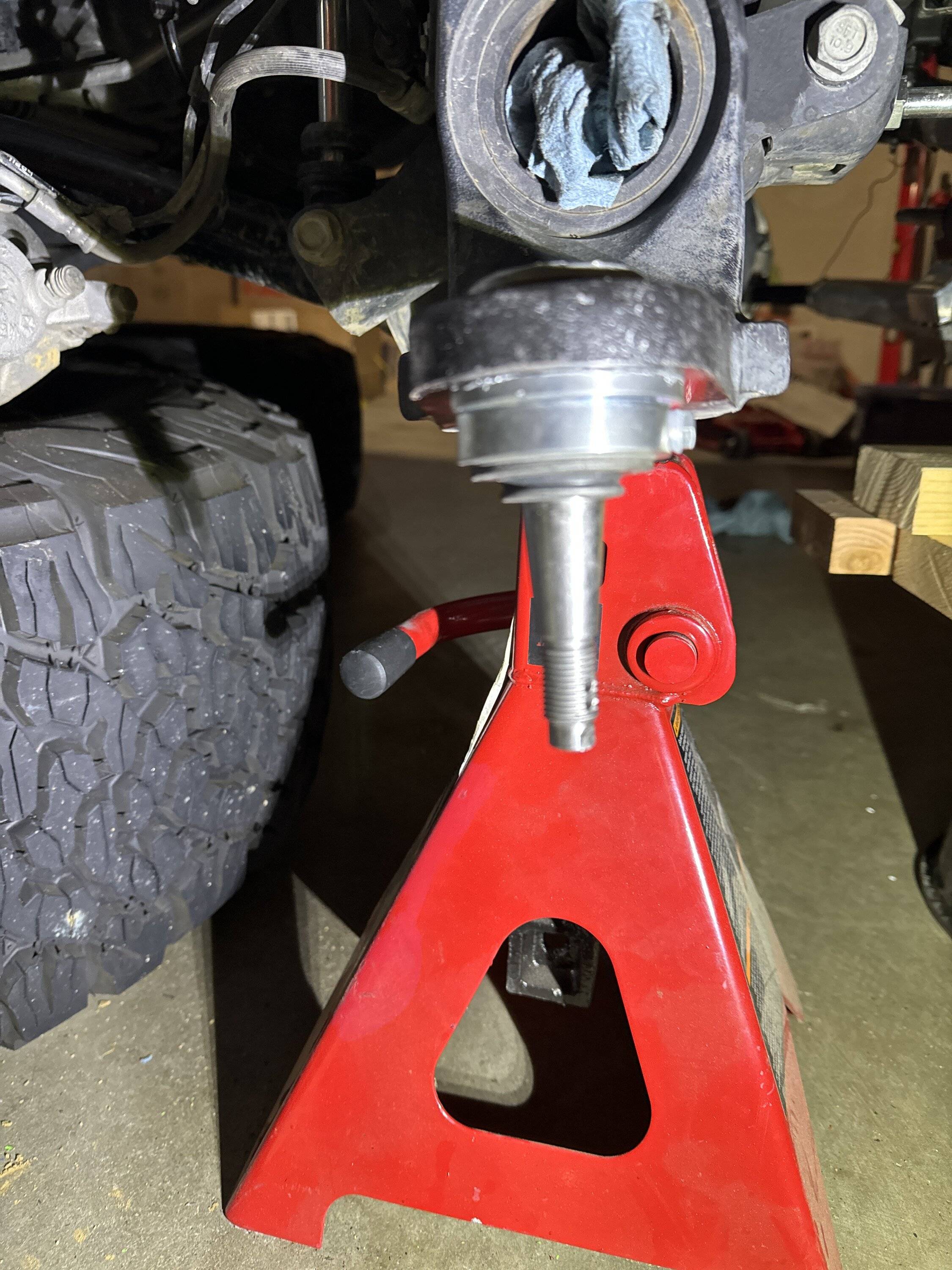

Update*
Well guys……how does it look? I’m pretty sure I got a bit stuck at the ridge inside the bore again. But with the frozen joints and knowing I cleaned it up a bit with the half round file, I just said f’it and cranked down a bit more on the ratchet. I felt a nice pop (which scared me at first that I broke something) but it smooth sailing getting the rest in from there. Took tips from just about everyone to get her in there. 3 more to go! Appreciate everyone’s help!
User name checks out! ?

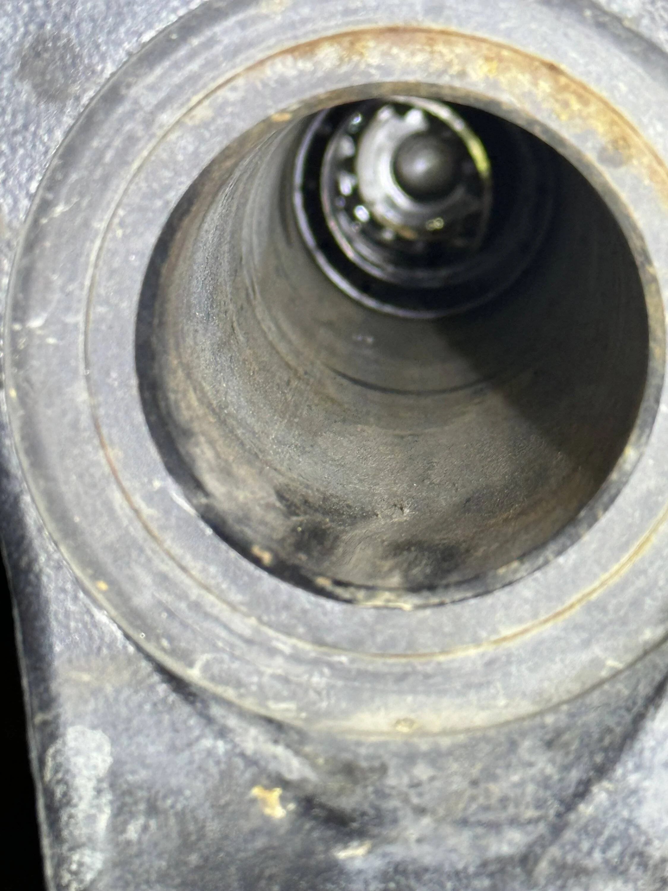

Howdy y’all,
Running into another issue and don’t want to send it on this one. So I read on several threads you can put the Jeep in 4H and it will keep some sort of collar attached to the inner rod, allowing me to extract the axle shaft on the passenger side without messing with the FAD. Well, I’m trying to put the axle shaft back in, but I can’t get it to seat all the way back inside. Upon looking into the axle tube, it seems like the collar is slightly shifted to the left, causing the opening the outer axle shaft goes into is closed off a bit. Do I need to open the FAD to push the collar back just a tad to allow the axle shaft to slide back in all the way? Or do I just angle the axle shaft to the right to allow it to go sort of “around” the collar.
Picture below to help explain the issue:

Jubi351
Jarrod
Apr 2, 2021
76
97
Lincolnton, NC
2019 JLUS
You are going to need to remove the FAD so you can put the collar back on. If you had put the Jeep in 4wd before shutting it off it would of slid the collar over the inner shaft and stayed in place. No big deal, just take care not to tear the gasket when removing. You're almost there!
Remorseless
May 10, 2022
34,653
193,898
NC
Howdy y’all,
I think you're going to end up opening up the FAD. Collar's supposed to stay seated on the inner shaft, yours did not.
The Jeep is in 4H right now! That’s why I’m confused right now.

Shoot. Any reason why it didn’t stay seated when switching into 4H?
Not sure, collar would've needed to have been only partially engaged on the inner shaft to end up like yours is. Did you give the wheels a spin to make sure 4H was fully engaged? Might've needed a bit of a spin to make sure the collar splines lined up maybe?
