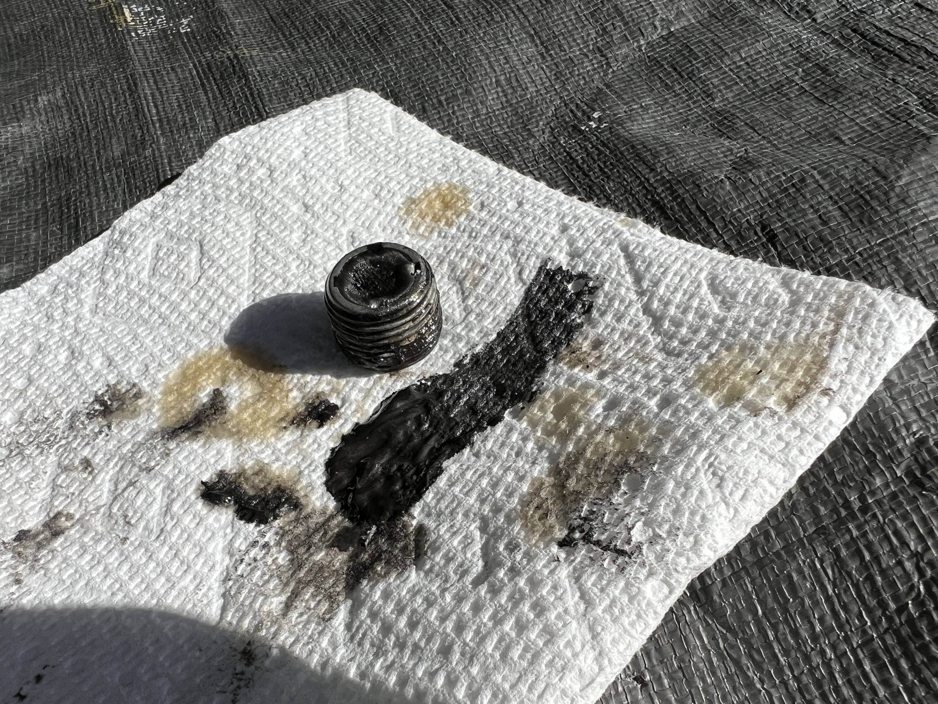

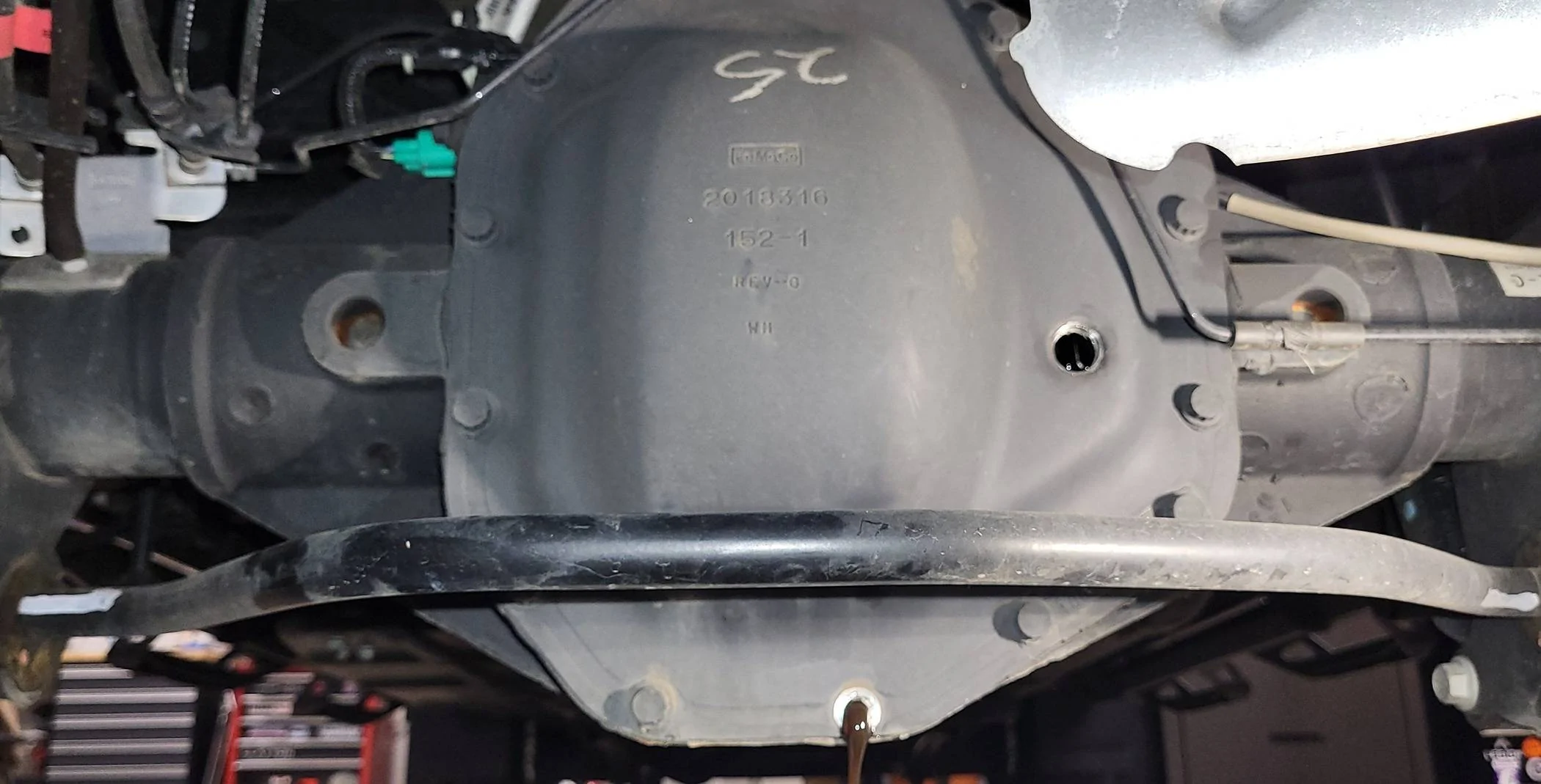

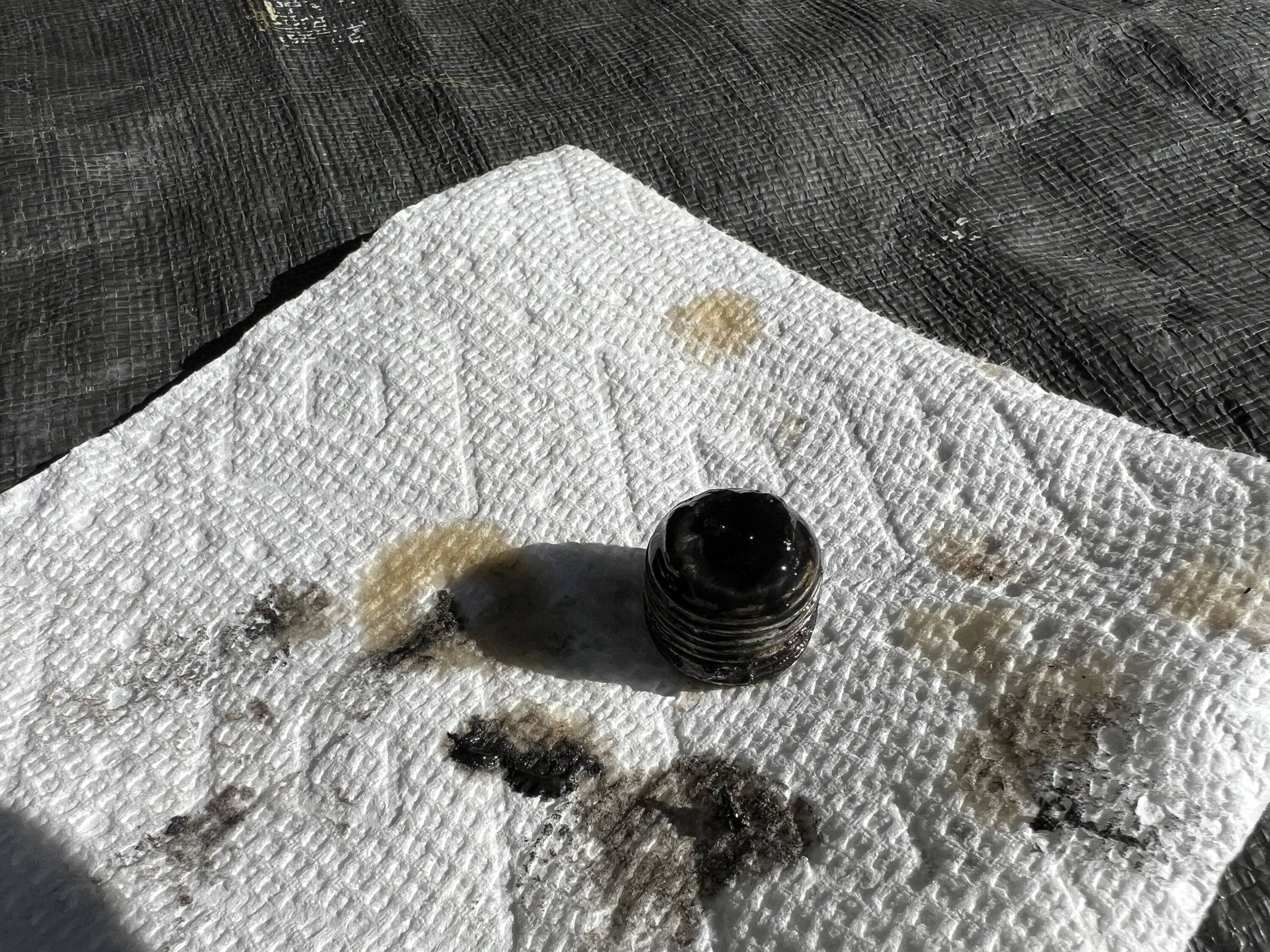

Just change diff fluids front and rear on our 2021 JLUR V6, 6 speed MT. 45,000 miles. Plenty of overlanding/off road heavily loaded. Significant use of 4WL and light use of lockers. Only use them when I feel they are necessary.
I used the flex bags off Valvoline full synthetic (2) 75W-140 rear with (1) 75W-90 front. Topping off the front with the left over from the rear. Easy change.
No sign of any metal. Some sludge on the magnet cup. Fluid still looked pretty good. Dark for sure but still a little amber.
