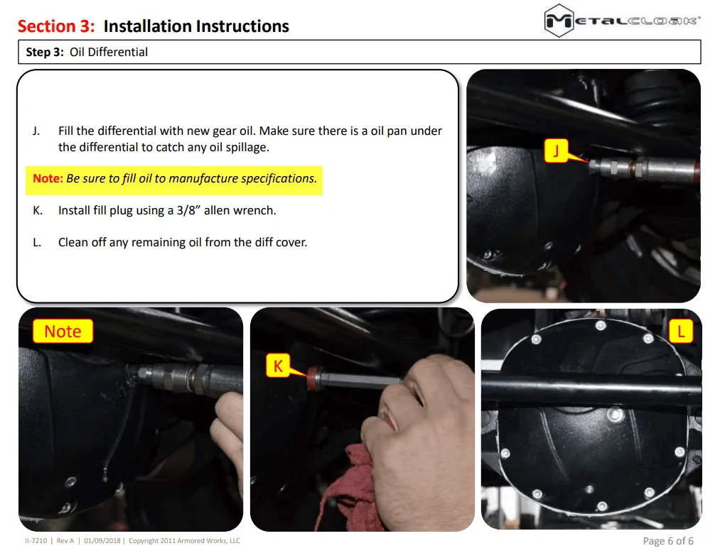

Different covers require different amount of fluids, if you have aftermarket covers from MC you have to go by the requirement set by MC and not by Jeep.
But generally speaking, you fill until fluid starts flowing out of the fill hole. And that should be the correct amount. I wouldn’t go by the numbers listed on spec sheets because there are sometimes residual oil left in the axles so you end up overfilling slightly anyways.
I want to agree because it would make life a lot easier, but Metalcloak states to fill to manufacture spec.
Interesting, thanks for looking it up!
I wonder if their fill hole is in the right position.
It is not. I had another post asking similar. The MC rear cover takes 2 qts and the front about 1.5. Can it harm anything having too much?

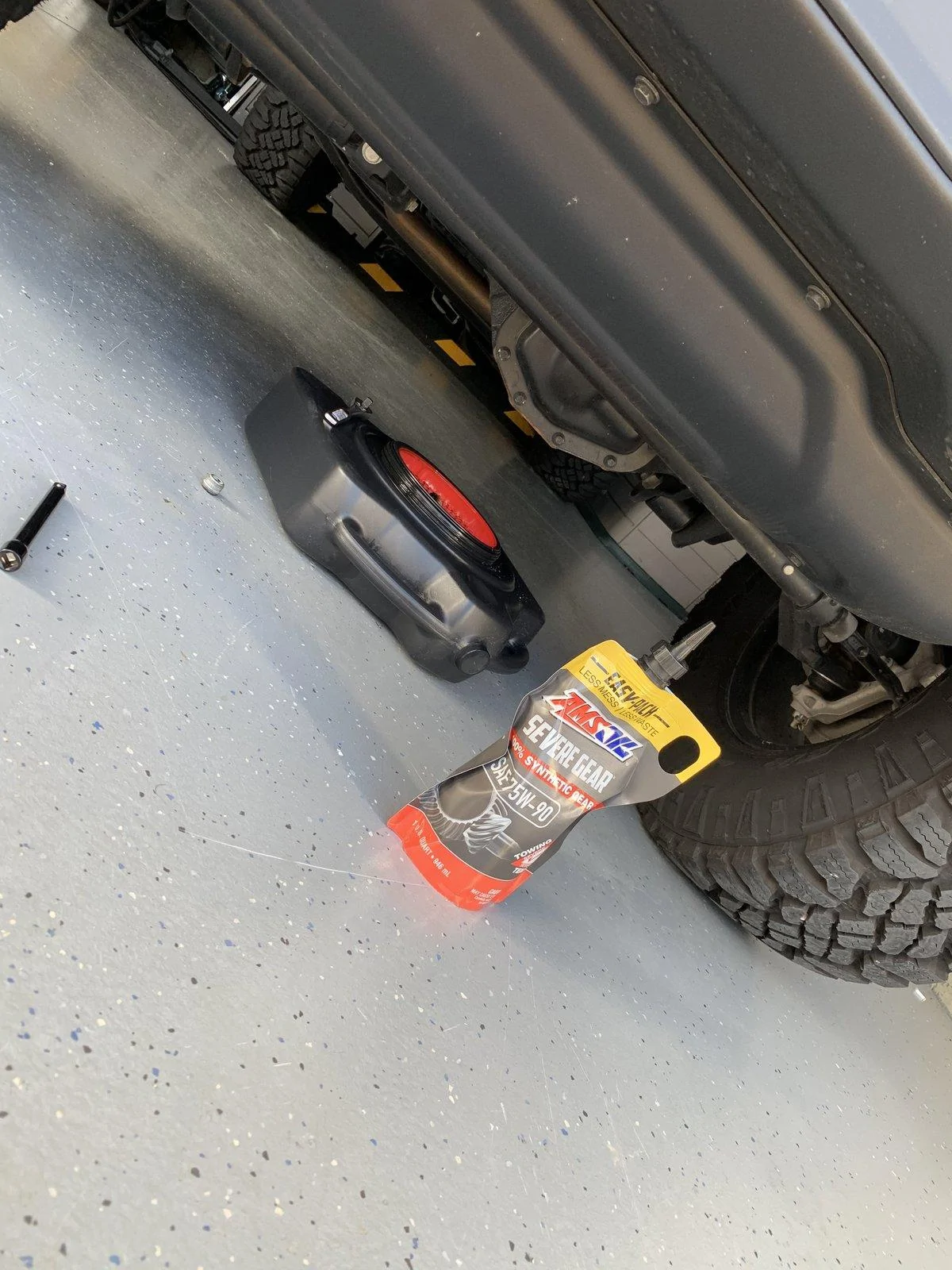

No need to remove the Diff covers for this simple fluid swap. Utilize the drain plugs. I recommend using some Thread Tape when reinstalling the drain plugs.
IMO — dump the factory stuff at 2k mis. Then swap again at 20k, then every 20k following (obviously full synthetic)
