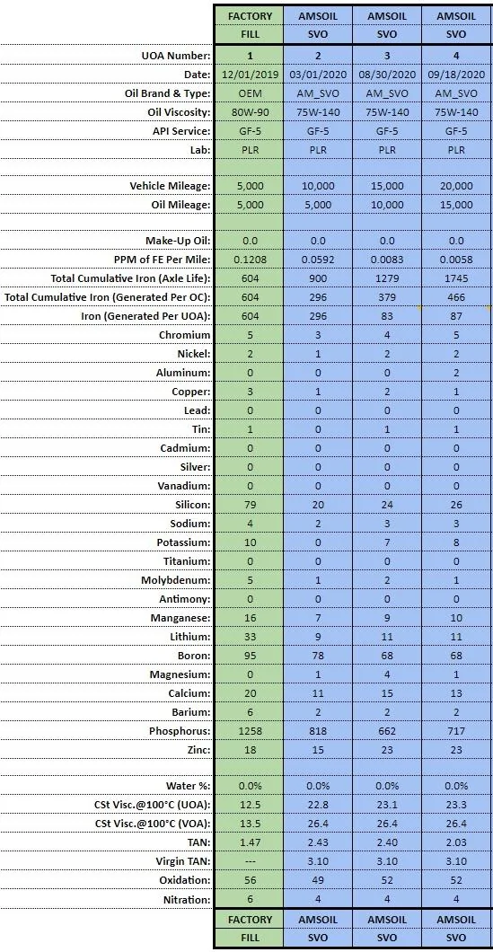

IMO — dump the factory stuff at 2k mis. Then swap again at 20k, then every 20k following (obviously full synthetic)
I would pull the covers on the initial OC if for nothing else but to inspect everything. I do it to also clean out any "goo" which collects at the bottom of the housing. Both of my axles had rubber coated metal gaskets which were reusable.

Based upon the metal that I had in mine, I would change it. The vast majority of axle wear occurs at 15K or less miles.
