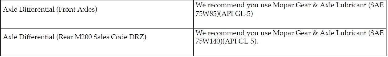

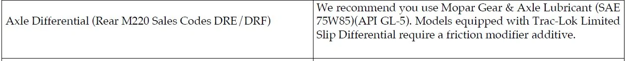

Per my 2019 Owners Manual, It looks like you need 75w-140...
No idea why the Limited Slip still calls for 75w-85 though.
Hello,
Thank you for all of the great info. I guess I am a bit confused as there seems to be a few different sources with different info. I have a 2018 JLU that has a Dana 186 in the front and a Dana 220 in the rear. What number lubricant would I need? Thank you!

Lots of good info on the forum regarding diff gear oil change. Search and read read...
Do read through this whole thread, especially..
https://www.jlwranglerforums.com/forum/threads/differential-oil-change.47318/
Best bet is to not buy Mopar branded gear oil, especially from the stealership as it is way overpriced. Do not buy the additive there either. Do not let them do the actual gear oil change either.
Do know though that both Valvoline and Royal Purple have the necessary additive in them....
For someone's JL that needs additive they can use those... if the JL does not not need additive then having the additive does no harm.
Anyway, just use Valvoline or Royal Purple on any stock JL/JLU (whether additive is needed or not) and you are aok.
As for gear oil weight to use.... you use Valvoline or Royal Purple 75w90 Syn. Gear Oil in the front and rear.
IF, if you are towing (have tow package) use Valvoline or Royal Purple 75w140 Syn. Gear Oil in the rear...
