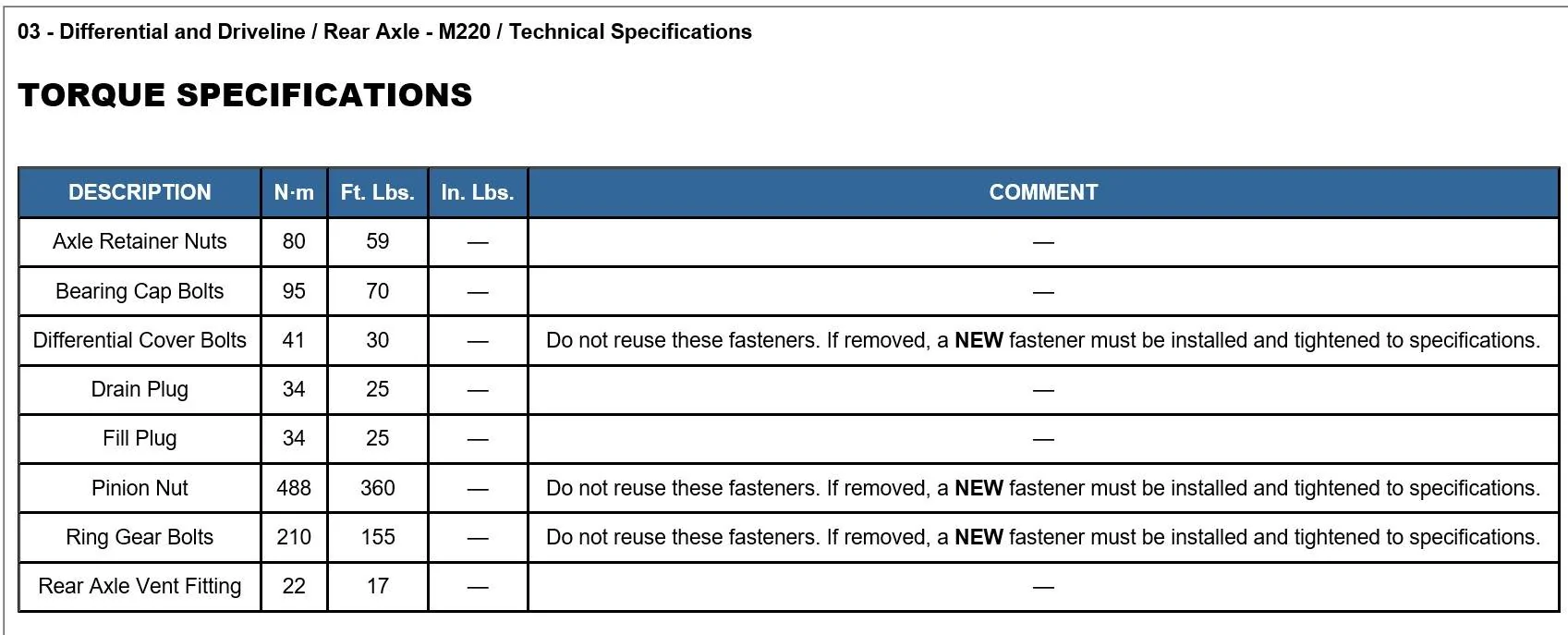

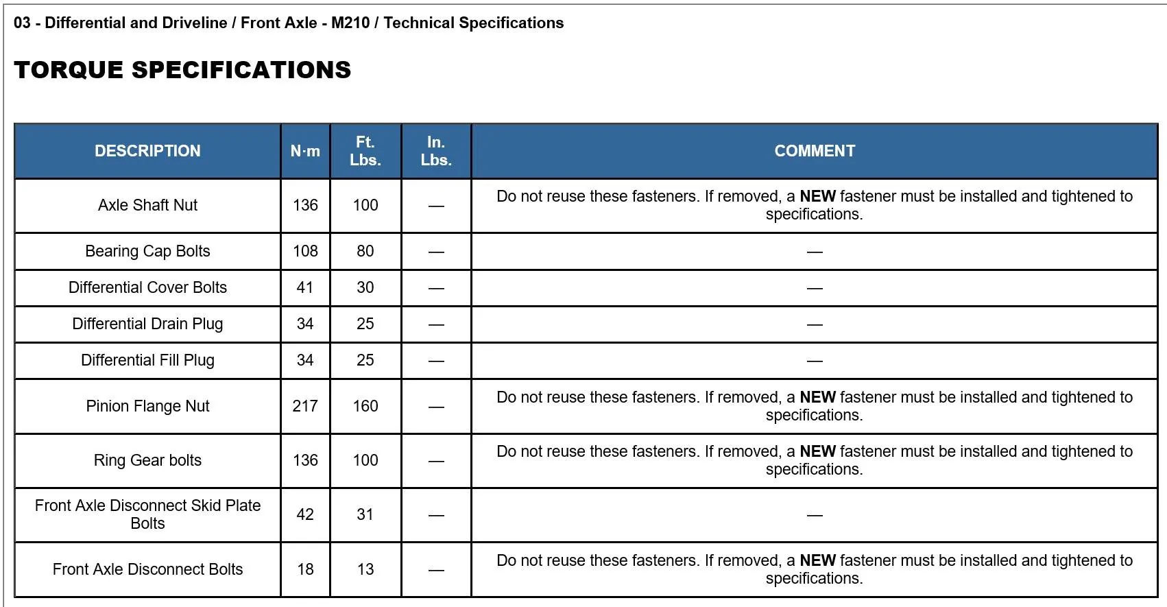

So, I was curious as to this "replace the bolts" thing with the cover bolts. So, the tables below are from my Tech Authority Service Manual (OEM).
Indeed the rear M220 torque specs show that the bolts should be replaced after one use. Clearly it's an error. The front M210 torque specs don't require replacing the bolts, and these bolts are not structural, nor do they require being torqued to 30 ft lbs with the reusable rubber gasket. You would simply destroy the gasket.
So yeah, everything Jeep publishes isn't gospel, nor necessarily correct. I suspect the 30 ft/lbs was correct for a paper gasket like the earlier jeep used.

for the front, the manual states 15ft lbs, then 20 degrees more. isn't that tty?
for the rear, the manual states 30ft lbs with NEW bolts.
now this is from 2021 since there doesn't seem to be one for newer wrangler/gladiators.
the front scares me because some of those bolts are hard to get to and breaking one off and extracting would be difficult or impossible without removing susp parts. That's a pandoras box.
sorry, forgot the tables
yes, this hasn't changed since 2021 at least.
this is what bugs me. trying to figure out what "good enough" is for the bolts. Error one way you get a leak. the other, you snap a bolt.
i hear you on the "Indeed the rear M220 torque specs show that the bolts should be replaced after one use. Clearly it's an error" part, but why is it clear that it's an error?
the front is 15 ft lbs and then 20 degrees more oomph.so id guess that is around 20 ft lbs or so. i don't have an angle torque wrench. i'd say i know what 45 is and 20 is a hair less than half of that. I'd probably either buy an angle torque wrench or just go 15 ftlbs and a hair more.
