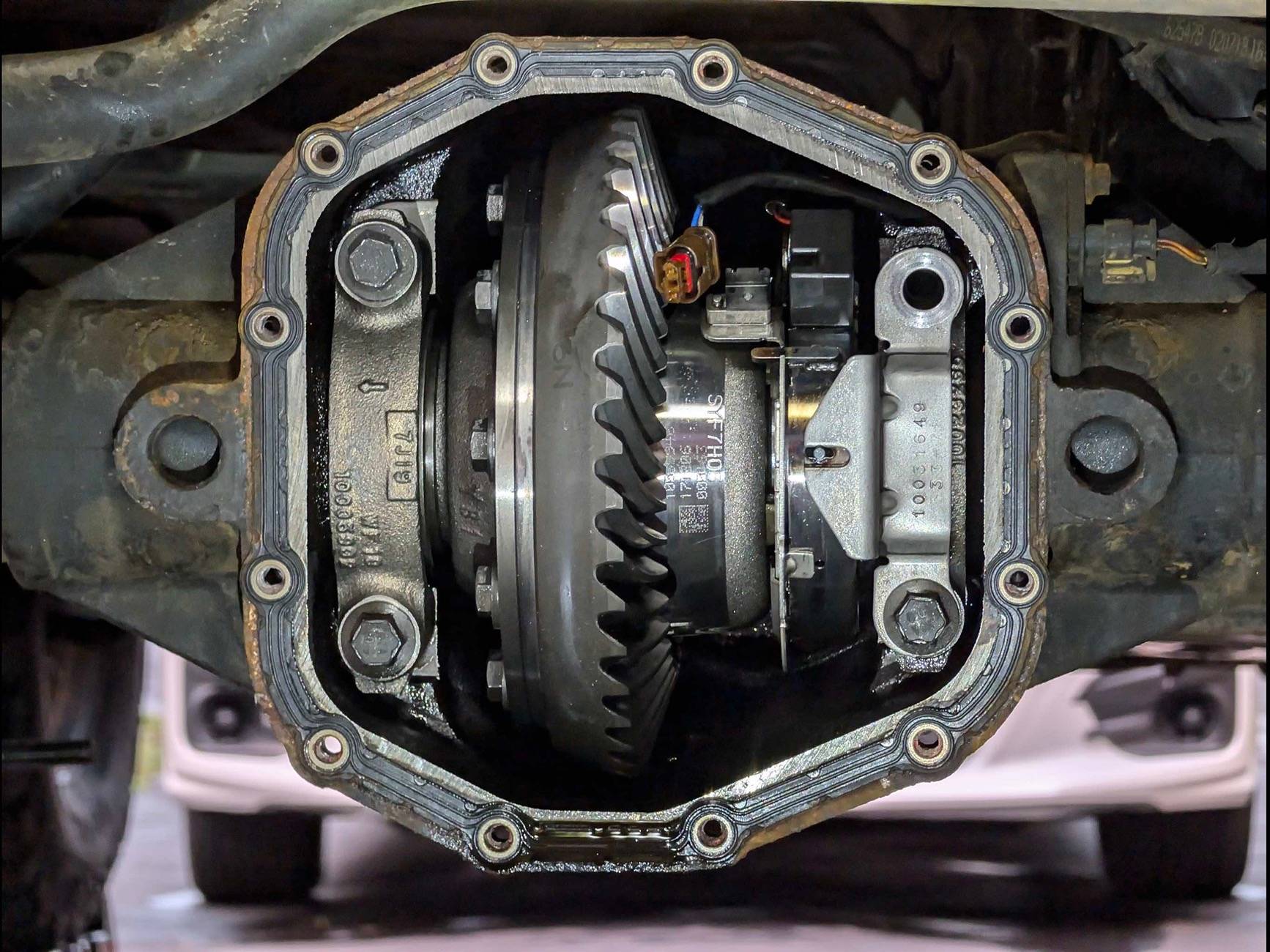

You mentioned earlier that you are scared. No need to be scared. Just be careful to crack each bolt off by hand to minimize torque. Front and rear single use. If super concerned just buy new bolts.
When I removed the OEM bolts to pot the locker sensors - the bolts surprisingly seemed on much tighter than the expected for 20 and 30.
Did the front first by jacking up the frame to get clear access. Loosened each bolt by cracking off the initial OEM tightening bite by hand to make sure nothing snapped. Then removed the rest of the way by hand which took way longer than expected. The bolts were very "sticky" and gummed up in the threads. This slowed progress a lot.
The rear also jacked up the frame to get clear access. Loosened each bolt by cracking off the initial OEM tightening bite by hand to make sure nothing snapped. Then removed the rest of the way with an impact gun. This speeded up the process tremendously.
Cleaned off the bolt threads before re-installing them - and they all went back in smoothly and easily.
Do not recall exactly but think tightened to an estimated 20 for front and 20 for rear. Thinking was to see if 20 was plenty and it was. The reusable gasket was stuck to the axle housing so just left it there. As did not want to mess with the leak free orientation. Thought was - could always tighten the rear more if any drips appeared. But none have.
Followed the recommended bolt tightening pattern and all is good. Gasket sealed perfectly.

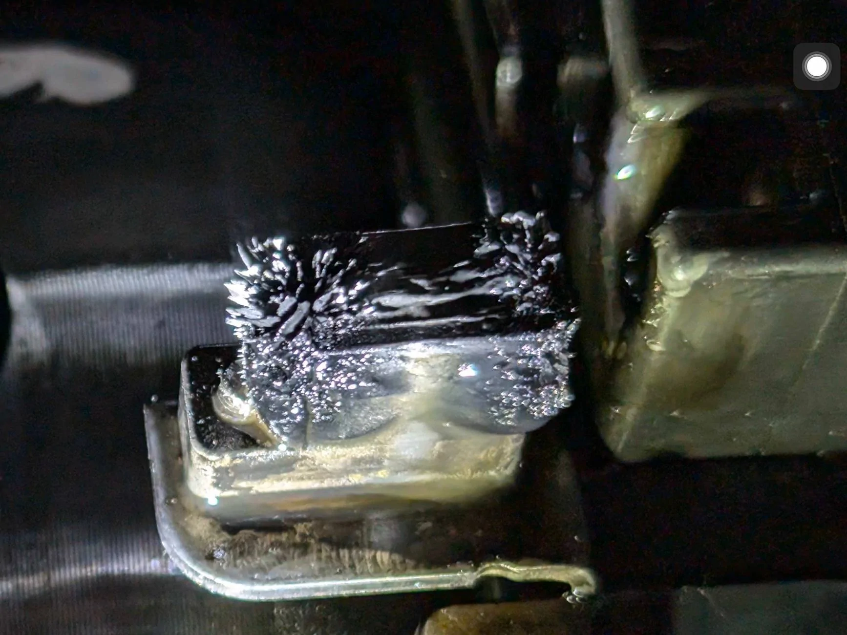

Used the same bolts in the same holes. They seemed not tight at 20 but are plenty tight. Expect removal to be a snap whenever the covers need to come off again. As a real maintenance item is to clean off the metal shaving fragments off the locker sensor and base housing.
If your lockers do not engage the instant you push. Would check for metal stuck to the magnets.
Is not as simple as draining your engine oil as you have to fill lying on the ground. Otherwise would recommend pulling off the covers to see the status inside and clean away metal stuck to the magnets. Cover takes a lot longer by hand the first time - so use a gun after cracking. Second time should be very easy.

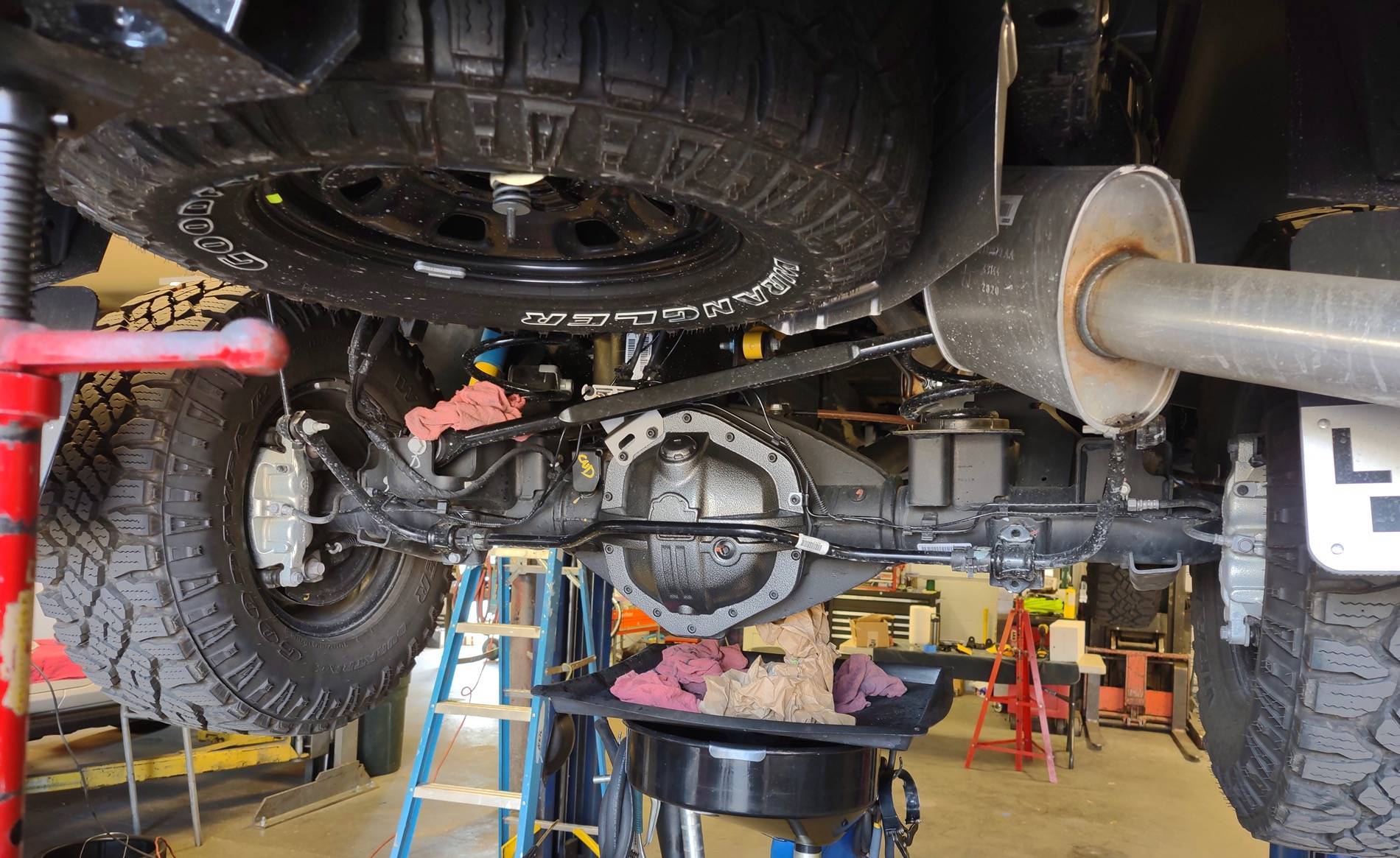

I went with Amsoil Severe Gear 75w140 in the rear and 75w110 in the front (and the balance of the second pack of 75w140)
3 quarts was exactly the right amount...
Jeep Wrangler JL Differential oil change Diff

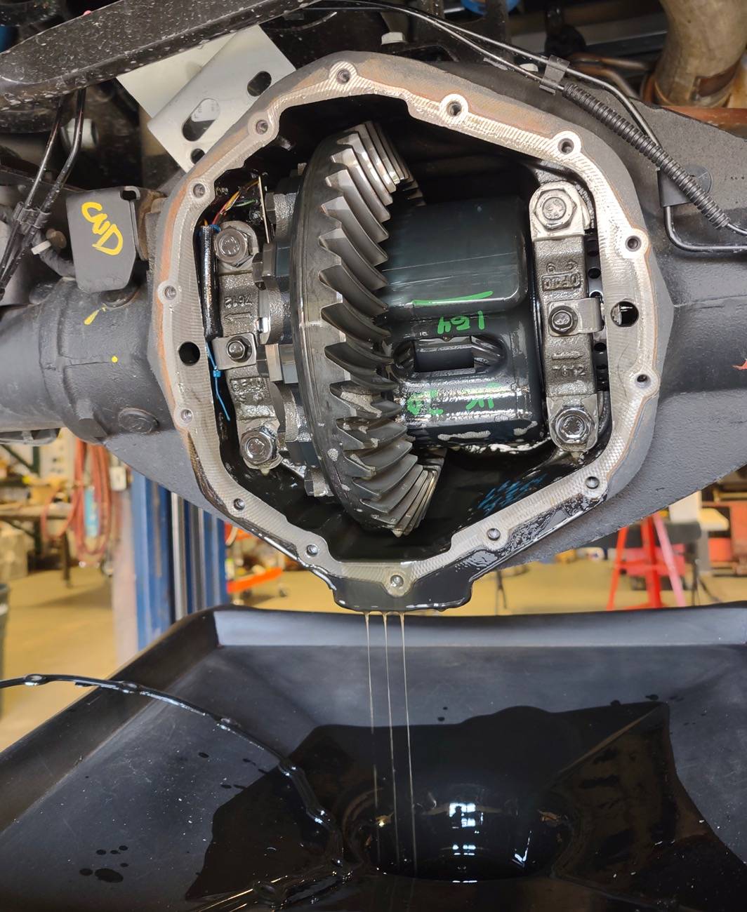

Pic of front, got about 30 oz out
Jeep Wrangler JL Differential oil change 1748733661955-34
