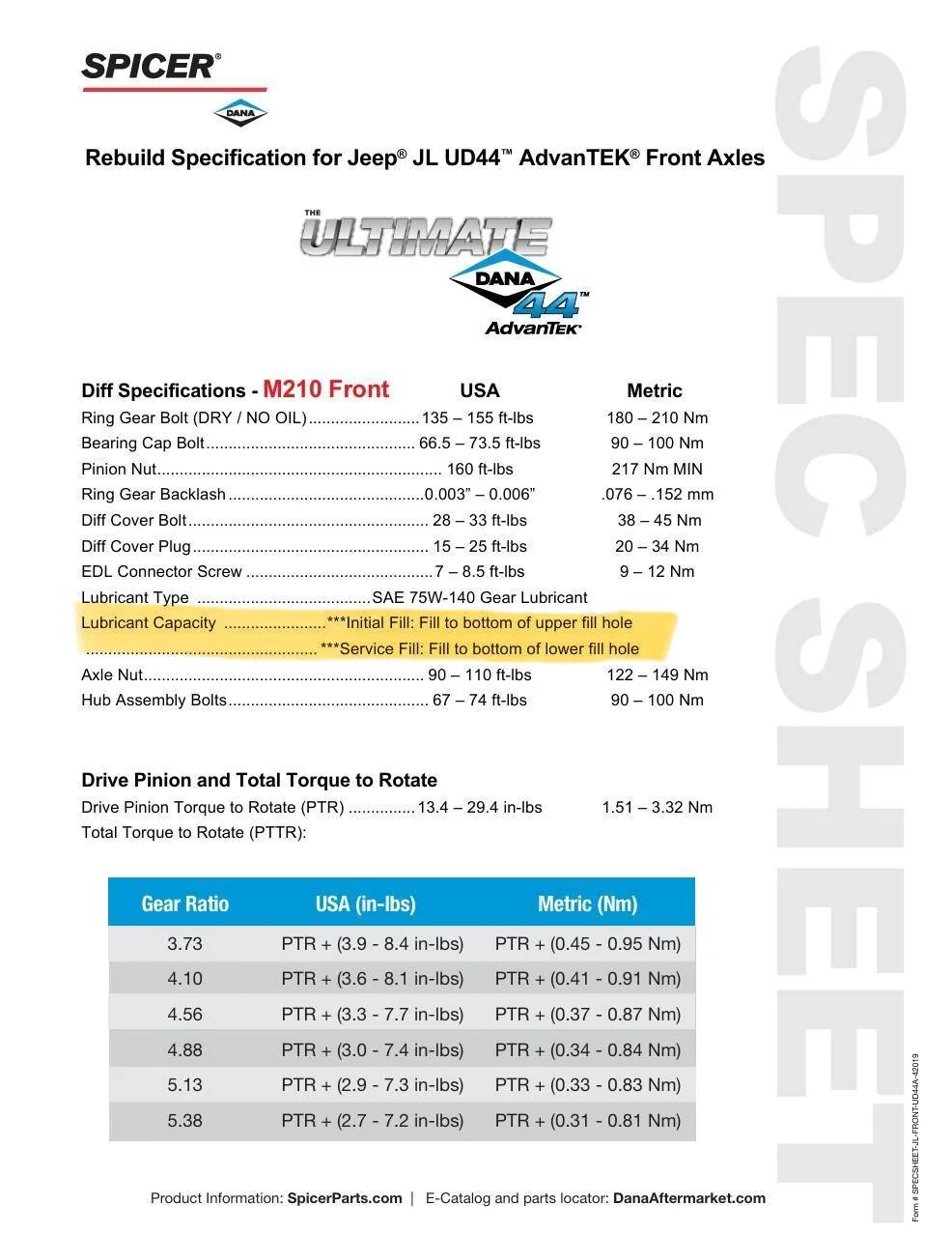

I find the highlighted lines confusing…
Do you start with a higher quantity of diff fluid from the factory/axle-install, then later (having drained all the gear oil after requisite # of miles or post-submerging the diff) refill with a lesser quantity going forward?
Does the rear diff have the same more-initially, less-later fill instruction?
Jeep Wrangler JL Differential oil change IMG_3584
I have 3 quarts ready for the weekend so I’d like to get this sorted out.
TIA

Mine took exactly 3 quarts...
1 2/3 in the rear and 1 1/3 in the front...
