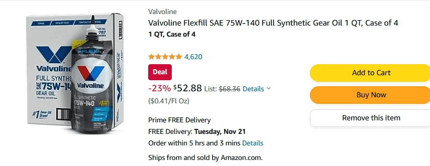

Wow ! Right now case of 4
Valvoline Flexfill 75W-140 for $52.88 that's $13.22 ea.
11/17/23 7pm EST
Go HERE.
Great find!

pity they don’t have this deal on the non-Synthetic; Eaton doesn’t recommend Synthetic for the TruTrac, so i just use Dino juice in both pumpkins.
