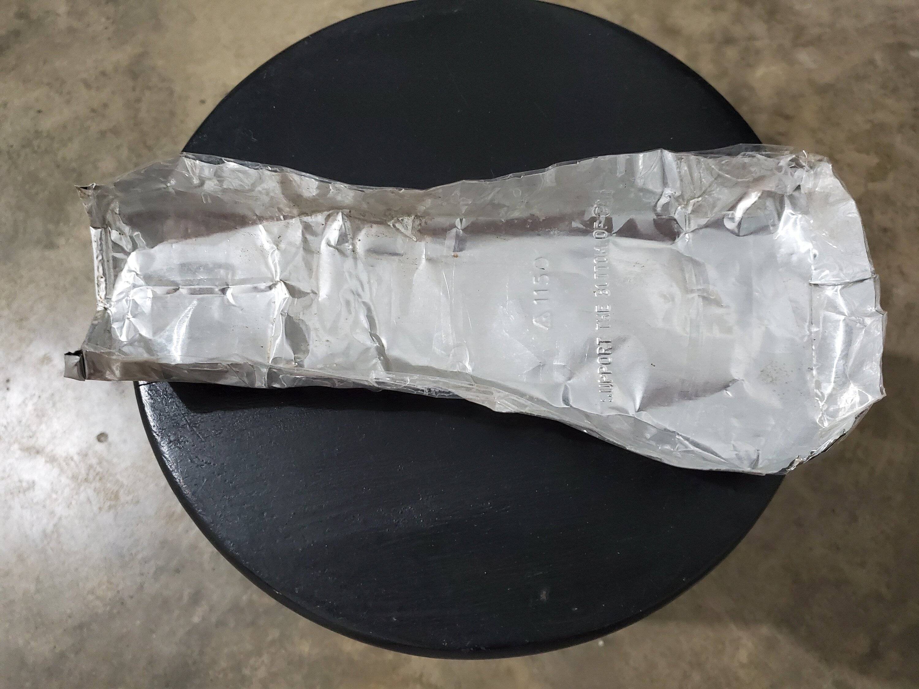

Ok, what's this on top of the black stool. ...Why is it a plus for your next bit of maintenance on your JL/JT?
Jeep Wrangler JL Differential oil change 20210115_193745
