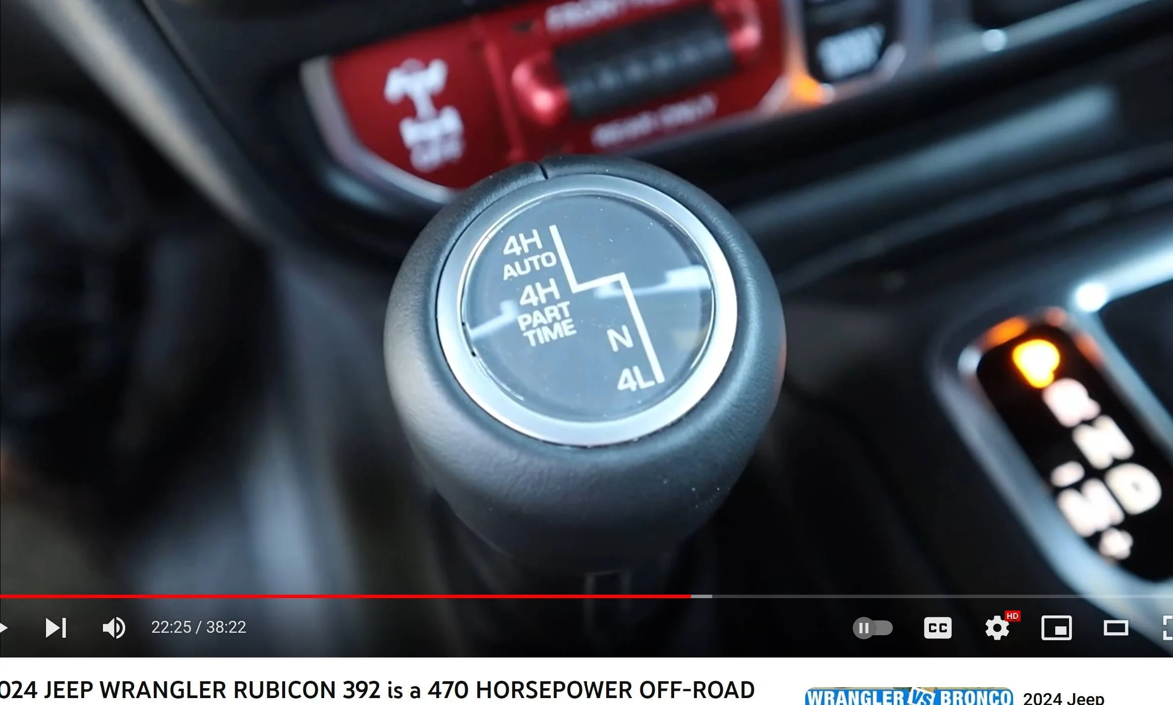

Note, however, that you can get a Tazer and enable 2H with the 392.
You're the second person who has said this. I can check into it to educate myself but my first thought is how I would shift into 2H given the pattern portrayed on the shift knob itself:
Jeep Wrangler JL Difference between 2H and 4H AUTO on dry roads? 2024 Rubicon 392 shift kno
