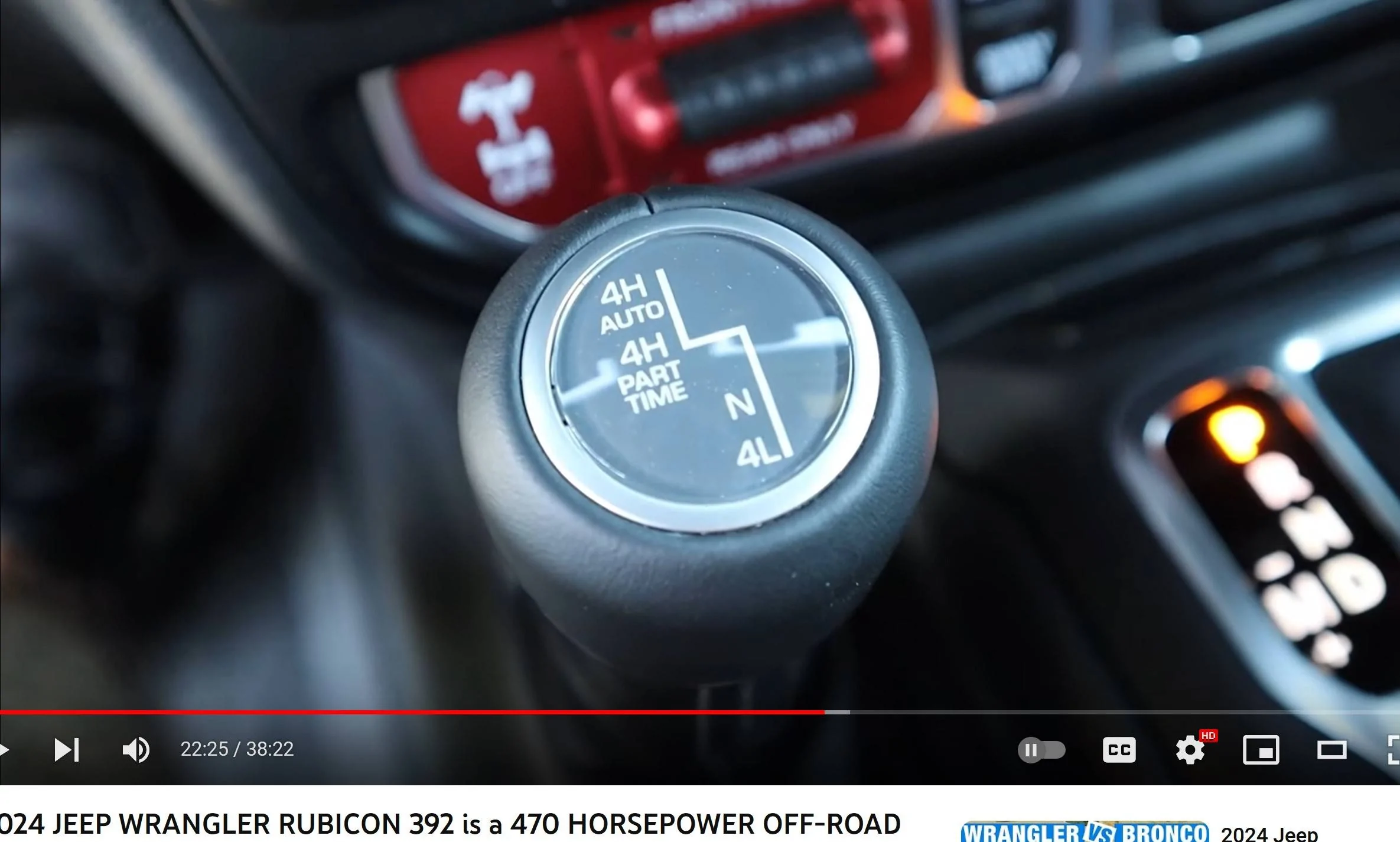

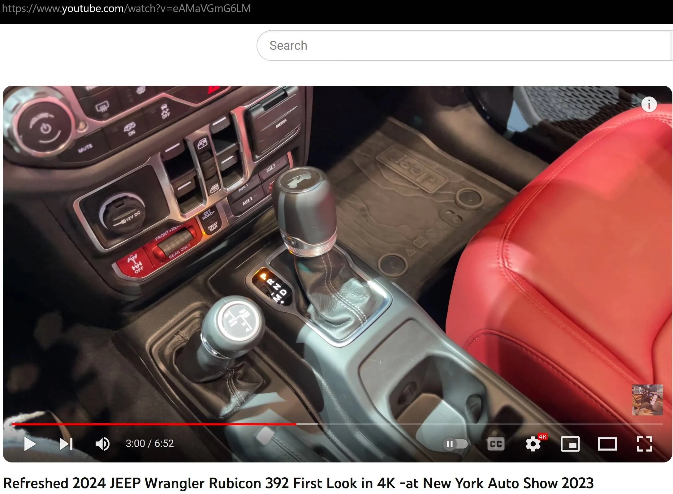

sunset
sunset
Jay
Sep 4, 2023
539
594
Seattle
1984 Camaro Berlinetta V8, 2024 Wrangler Rubicon 392
Well, would ya look at this...
A 2024 Rubicon 392 with the red seats and the Dual Mode Exhaust Button.
But, what's this? The 4WD Shift Knob has 2H?
I thought that wasn't supposed to be?
Jeep Wrangler JL Difference between 2H and 4H AUTO on dry roads? 2024 Rubicon 392 with 2H
Here's the one I've always seen on the 2024:
Jeep Wrangler JL Difference between 2H and 4H AUTO on dry roads? 2024 Rubicon 392 shift kno
Whaddya think? Early production model for sale?
Thought somebody said that was a mistake for the '24 reveal? Maybe I'm mis-remembering.
