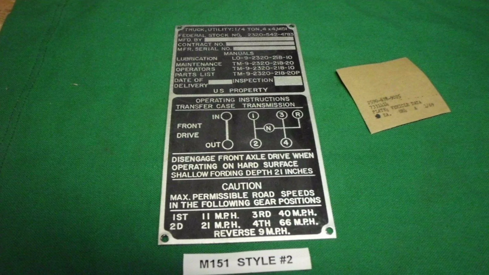

Here is the military instructions : push forward into "IN" for 4H , and pull backwards into "OUT" for 2H .
