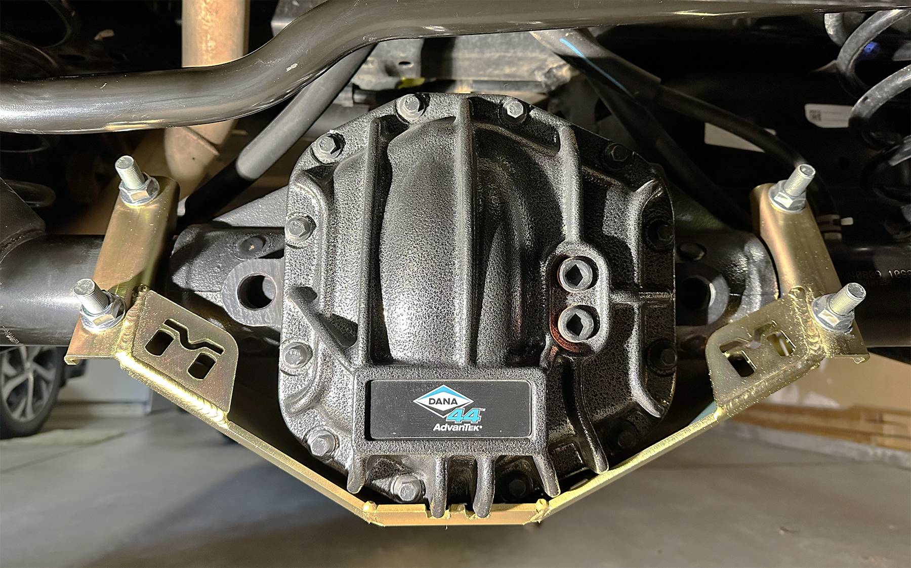

I've had these on my front and rear for two years now. They're great. As others have mentioned they stiffen up the pumpkins, reduce/distribute heat, protect and look great. I went with the silver nodular iron. The MC Golden Diaper works as a rear diff skid, but I found a little notching helped it fit better.

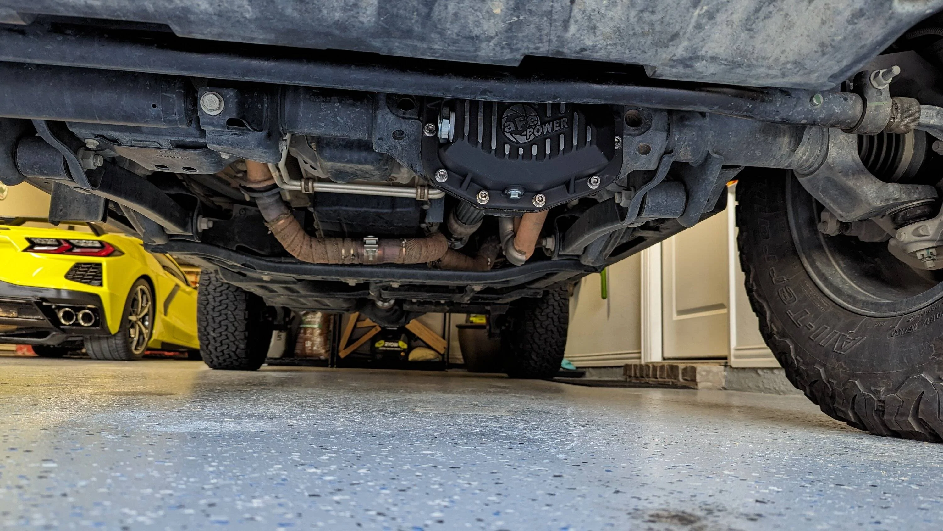

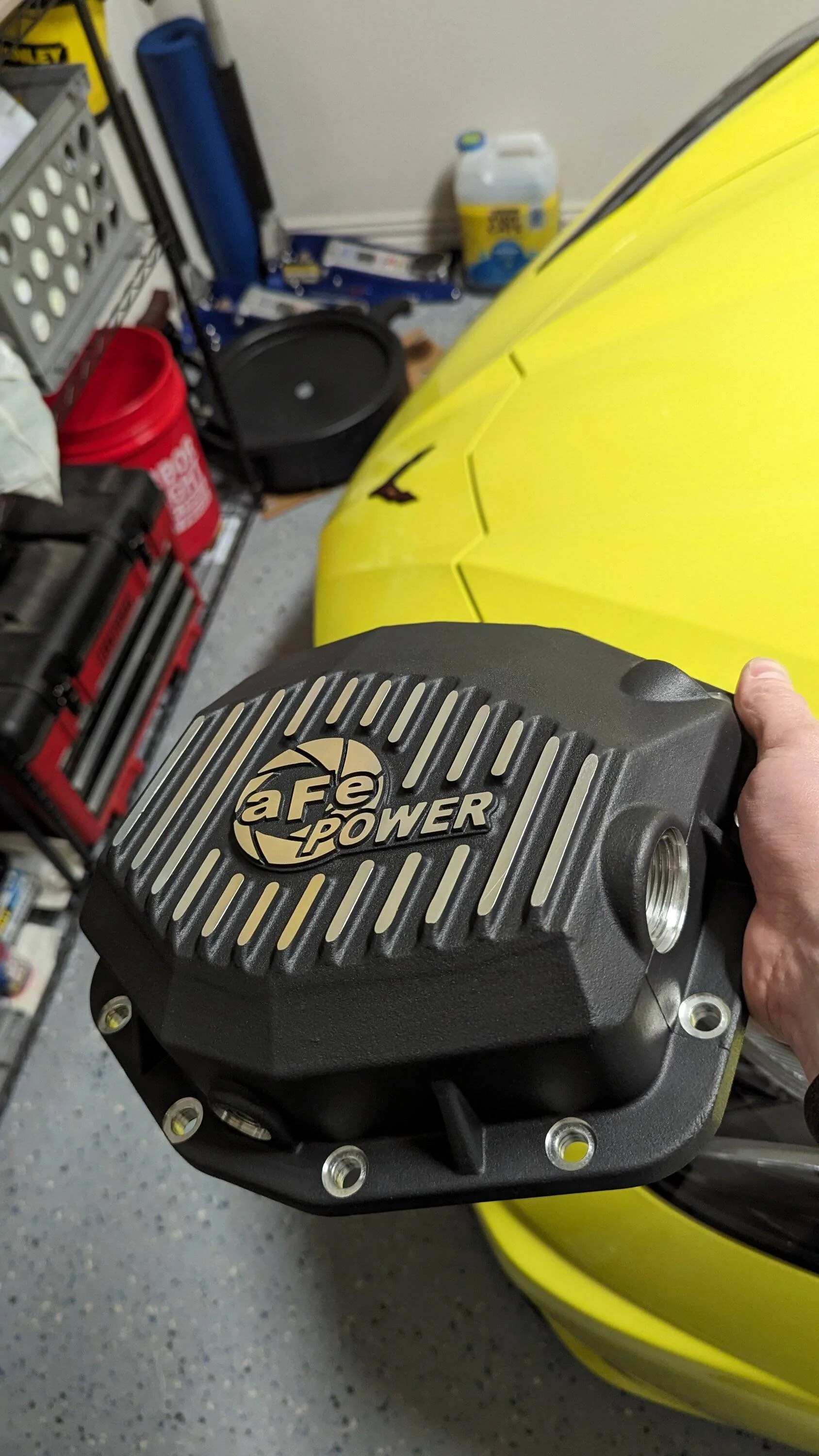

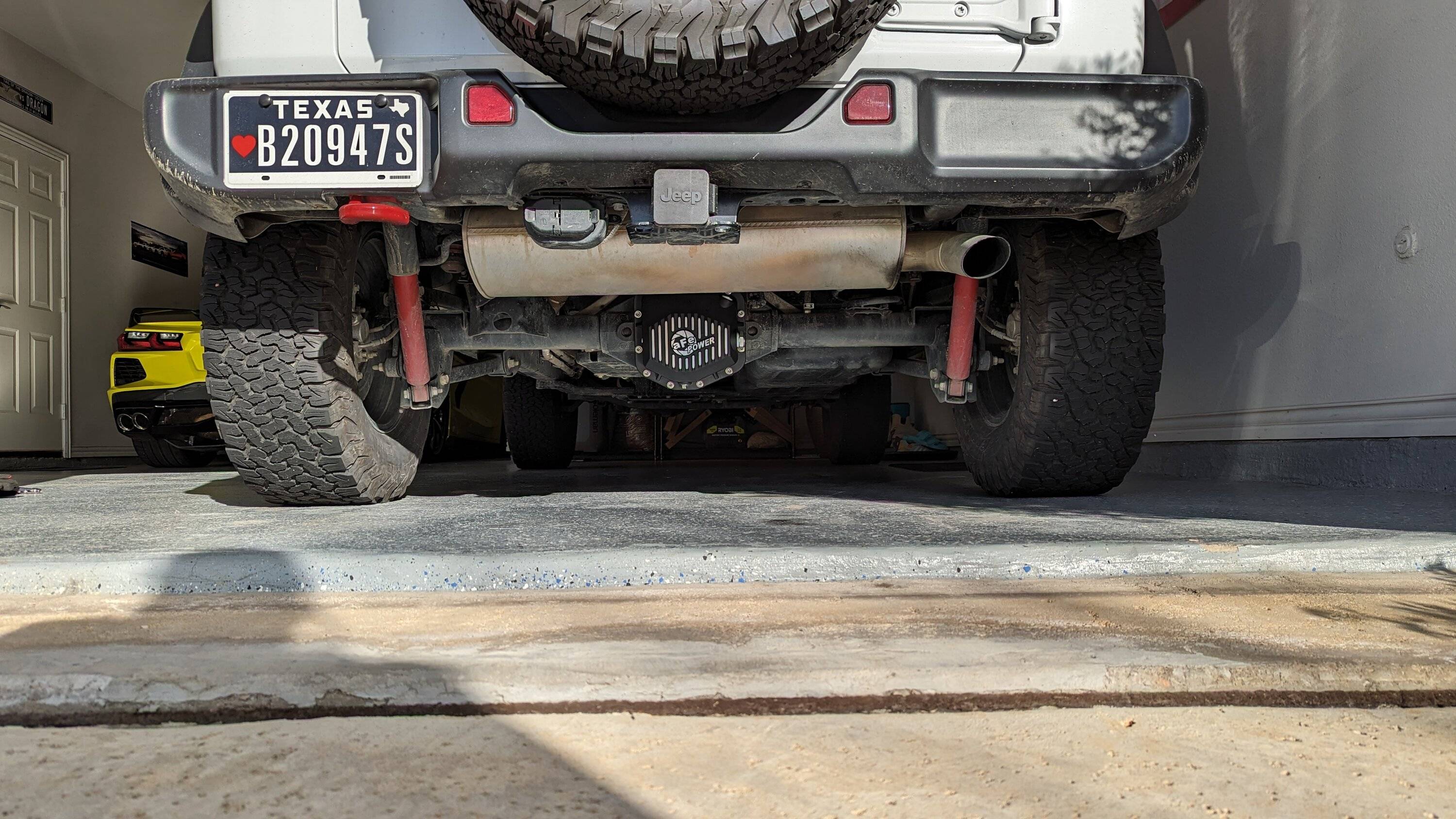

I solved that problem by installing aFe differential covers front & rear. The sight glasses and magnetic dipsticks were an added bonus, as was the additional fluid capacity.

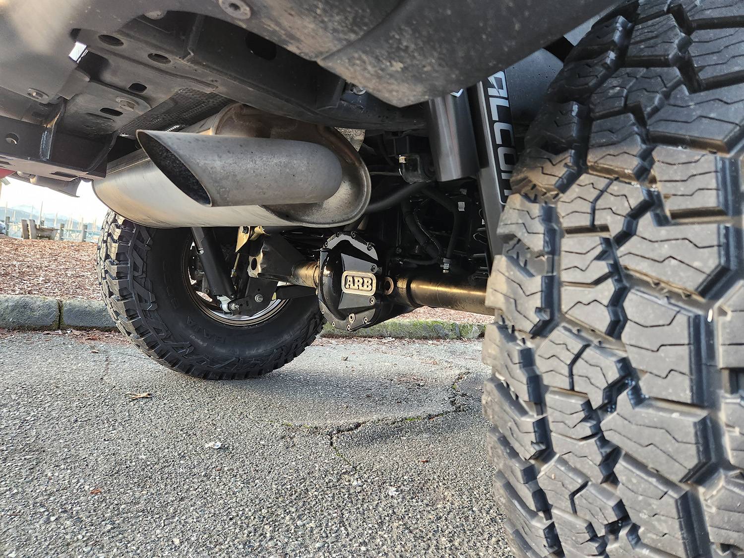

Have ran the ARB diff covers front and rear for about a year. They have been greet. Once you mark the dipstick for the right level its very easy to change out the fluid. I will say, however, do yourself a favor and pick up a pack of o-rings for the plug and dipstick. I have found that they have a tendency to tear when reused. I picked up five-six or so of each for around $5.00.
