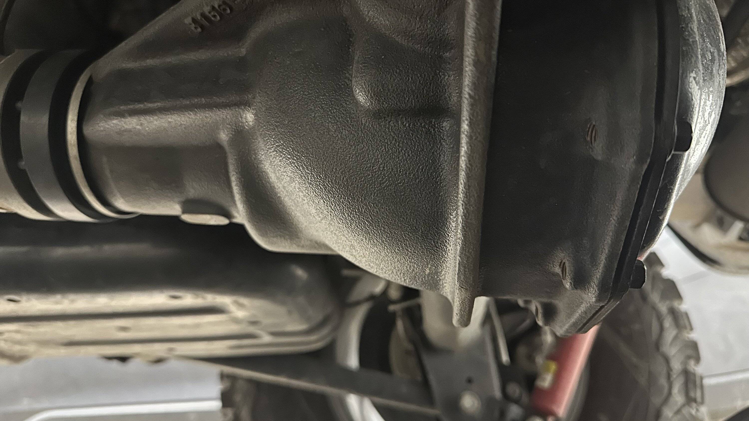

Do any of you have the bottom ridge on the rear diff like on my 2024? It looks like that ridge could easily get caught up on a rock versus sliding over it.
yup mine is like that on my 2024 and it is a terrible design.

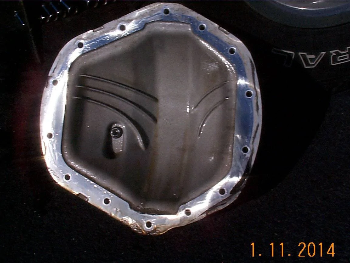

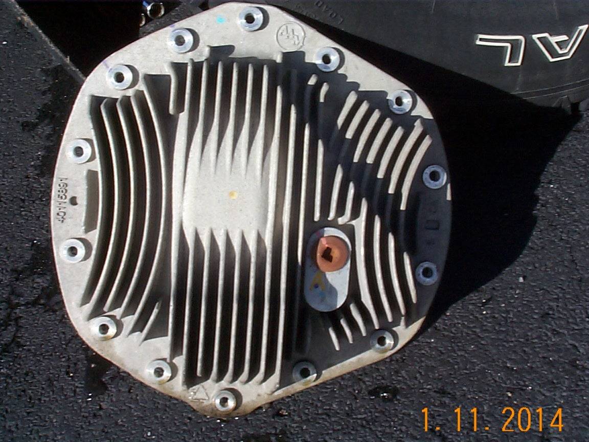

My 2014 RAM 3500 Crew Cab DRW H/O was equipped with AAM axles. The rear was an 11.8” / 300mm and servicing was a breeze on both the front and rear axles.
Jeep Wrangler JL Diff Covers dcp04840-
Jeep Wrangler JL Diff Covers dcp04836-
Jeep Wrangler JL Diff Covers dcp04838-
Jeep Wrangler JL Diff Covers dcp04837-jpg
Given the ease of servicing with the reusable gaskets, I’d go that way every time.
