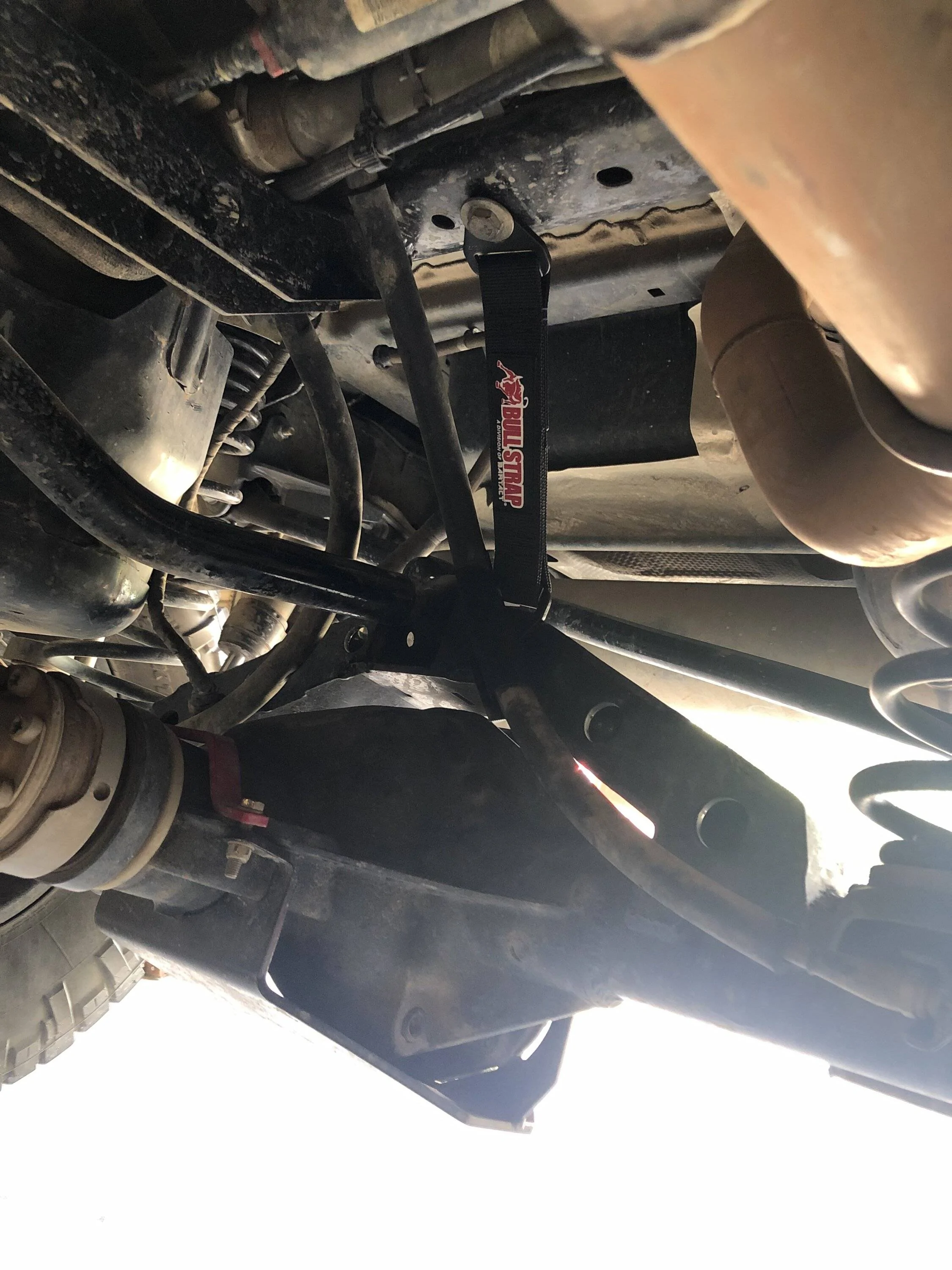

Love mine, I painted my red Rancho skid with some hammered grey to match…….
What is the RK metal above the diff?
Where did you get that from and what is its purpose?

It’s a truss that holds my rear upper control arm…also I’m using it to hold my center limiting strap. I’m running long travel shocks on a 3.5” lift, so if both wheels droop at the same time my rear coils would come loose. The strap limits full droop of both wheels at the same time…..but doesn’t affect drooping one wheel individually.…. The truss is part of my Rock Krawler long arm kit with 3link rear ( only one rear upper control arm in the center)……..
