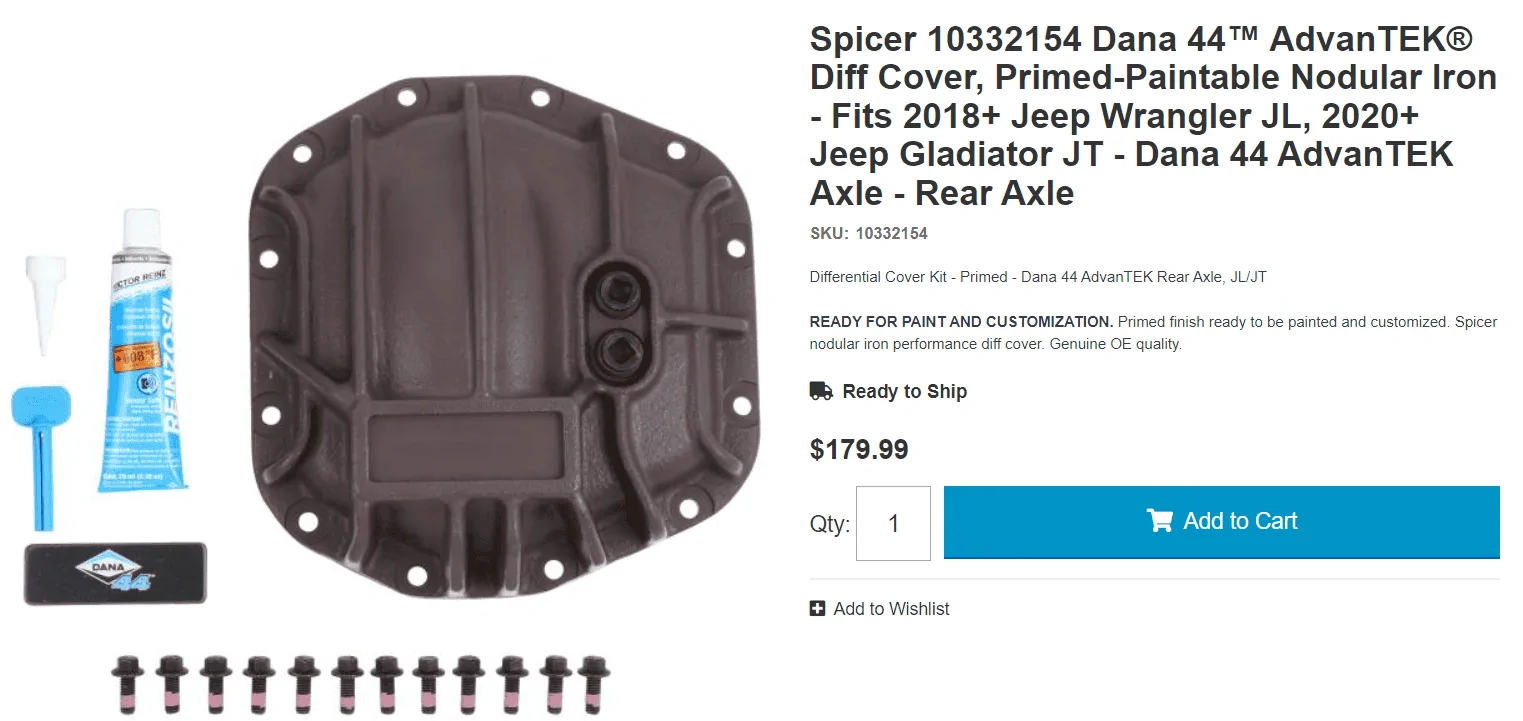

The covers that Dana specifies for use with the JL/JT Advantek axles do not have a drain plug:
Jeep Wrangler JL Diff Covers 1709668501112

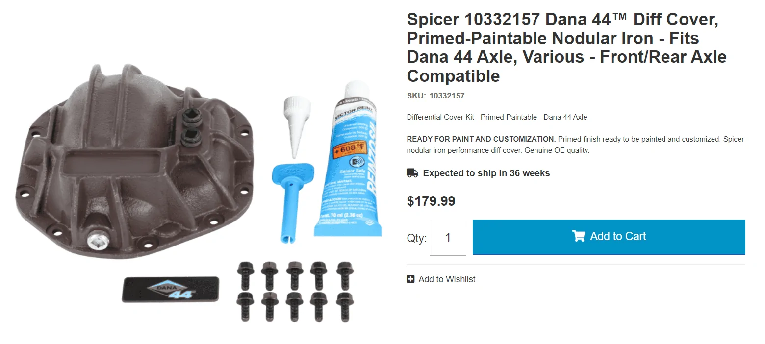

But, the cover for "Various" Dana 44 axles (non-Advantek)has a drain plug:
Jeep Wrangler JL Diff Covers 1709668030174

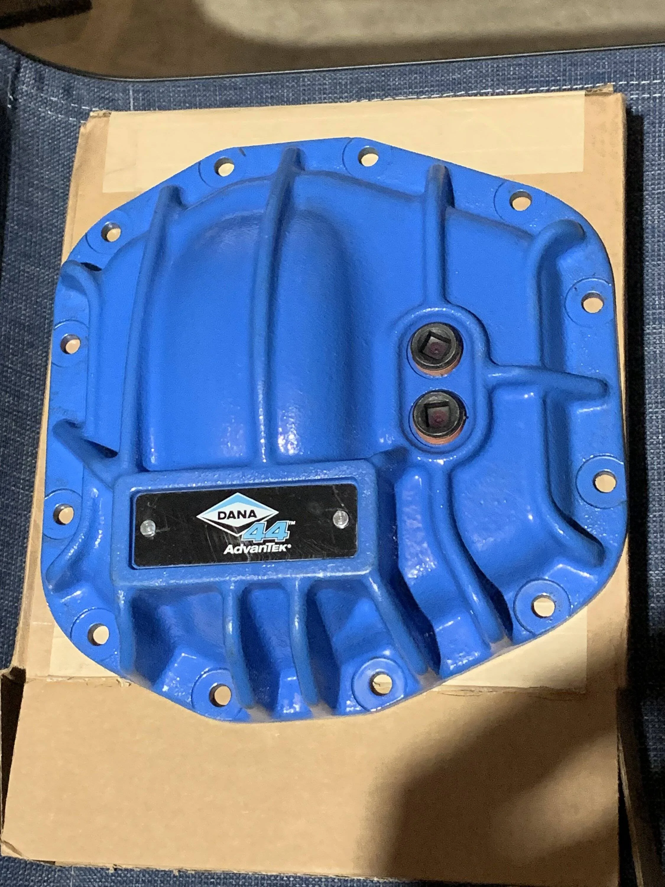

Well apparently I have the first gen Advantek M210 and M220 covers. Mine don’t have drain plugs.
Jeep Wrangler JL Diff Covers IMG_7586
