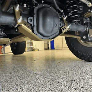

It’s a truss that holds my rear upper control arm…also I’m using it to hold my center limiting strap. I’m running long travel shocks on a 3.5” lift, so if both wheels droop at the same time my rear coils would come loose.

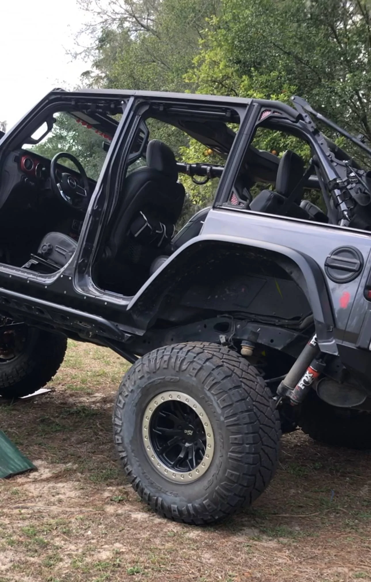

Isn't the sway bar and the sway bar end links supposed to keep this from happening???
The rear shocks are the limiting factor, and mine are for 4.5-6” lift so they extend 32.30”, that’s to far for 3.5” coils….. the oem rear sway bar doesn’t limit droop….you can see here, that shock is fully extended and you can see the position of the sway bar if you blow up pic…

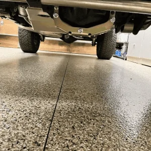

We tow, and heat in the rear differential is a concern, so I use the stock differential covers with the following:
Differential Spider
I use it for the front as well to clear the stock steering components.

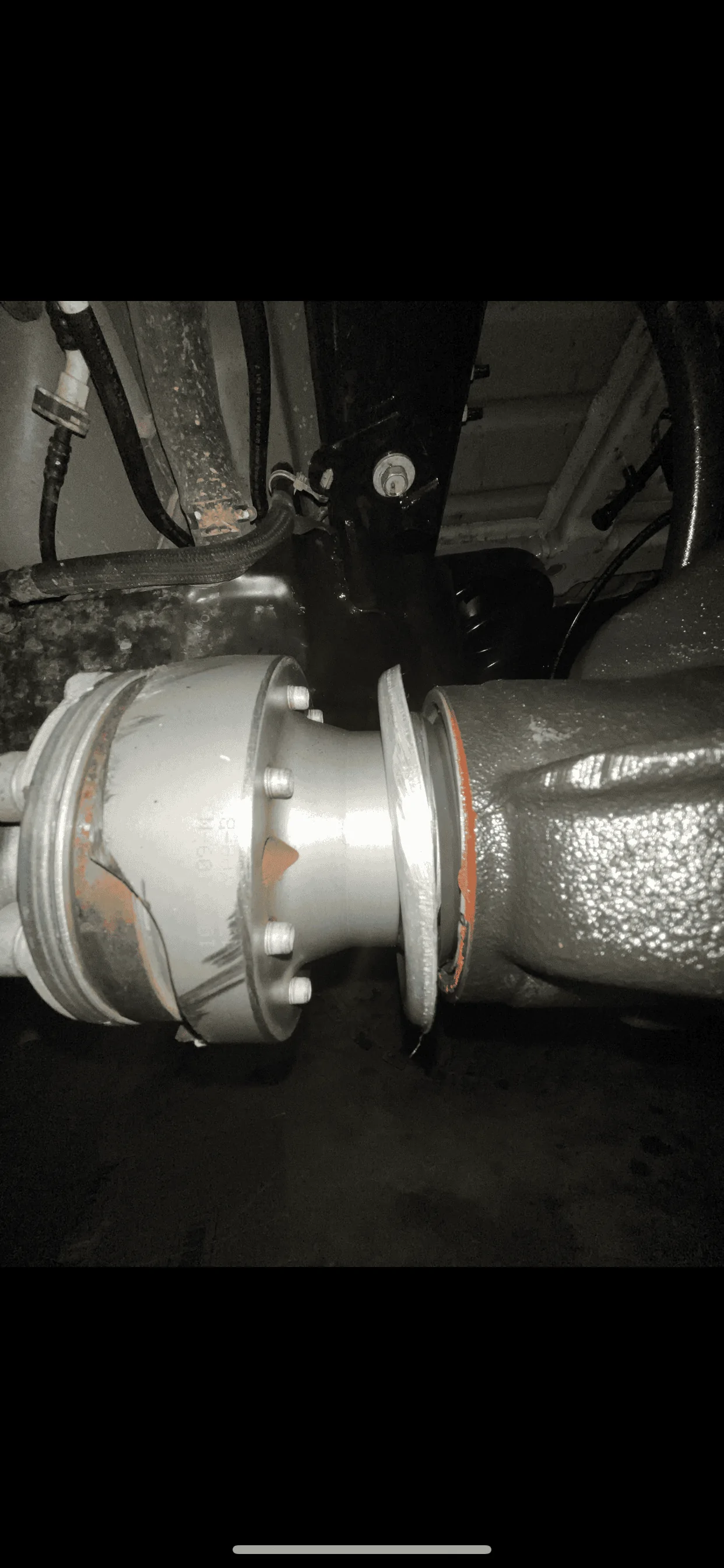

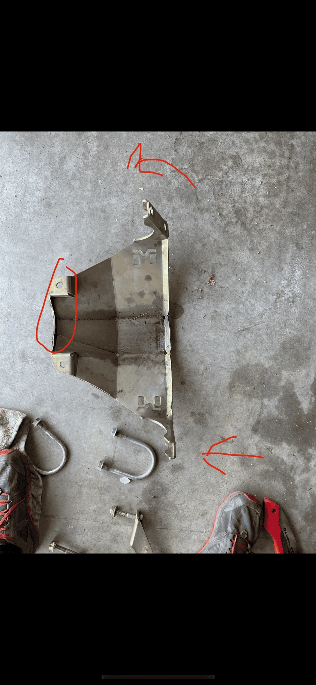

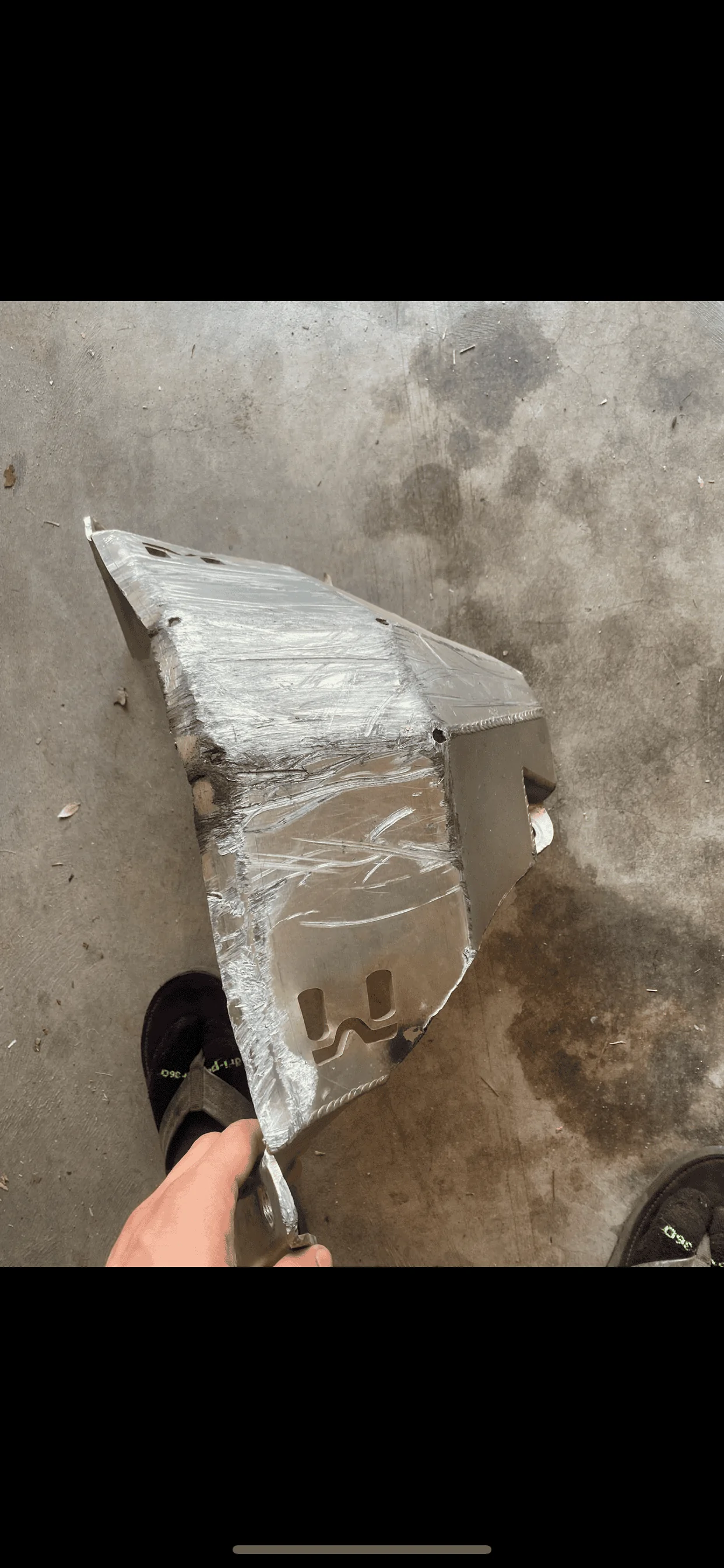

I run the metalcloak skids to protect the DEF covers and the differential housing. The stock rear differential housing has a major, casting web that can easily get hung up on rocks and ruin your whole day. If it's broken. I think the metalcloak set up provides significant strength against flex of the housing as well.
I ran that rear skid for awhile. Until it bent and took out my pinion seal. Which required pulling over and filling up the diff 3 times on the way home haha. I also ran the stock cover and put a big dent in it on fordyce. Very lucky to not damage the gears lol.
Why it bent so bad I’m not sure. Could have loosened up allowing it to shift.
I removed it on the way back from which hill 4 to highway 80. Funny enough I did not hit my axle/ diff again. That skid definitely makes you lose clearance.
I went with the Dana spicer cover after this.
