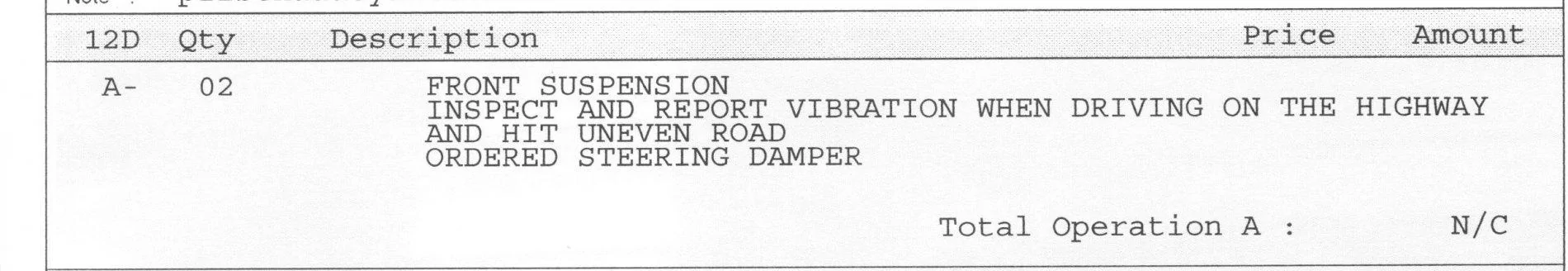

I just called the dealer for an appointment after I had a bad wobble experience this morning when driving at speed of about 50 miles /h . I must have hit what I think was a minor pothole on the highway . It wasn't the first death wobble I experienced with my [10 K JL ] but it was a violent one . The Jeep was shaking like a toy car and it went on and on for a long time untill I slowed down to about 30 m/h . I haven't done any modifications to my JL at all . I was glad my wife wasn't sitting next to me at that moment because it was really scary.

I pretty much have the same experience with my local Toronto dealer. This morning they inspected the Jeep and new steering damper is being ordered. How long the waiting period will be nobody knows. I don't have to do much hwy driving and so I should survive the unspecified waiting period .
I wonder if this new damper is in any way different from the factory one installed in 2019 .
