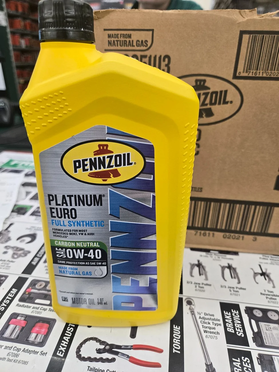

1,350 miles on 0W-40 right now. At 1,500 I will 🧐 the filter and magnetic drain plug and will send oil for UOA. If things look normal, then this is my forever oil. I am pumped 🤩👍

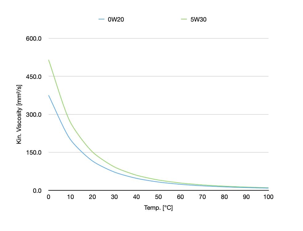

I'm no oil guru but, looking at the kinematic viscosity of 0w20 vs 5w30, the two are different by only 6 degC. For example, 5w30 at 6 degC has the same viscosity as 0w20 at 0 degC. I don't know at what temperature 0w20 is too thick but shouldn't 5w30 work fine at just 6 degC warmer that? I realize this chart doesn't go down to -40 deg but I believe it is safe to say the two lines remain close together.
Comparing them at specific temperatures, 5w30 is 37% more viscous at 0 degC and 17% more viscous at 100 degC. It sounds like a much bigger difference when stated this way. The magic of numbers. Say it one way to make it sound minimal, say it another to make it sound like a lot.

Just to add, pass the 0c they start using a different test and unit as cst is no longer accurate. The warm temperature test is about how good the oil flow and the low temperature test is how much resistance to rotations the oil offers.
But yes in essence you got it spot on, if you live in warmer climate increasing the viscosity is just counters balancing the extra temperature.
Now if i wanted to write a paper and get clicks I would say: climate charge force ICE owner to increase their engines oil viscosity :CWL:
The engine won't even feel that difference. At 40 degrees F 0w20 is far far thicker than 20w60 at operating temperature. But people's engines don't blow up on 0w20 at 40 degrees F.
Starting the Jeep with 5w30 at 30 degrees F is like starting the Jeep with 0w20 at say 15 degrees F. The engine won't care, the oil pump will pressure spank 5w30 to all the parts of the engine. My Jeep starts right up with no drama on 0W-40, and my dad's 1998 4Runner starts right up on 20w60 🤩👍
