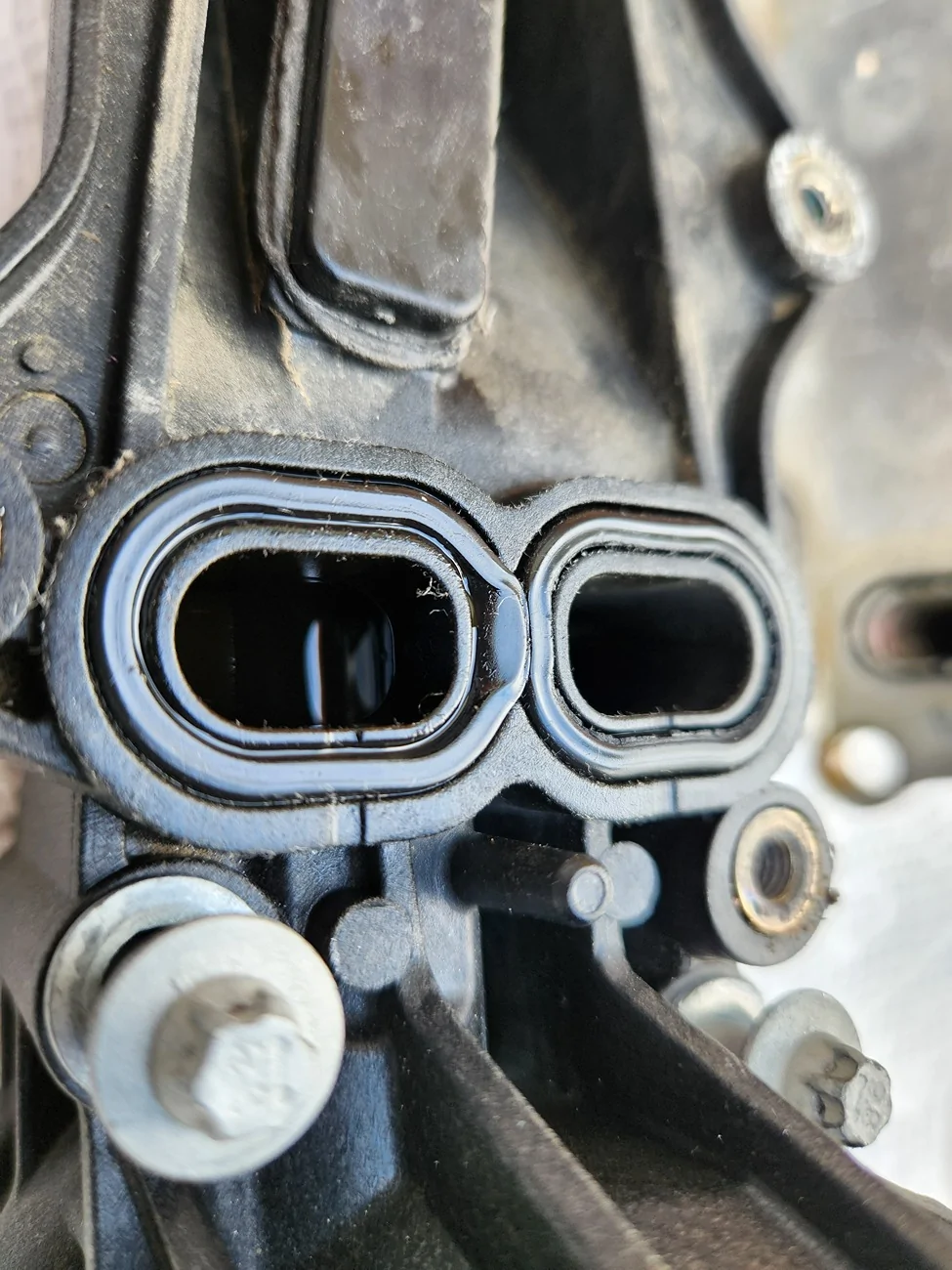

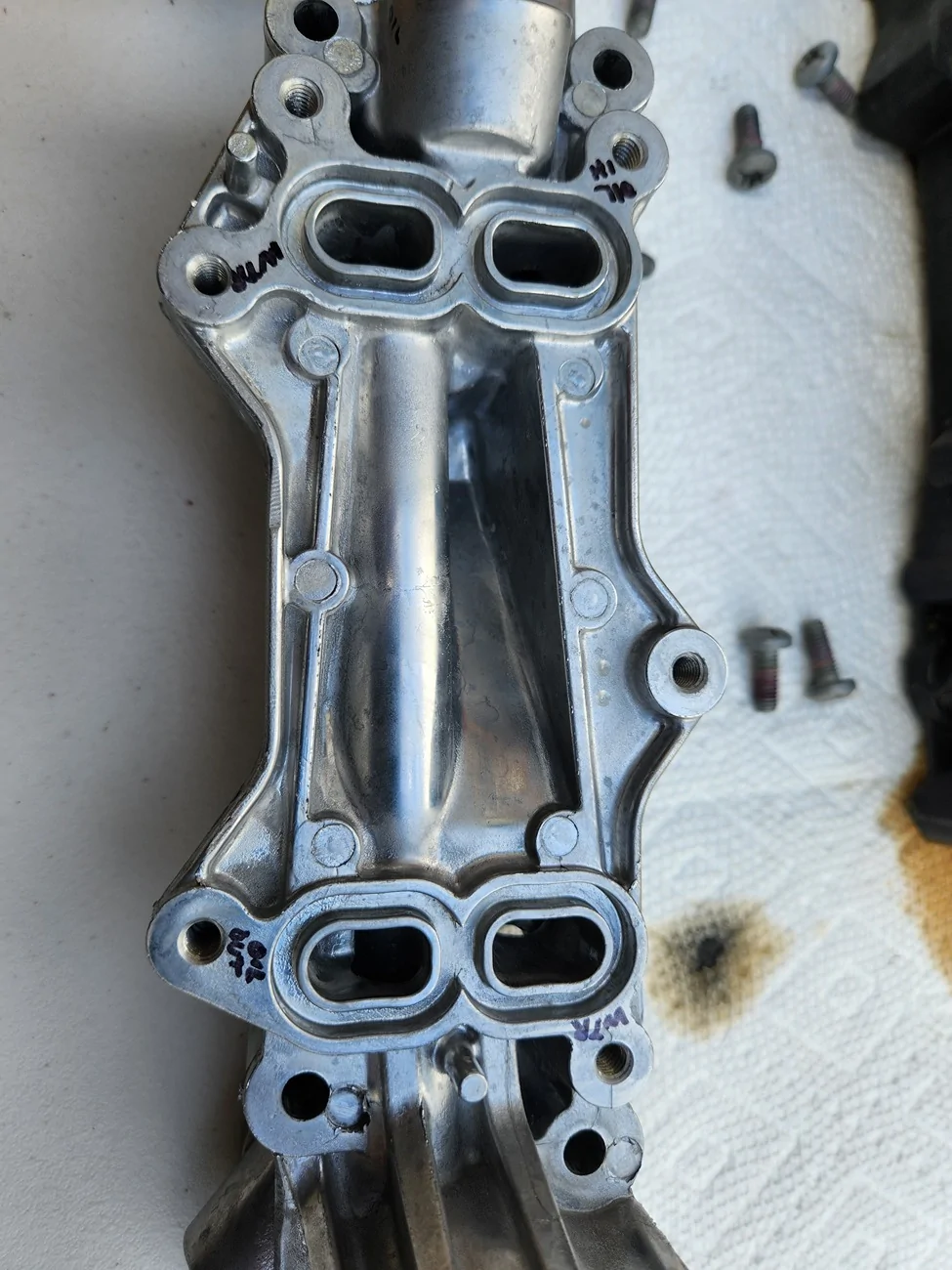

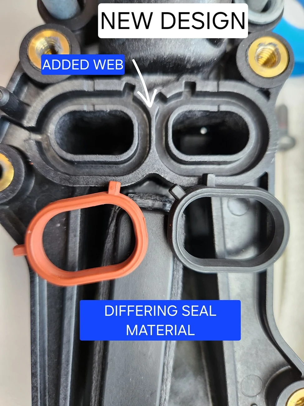

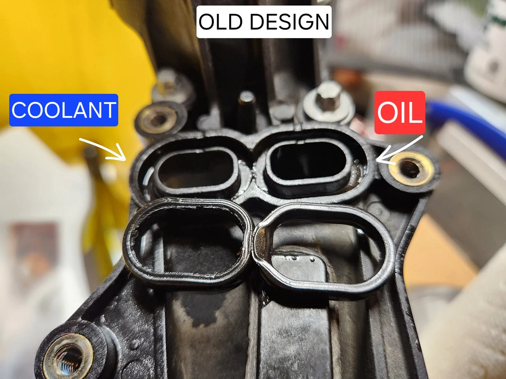

I would recommend against using one of the current aftermarket aluminum oil filter housings, unless they recently incorporated the separated oil and coolant port seals between the cooler and housing.
