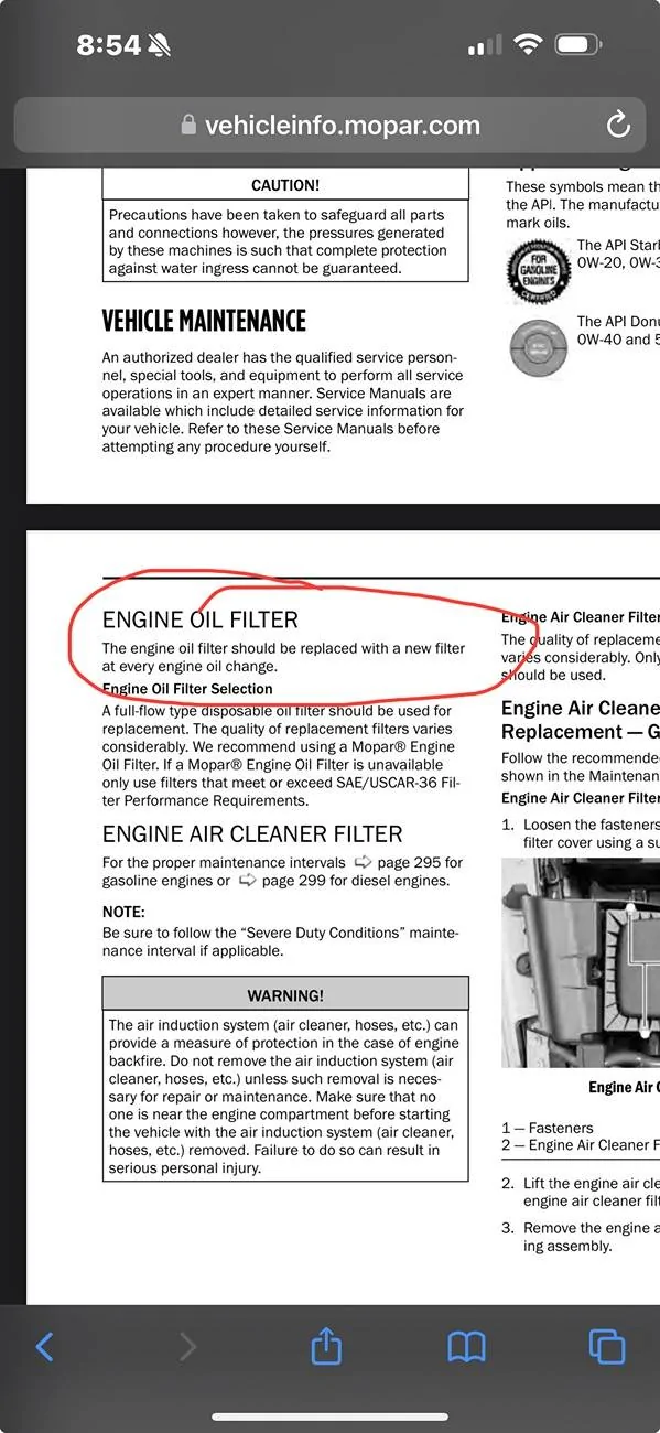

Here’s your answer straight from jeep
Plus it should be full flow Mopar. I don't understand what full flow means but I think we must not mess around with aftermarket oil filters 🫣 They say that technically oil filter is part of the engine.
