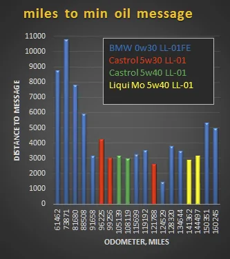

I keep records of everything. When I bought my BMW F10 in 2014, the shtick was to use the Castrol 5W30. It said so in on the metal plate epoxied to the engine block.
By the time the first oil change was due, BMW switched suppliers and the oil grade. It became Shell and 0W30. The same N55 motor. No reason other than climate change and EU a**holes. Anyways, at some point the message in the instrument cluster will will pop up: "Oil at the min level. Add 1Qt ASAP".
With BMW things sometimes are not that complicated. You can add any oil as long as it is on the approved list. LL-01 in my case. I kept experimenting as the chart below illustrates.
My educated guess is that in the long run none of this matters. As long as you change oil at all: That one significant dip at 124529 miles at the middle of the chart was when the dealer just reset the oil change indicator, but forgot to actually change the oil. Oops.
