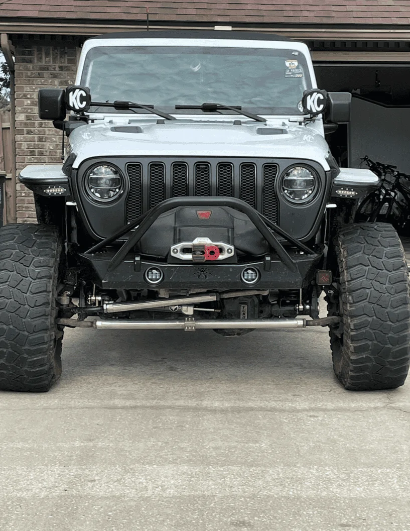

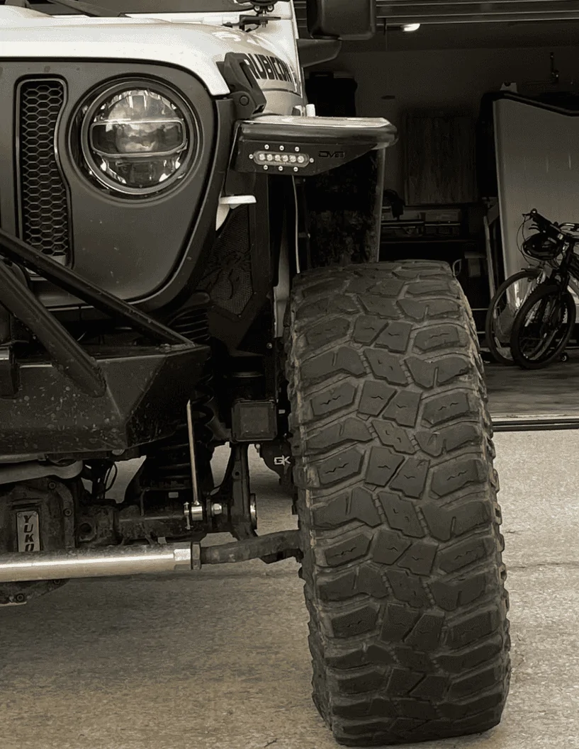

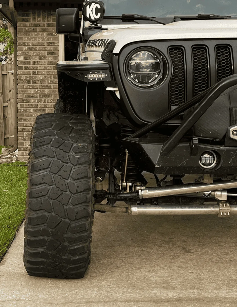

Just checking to see if anyone knows what the issue is here. Whenever my front end is facing downward on a slight decline, the wheels get very cambered. When the jeep is sitting level or facing upward, i don't see any problem. Is this normal?

Where is your axle shaft ? Lol…

The axle's nut holds the unit bearing together, it looks like the unit bearing is falling apart
Reinstall the axle, torque the nuts to specs, and see what it looks like.
You run a good chance of the unit bearing falling apart while driving.

At the time of these pictures, I was waiting for a new shaft to come in the mail. I should have posted a newer picture for reference, but the jeep still has the same camber issue with the axle shaft installed.

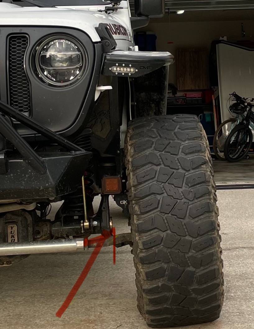

If you wheel this vehicle, I would check the aluminum knuckle. These can bend and break off, also note the torque for the ball joints as it is really low.
Lower Ball Joint--15lbft/Upper Ball Joint 55Lbft- Lower Ball Joint--15lbft/Upper Ball Joint 55Lbft-
Don't guess!
If it is indeed bent, look for the JT Mojave knuckle as they made those with cast steel vs aluminum. Reid Racing makes them as well.
Otherwise you have yourself a bent ball joint. The camber is not adjustable on these.

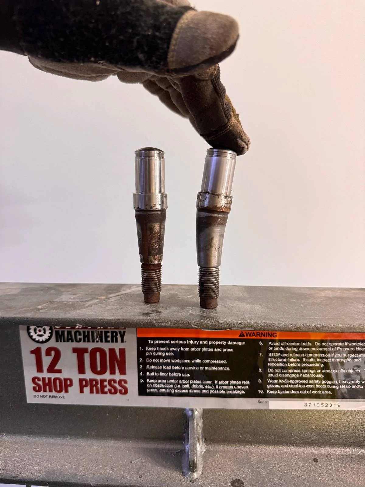

Your ball joints are bent … I had the same exact issue took mine apart and check this out
This thread is 5 months old. The OP's wheel bearings likely fell apart within a few days of his post.
But nice ball joints. Absolutely wrecked them, lol.
I’ve never seen anything like that in my life wow. I’ve k my seen balljoints break off completely
