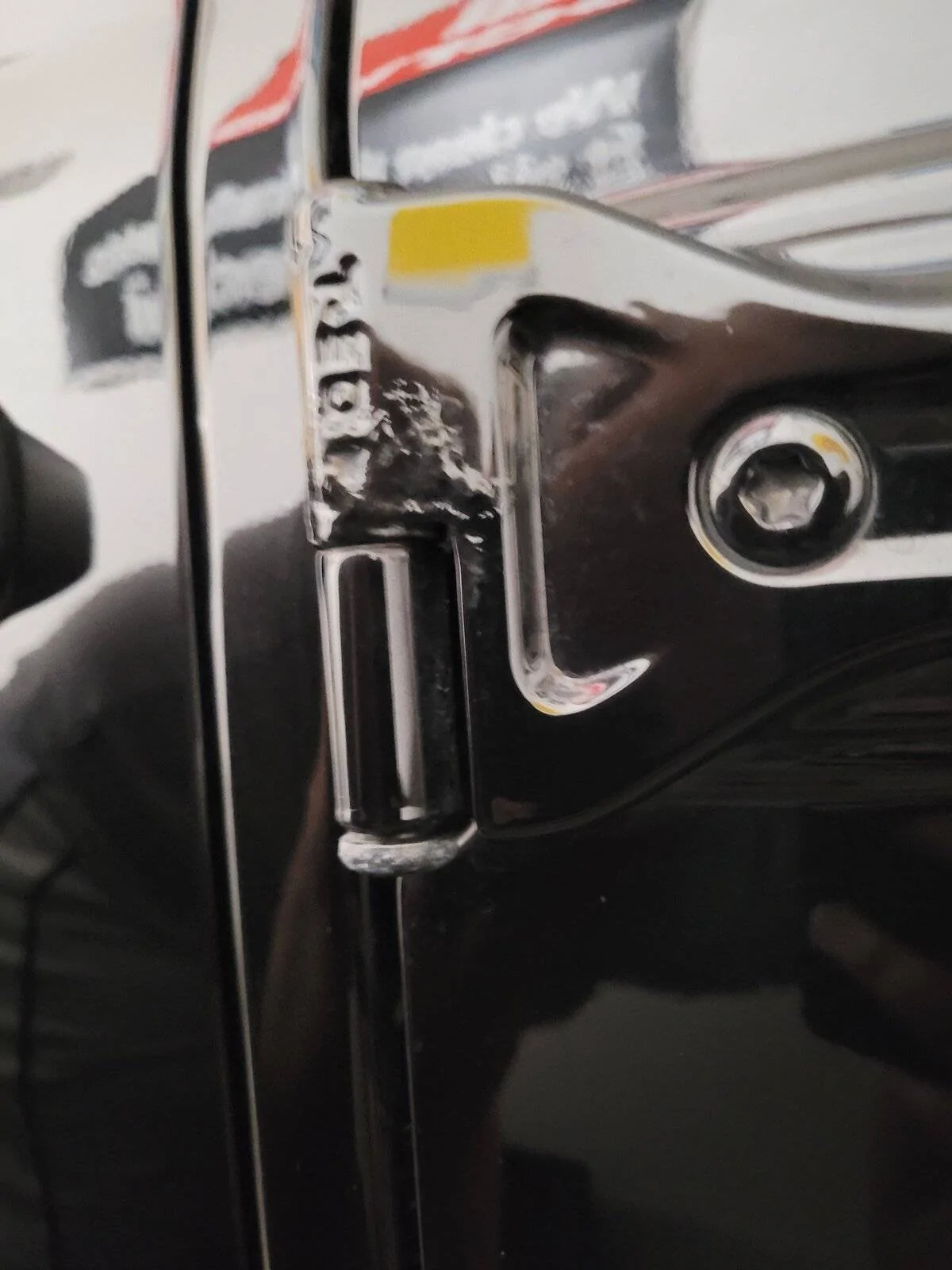

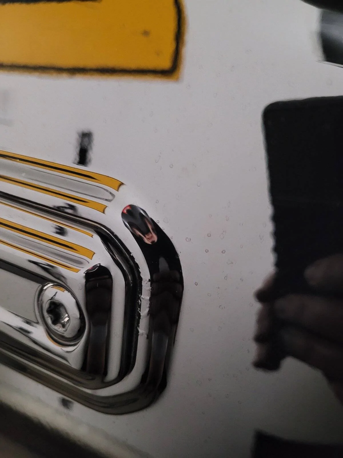

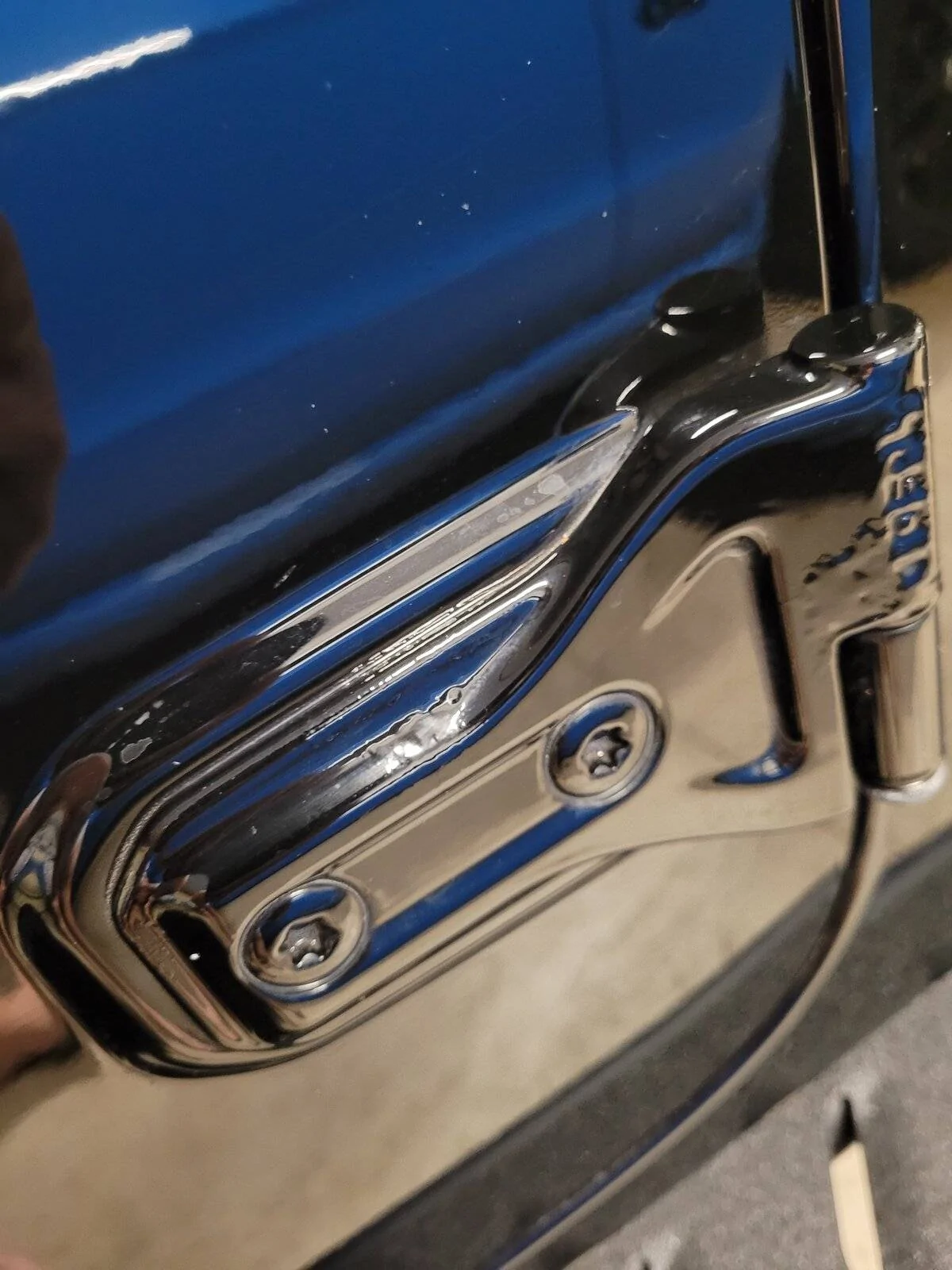

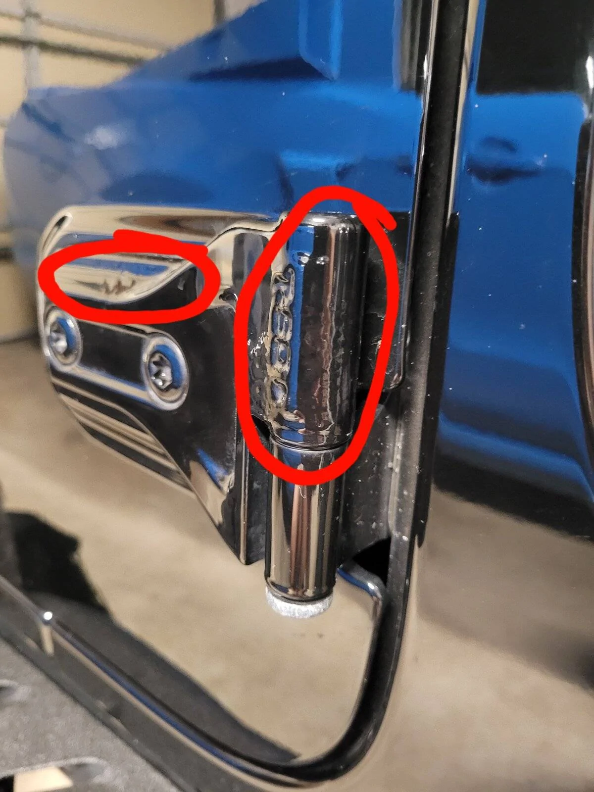

I haven't gone through the whole thread, but read the last few pages. Has anyone gotten a remedy that will prevent this from happening after it's fixed by a dealer?
Also, any response by @JeepCares? This is a known issue and has been going on for years. Can't believe there's not a remedy. They'd just prefer to kept repainting parts?? I'm FRUSTRATED!!!! Paid $55,000 for a 2020. It has 12,000 miles and it has corrosion. Crazy!
