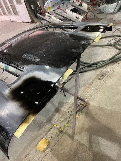

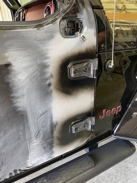

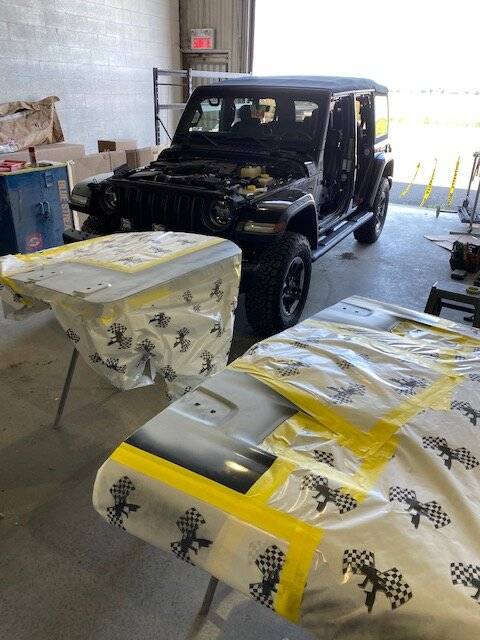

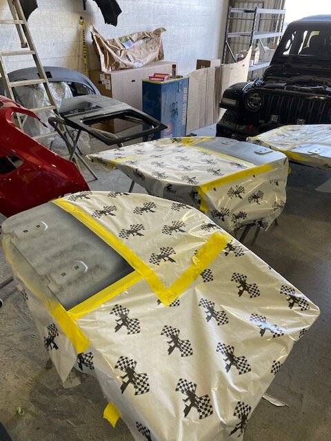

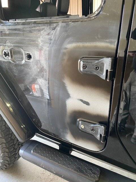

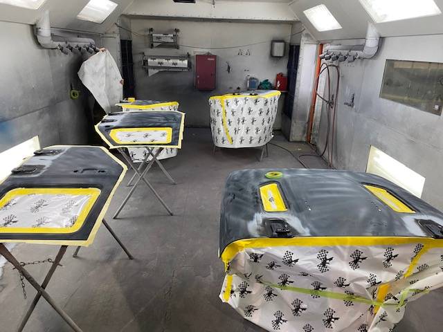

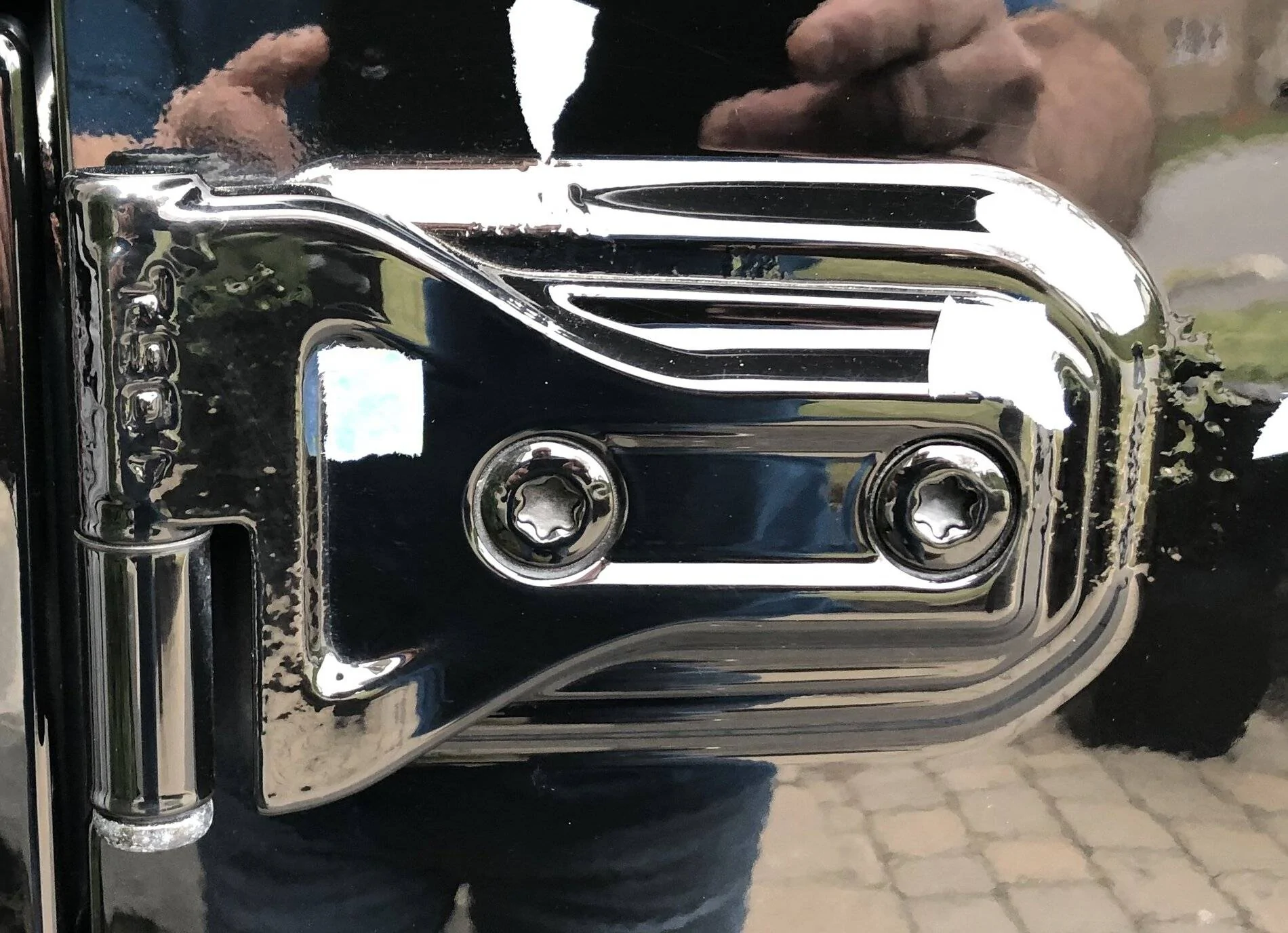

I got mine back from paint 2 weeks ago, it took them 7 working days to paint all 4 doors and the hood. I also bought 8 news door hinges (I did not wanted to have my old corroded hinges stripped and repainted) that they painted and installed… It was a $3,000 job. Except for the new hinges everything was covered by the warranty.
They did a very good job on the paint and on the work. They primed and painted the hinges and their matching surfaces prior assembly and final paint. Here’s a few pictures.
P.S. Excellent work & service from Rive Sud Chrysler in Brossard ?

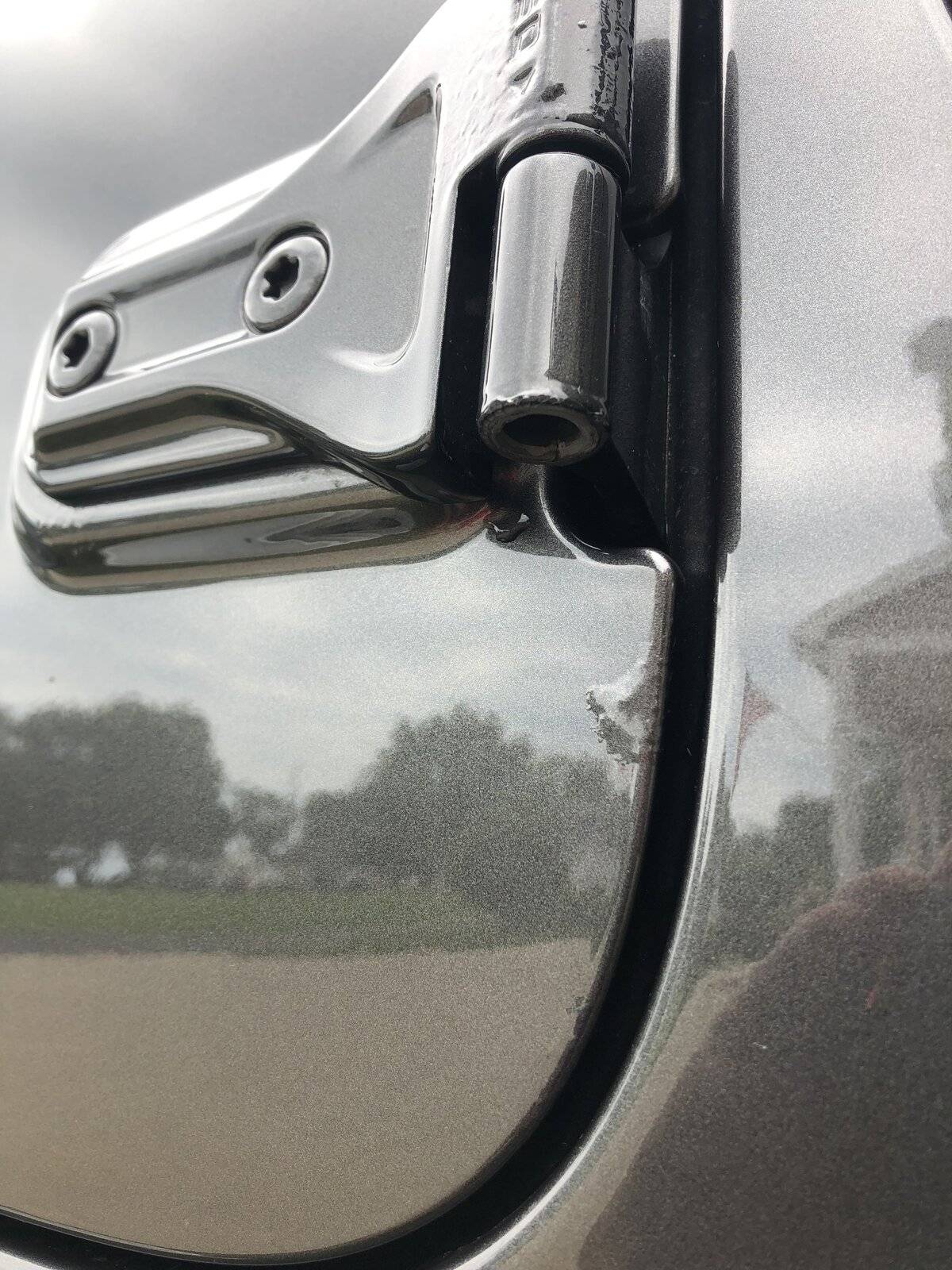

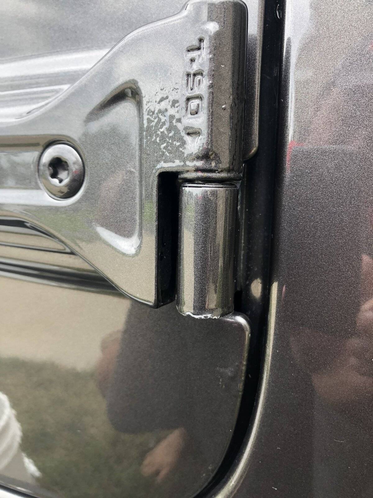

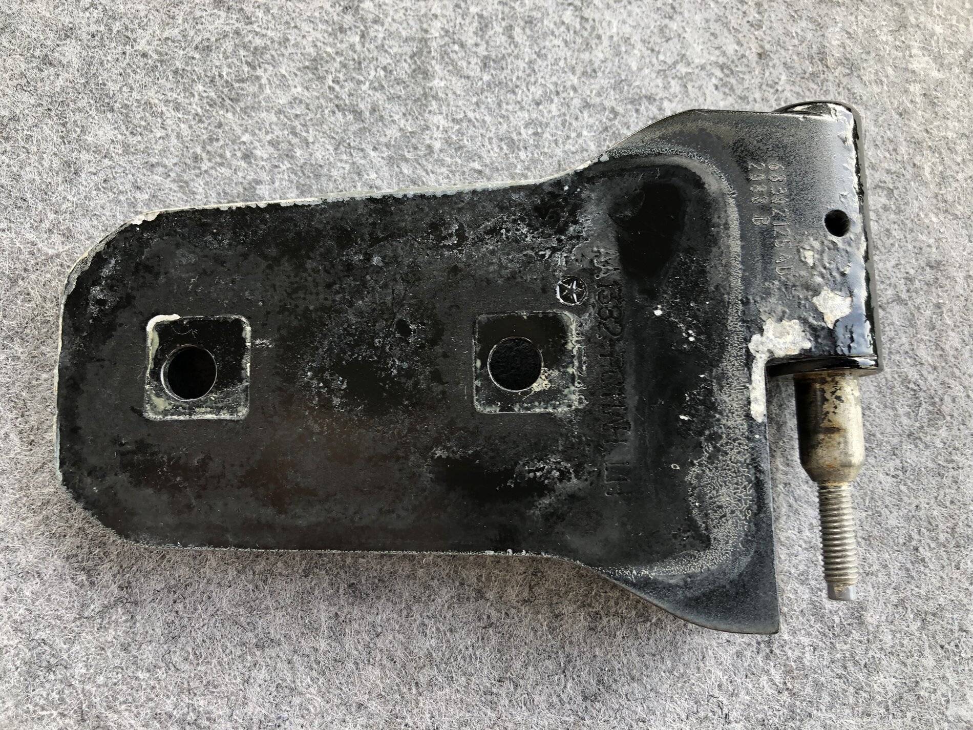

Now that’s it is repaired, I expected the back of my old hinges to be on bare metal and corrected… I was wrong they were not corroded. I thought that it was the hinges corrosion that had spread onto the door….
The new hinges were primed in black, just like the old ones. I do not know if the door behind the hinges was primed or bare metal.
Would someone have pictures that shows the condition/preparation of the door behind the hinge?

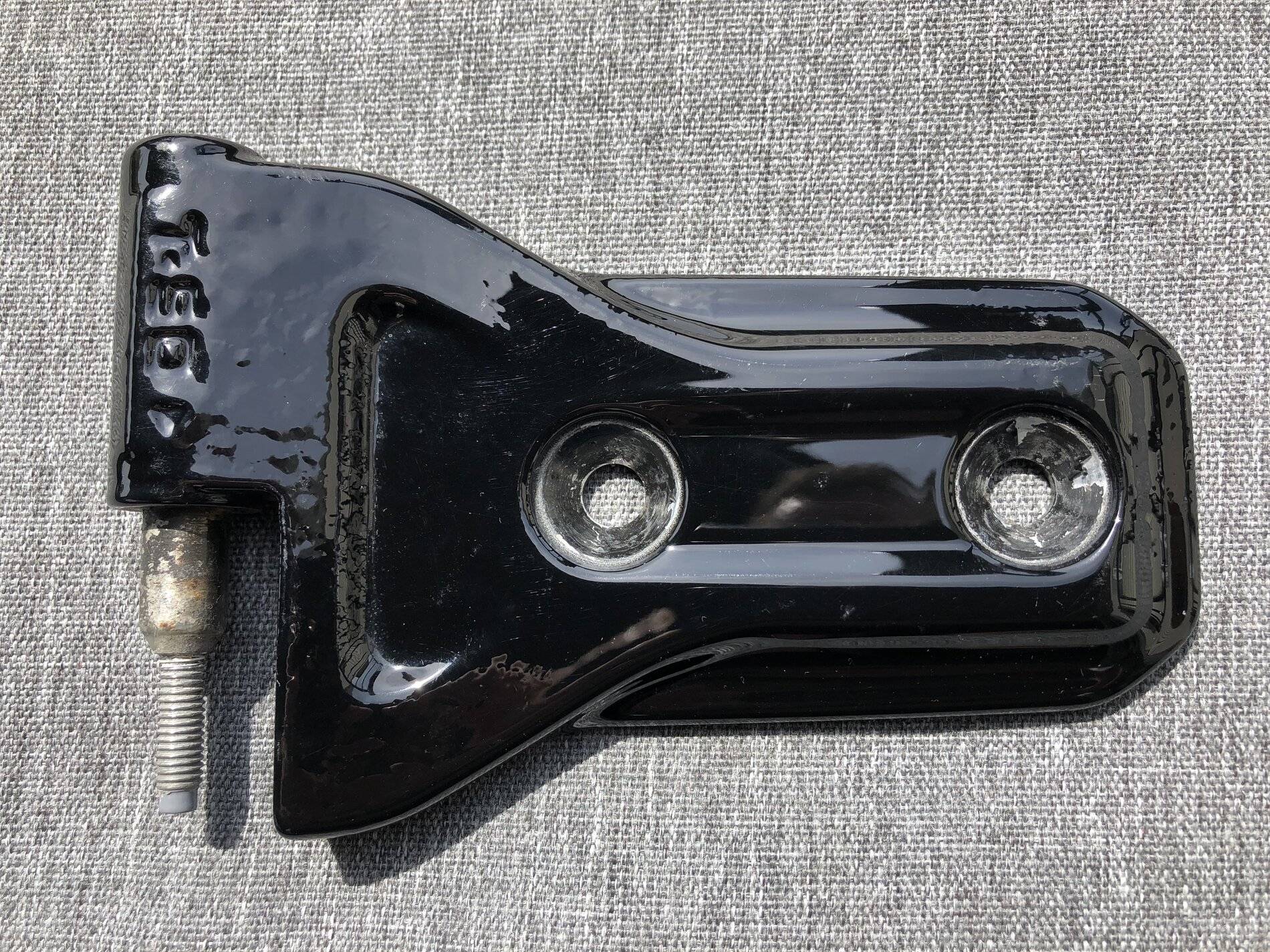

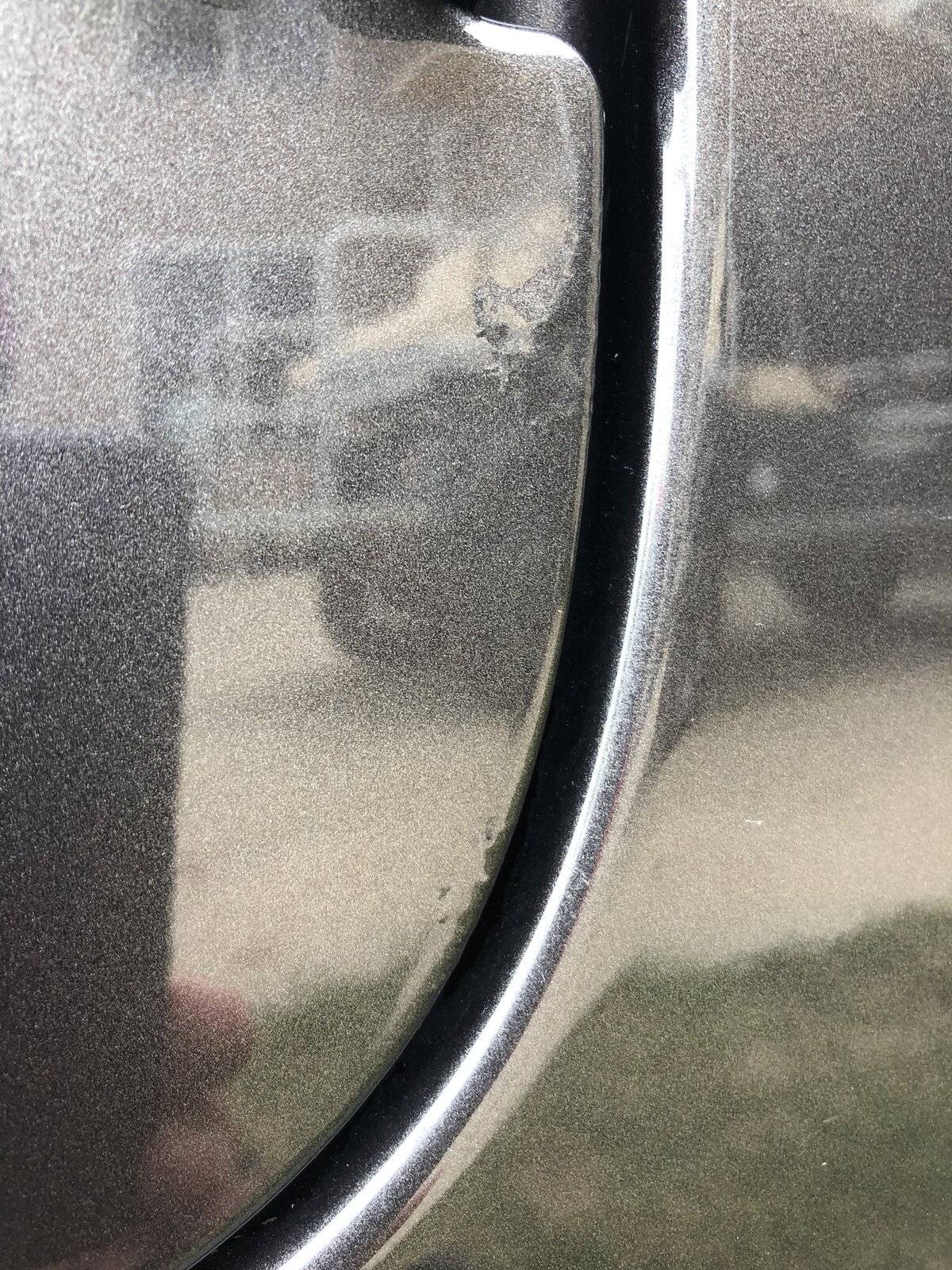

Here’s some pictures of my worse one on the Jeep and when removed:
If you look back a few pages I’ve posted what everything looks like when the hinges are taken off. It’s bare metal on the door

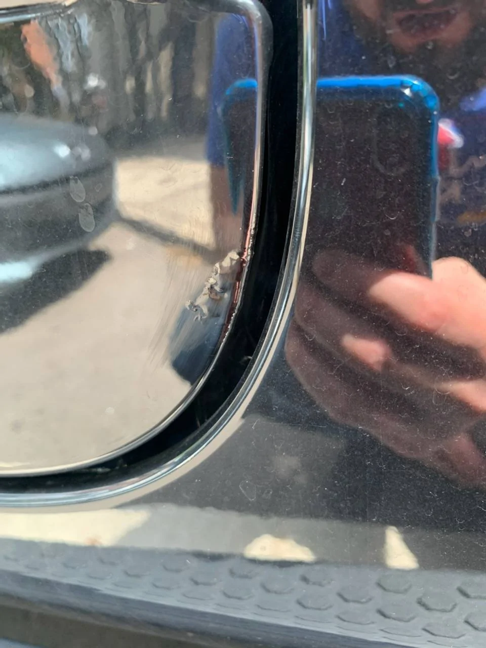

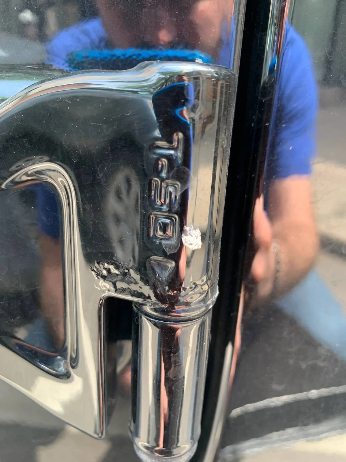

Well I was going to wait & see if it got worse......now spread to door edges... what a POS!
Going to body shop after vacation- was documented last year at dealer
