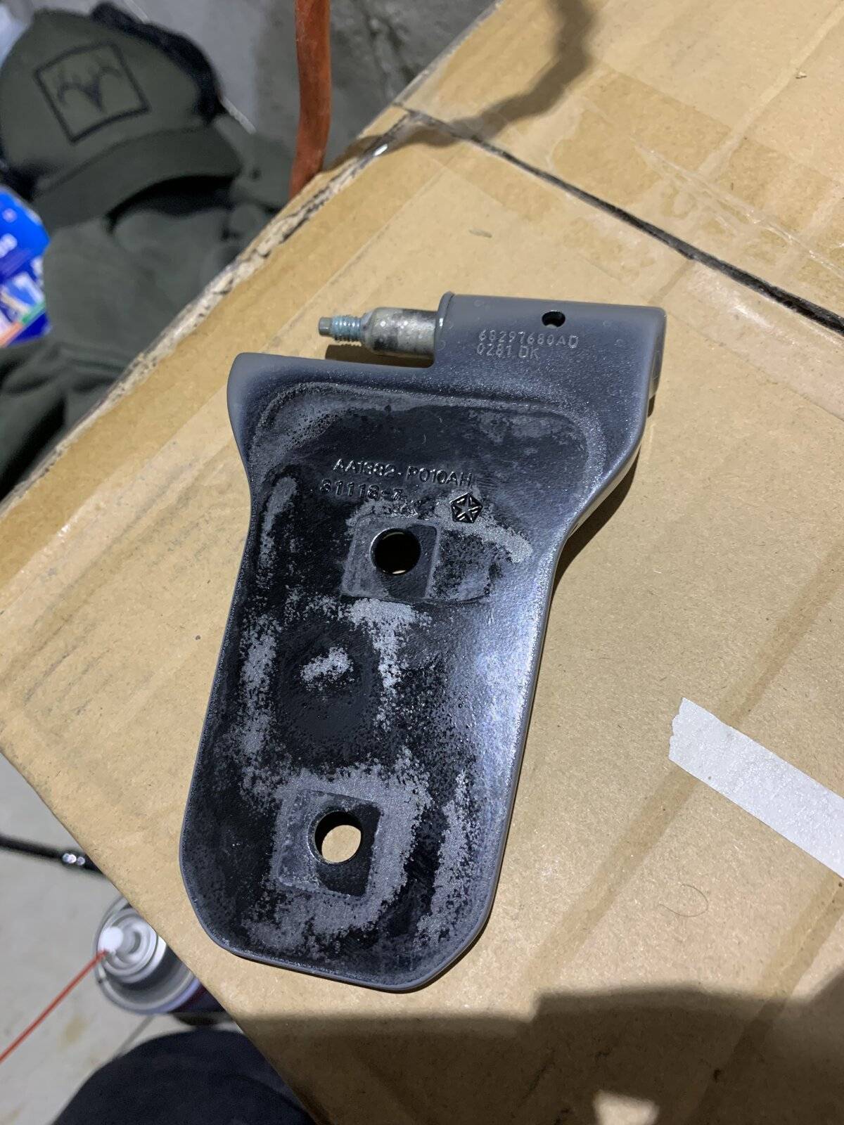

They look like this on the back
How thin of a piece of plastic film would be ample enough to protect against this in the future? Once i have mine done that is what i think ill do. Huge selection from McMaster-Carr. Any thoughts?
I’d say you could go as thin as you want, that way you’d be less likely to see a gap between the hinge and the door. I originally thought of doing this but I chose to treat the bare metal on the door and the bolts with fluid film instead. If you could get something that’s dielectric, it would be best since it would slow down any galvanic corrosion. I really feel that the steel bolts going into the aluminum hinge/door is what’s causing this.
