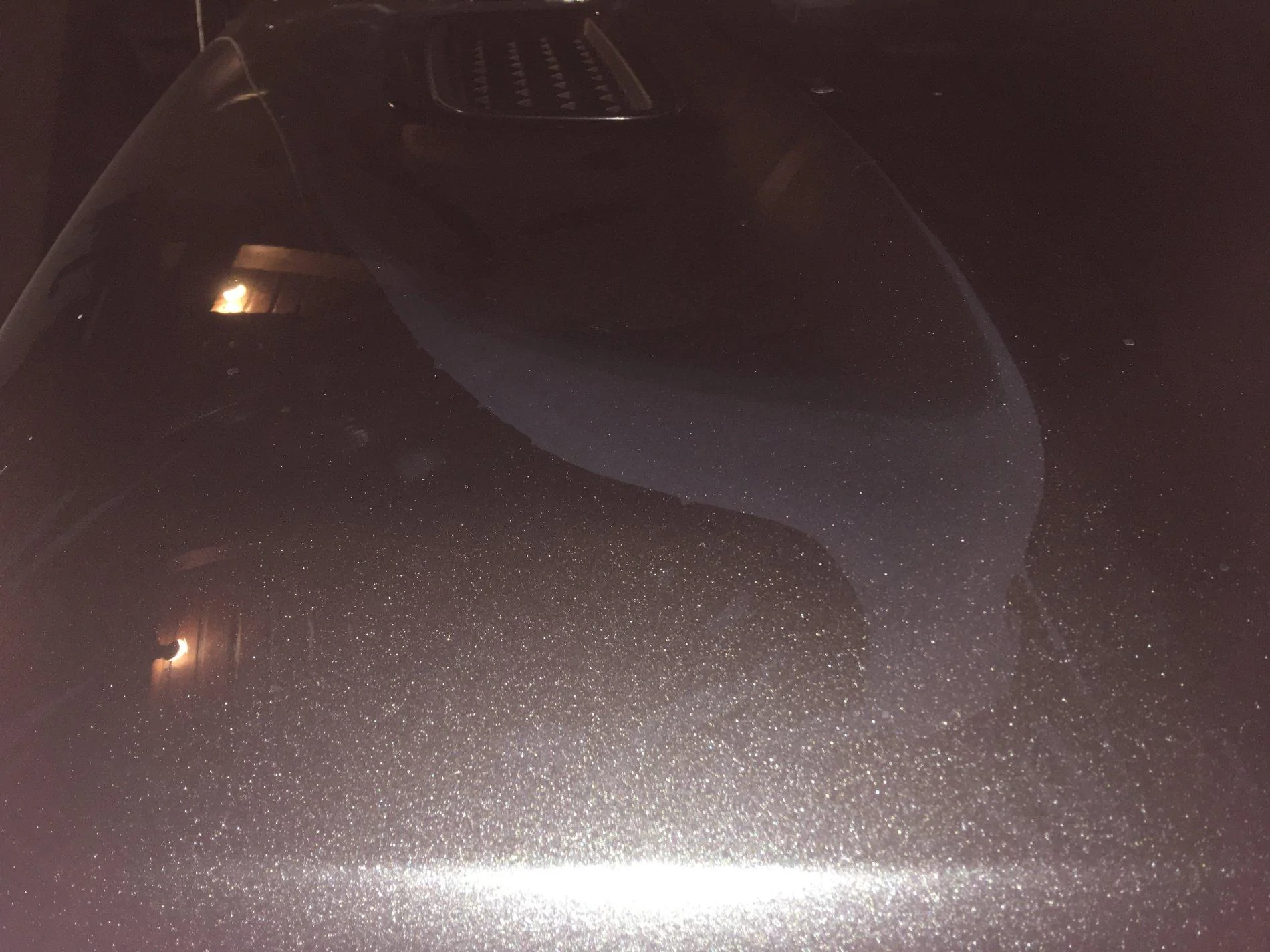

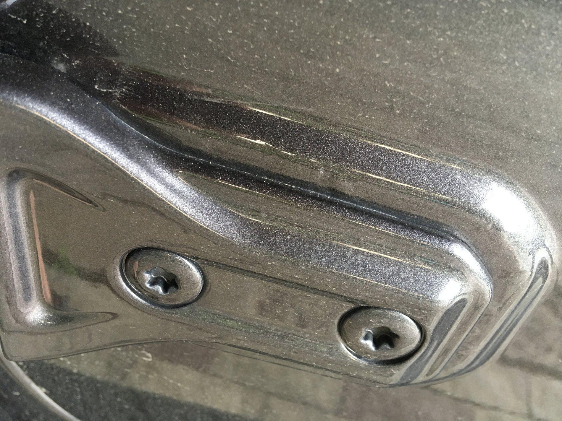

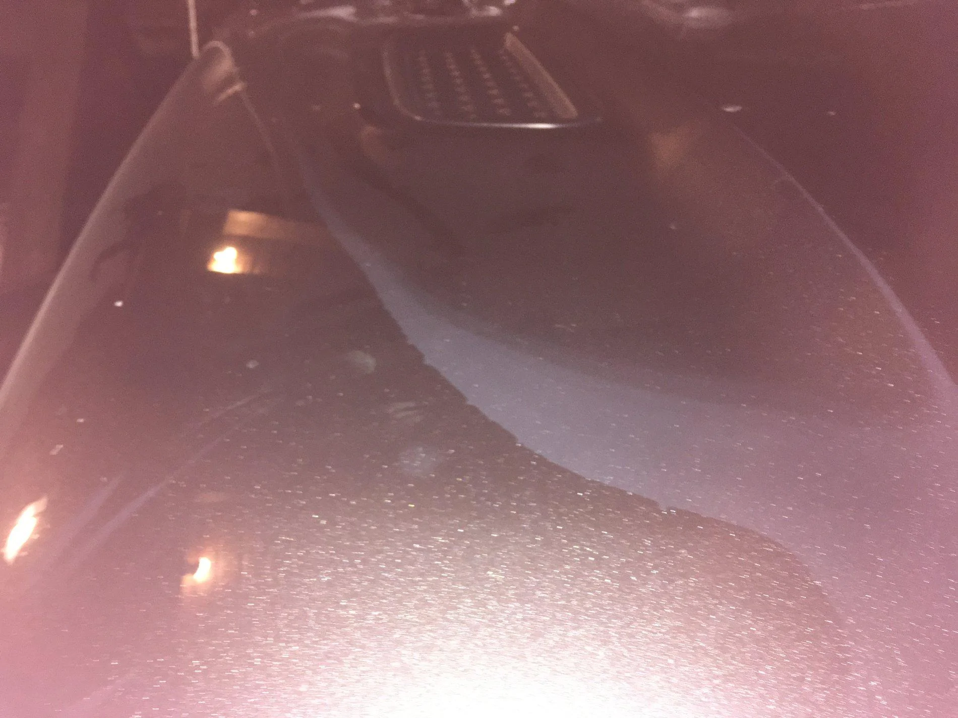

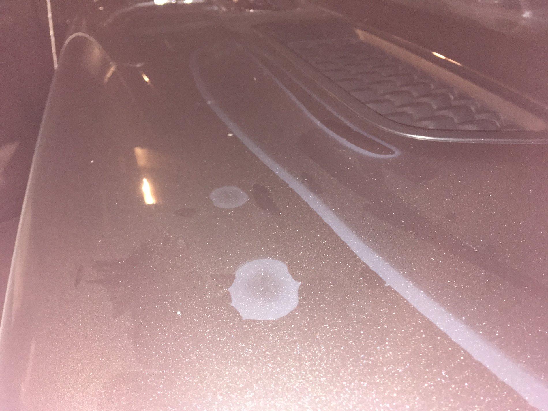

Moscow, 2018-2020. 40 000 km. 2 winters and Moscow road reagents. I noticed yesterday. Tomorrow I'm going to the dealer. And the hood is intact, since it was repainted with a slice after purchase. It was poorly painted. Over 40,000 replacement steering damper, all 4 shock absorbers and one speaker. SAHARA Model.

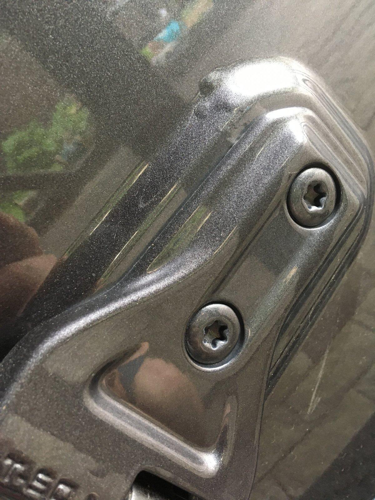

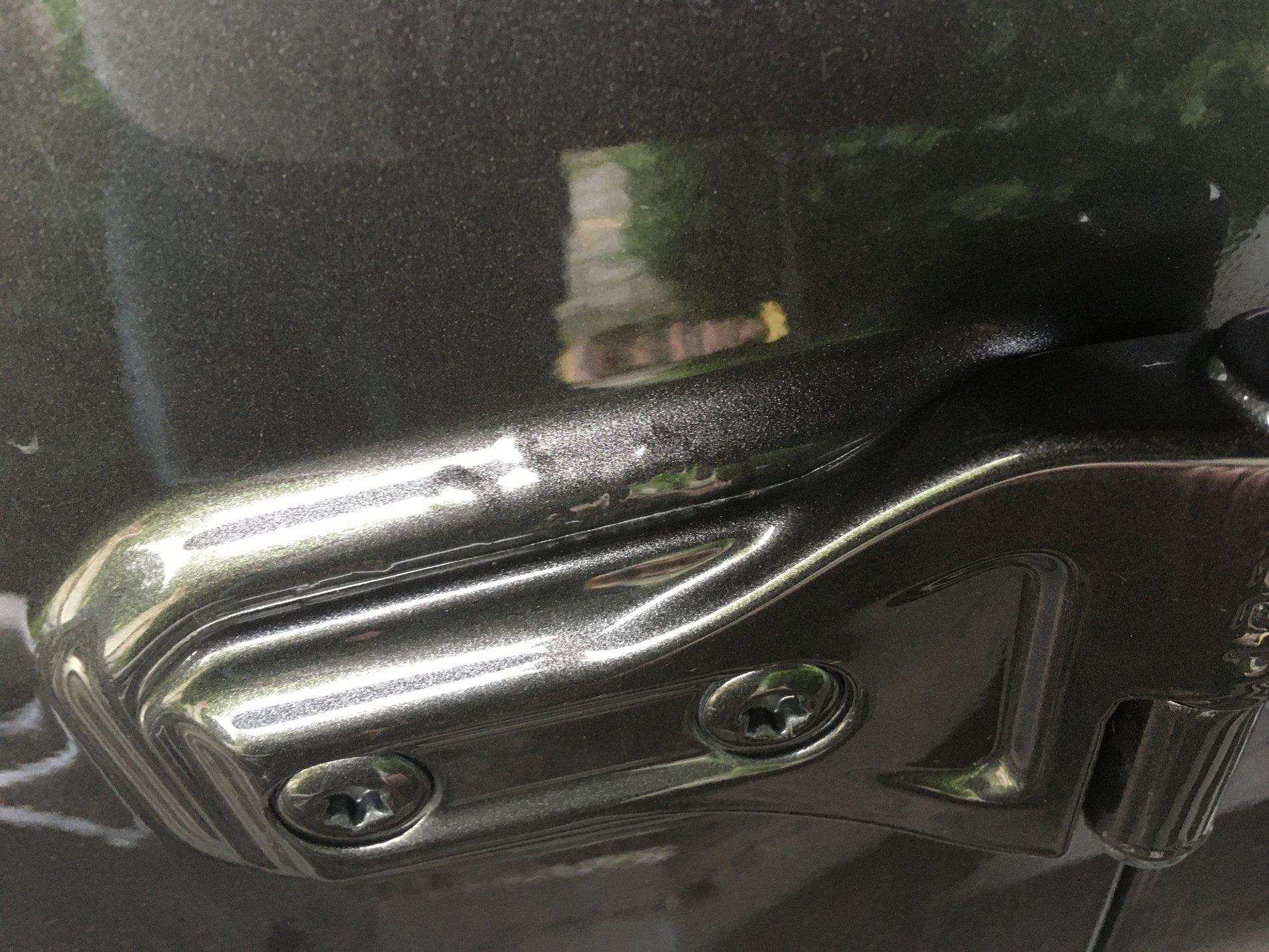

2018 JLU Sahara, all 4 doors getting repainted next week, bubbles on all the hinges and the bottom lip of drivers/passenger sides. No bubbling on the hood or trunk luckily. Covered under warranty, only 20k km's on it.
Worried this is just going to happen again. This is my 3rd jeep (2015 JKU, 2017JKU) and the first time I've had this issue. Might end up trading this in in a few years if its not resolved.
