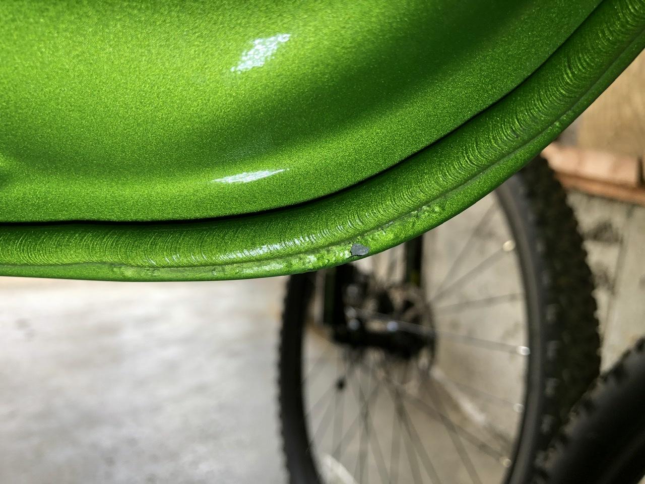

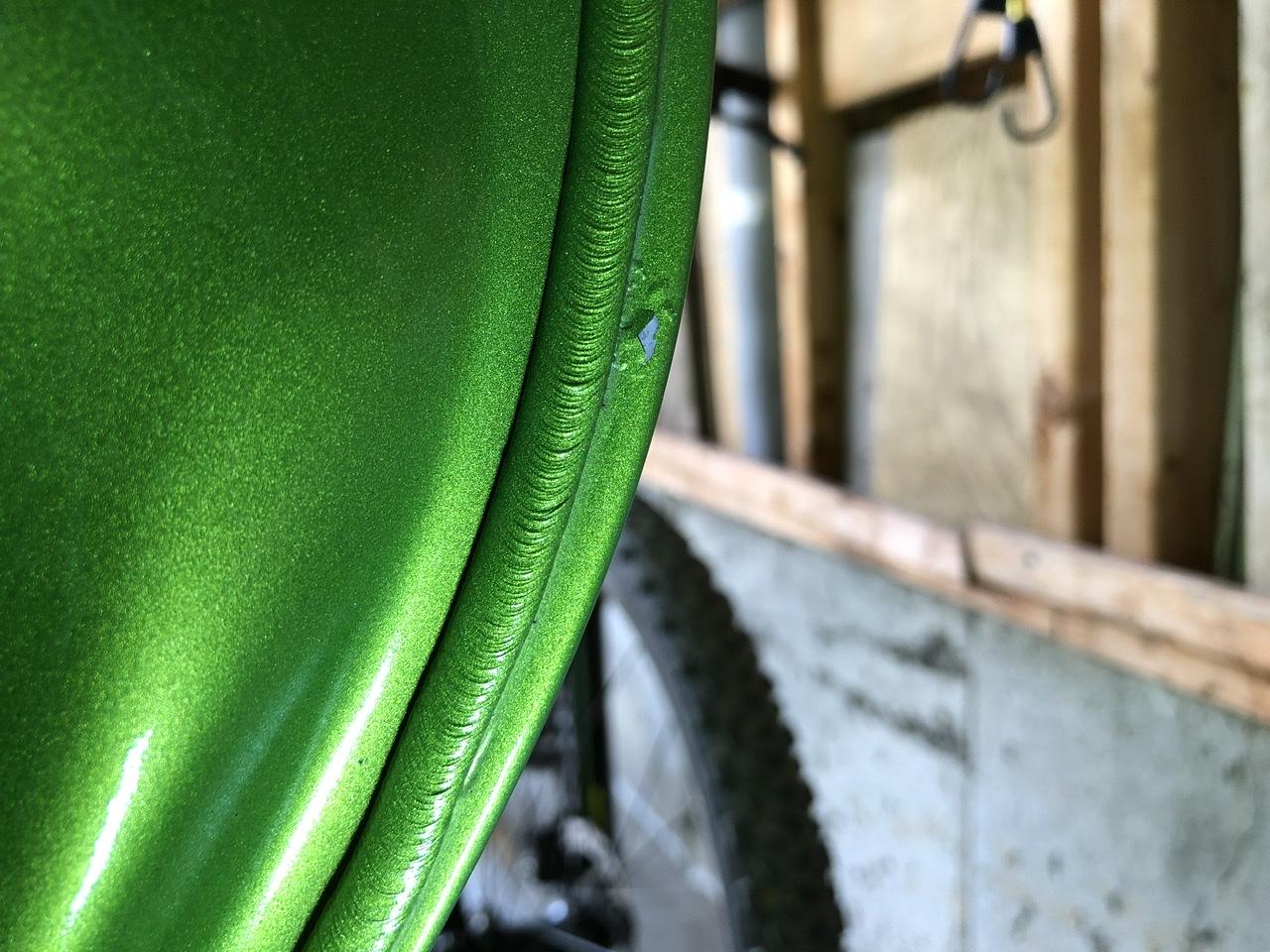

I had the bubbling paint on all door hinges and hood hinges within 8 months of new. Repaired under warranty. Now 6 months later tailgate hinges, 4 door hinges again and paint coming off on front passenger door seam. (Pics below). Body shop manager just shook his head and said that they had just finished fixing another one.
Colleague of mine at work got his JL about 6 months ago and I mentioned it to him. He looked at his and “presto” he has bubbling on door hinges and tailgate. He’s not happy.

If the body shop “fixed” the four door hinges before, why would they need to fix them again?
First fix was for bubbles on door panels coming up from under the hinges. This time bubbles were in different spots on the hinge plates themselves in areas that were not sanded to bare metal the last time. So far the areas that they fixed the first time have not bubbled again.
Problem is that it’s becoming a bit like a game of “Whack-a-mole” chasing the underlying corrosion around the panels when it pops up. I asked about replacing the door but shop manager told me he had to do a repair cost analysis for FCA prior to repair and FCA decided they had to fix not replace.

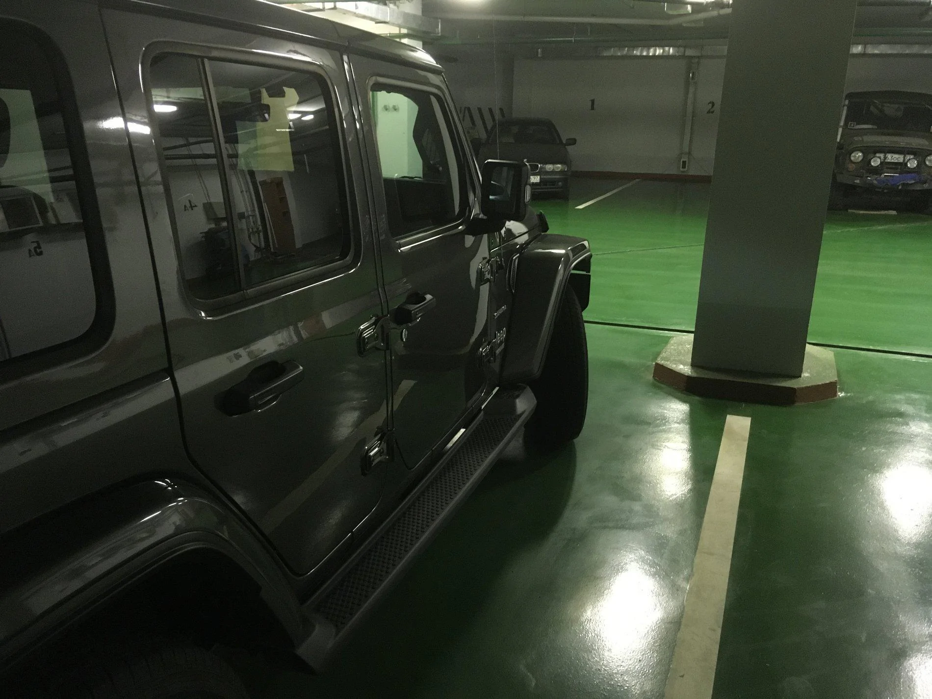

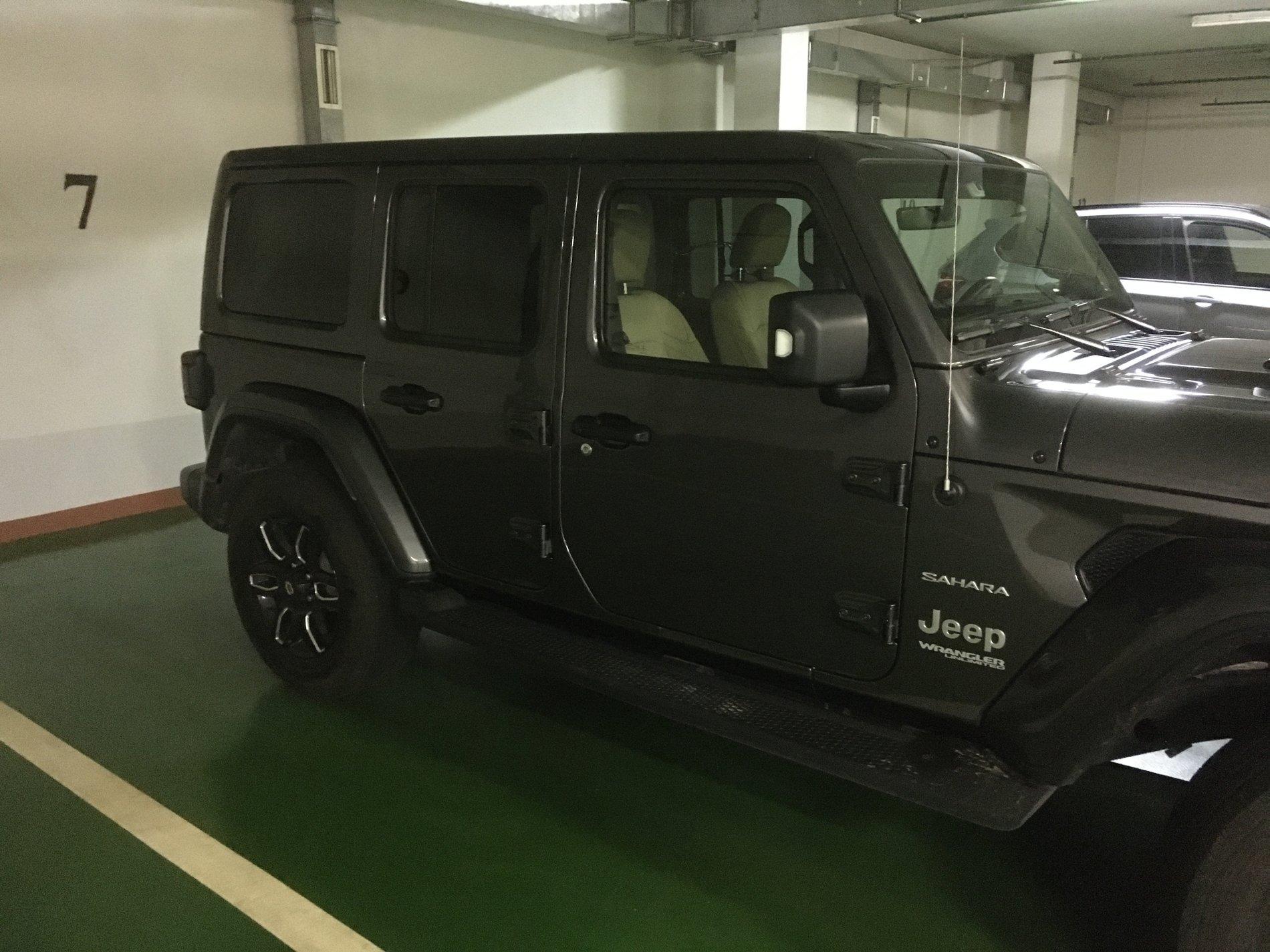

Диллер заменил меня на все 4 двери и покрасил их. Новые двери входят в коробки с петлями, прикрепленными к ним. Петли откручиваются, под них наносится грунт и краска. Затем устанавливается специальная пластиковая прокладка. Затем петля прикручивается к двери и красится все вместе. Смотрите фото. Ремонт пошел 2 недели.
I'm glad they got the corrosion issue corrected for you. It looks like they did a pretty thorough job, certainly better than my dealer.
Were the plastic hinge gaskets included with the new doors, or was it something that the repair shop did on their own?
