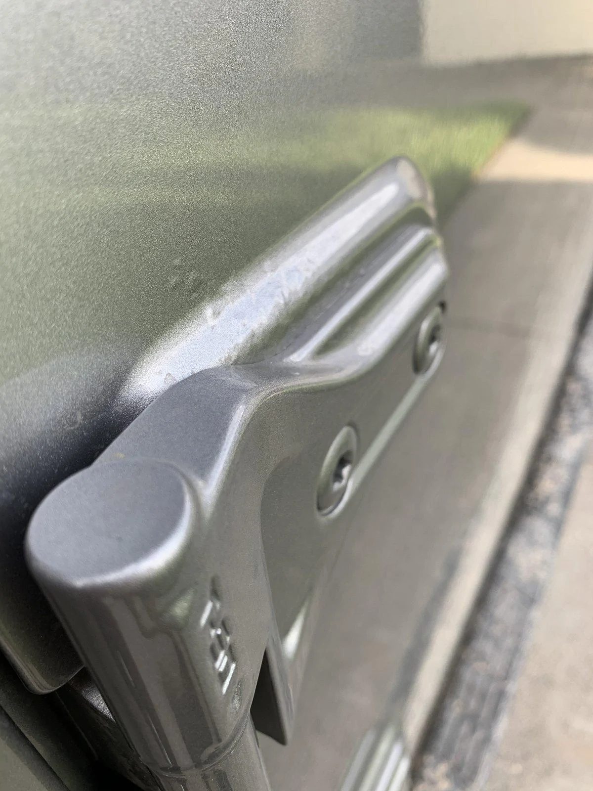

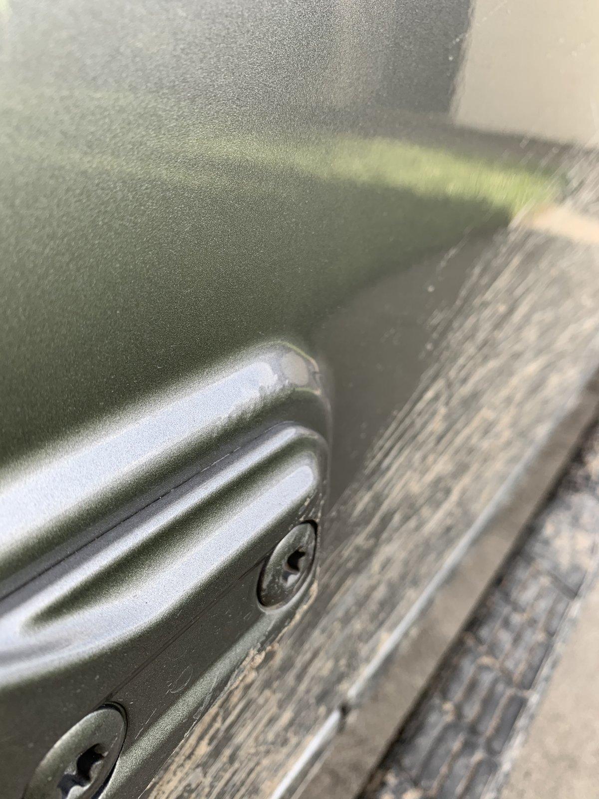

I have bubbling in mine at the same location as well. I’ll bring it to the dealer to see if warranty will cover it.
Jeep Wrangler JL Bubbles in Paint at Door Hinges 47573F1B-DA1E-4DF2-8070-2C6C08F9D3CB
Jeep Wrangler JL Bubbles in Paint at Door Hinges B087B469-651D-408A-847A-92410285B491

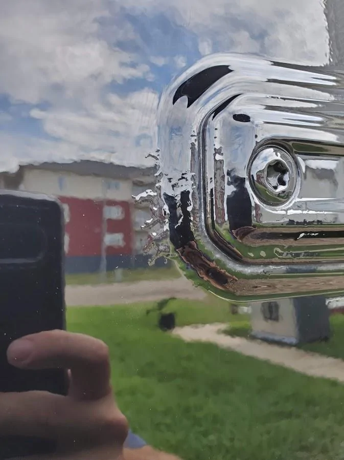

I brought mine in last week for bubbling on the door at the front driver and passenger. They also repaired a scratch on the driver front, back, and B pillar they put in the paint doing other work.
They called to say it was ready to pick up, and about fifteen minutes called saying I could still come to pick it up, but they’d need it in again. They chipped the paint hanging the doors again. I inspected the doors and noticed dirt under the paint, and chips on the hinges on the passenger side too.
I brought it in this morning to have them repair last weeks damage, which they did. When they called me to come pick it up, they told me they were ordering new hinges. They had spotted more paint bubbling on the front driver and passenger, and while we were looking at it out side, we discovered driver side read hinges starting to bubble.
They are going to replace all the door hinges and we are keeping an eye on the hood and tailgate.

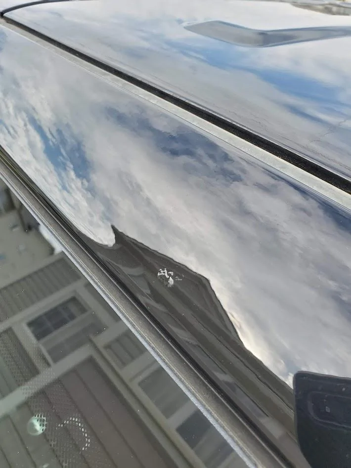

I notice the issue also right above the windows, have 2 like that.
Also notice my door are really bad........
dang thats pretty bad! i have some bubbles on all hinges but no where near that bad!
